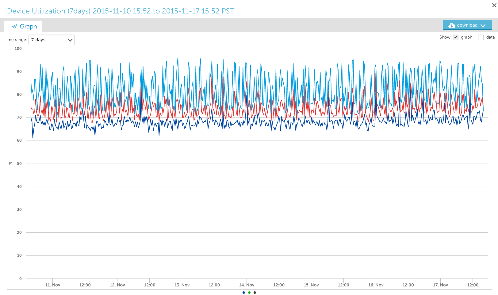

A few weeks ago it was my turn to be on-call. While hunting wild warnings in pursuit of a new record and a good nights sleep, I noticed that a couple of machines were flapping in and out of alert mode for SSD utilization:

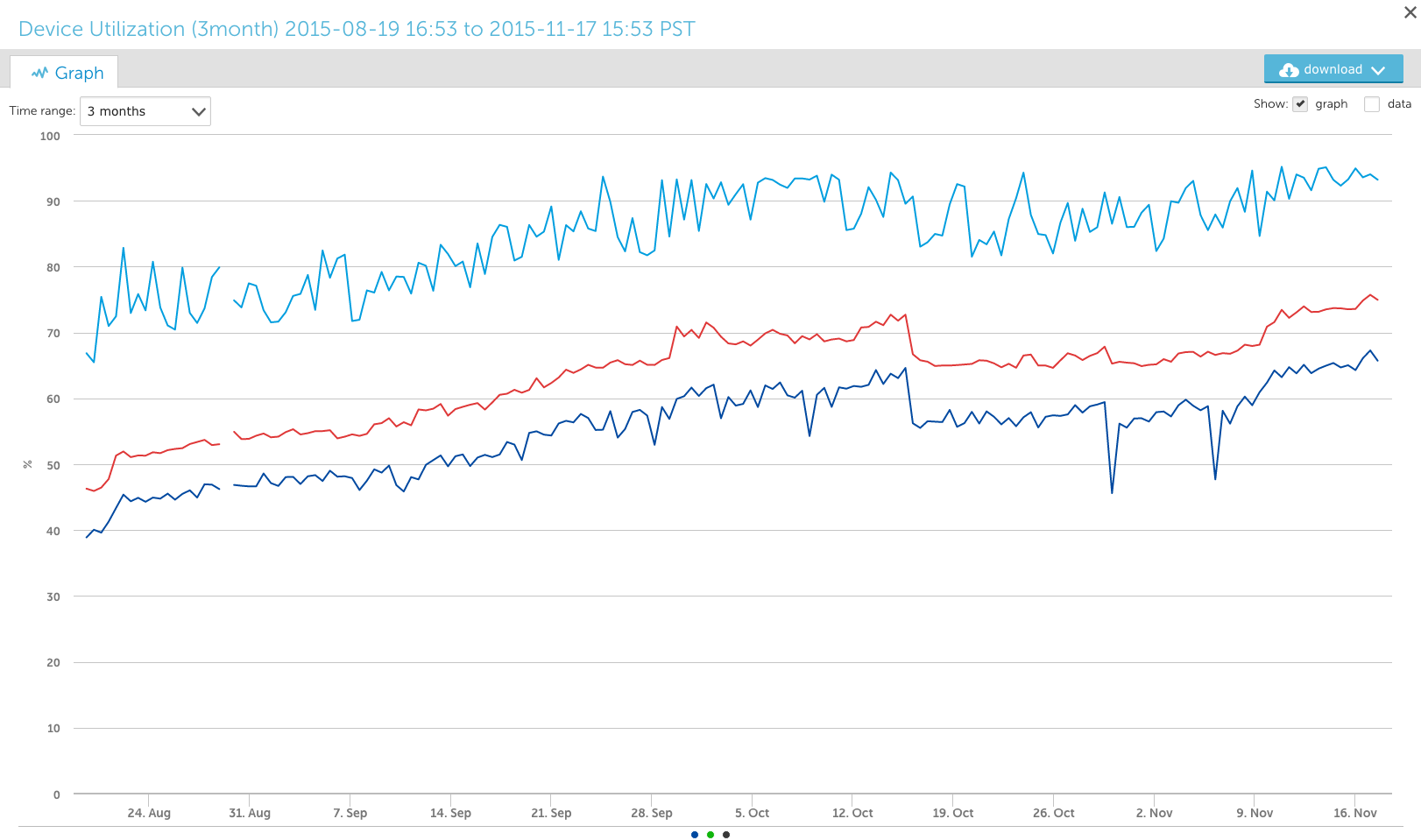

This seemed normal, but since this application is known to be IO bound, I did some additional investigation by looking at the trend over a longer time period:

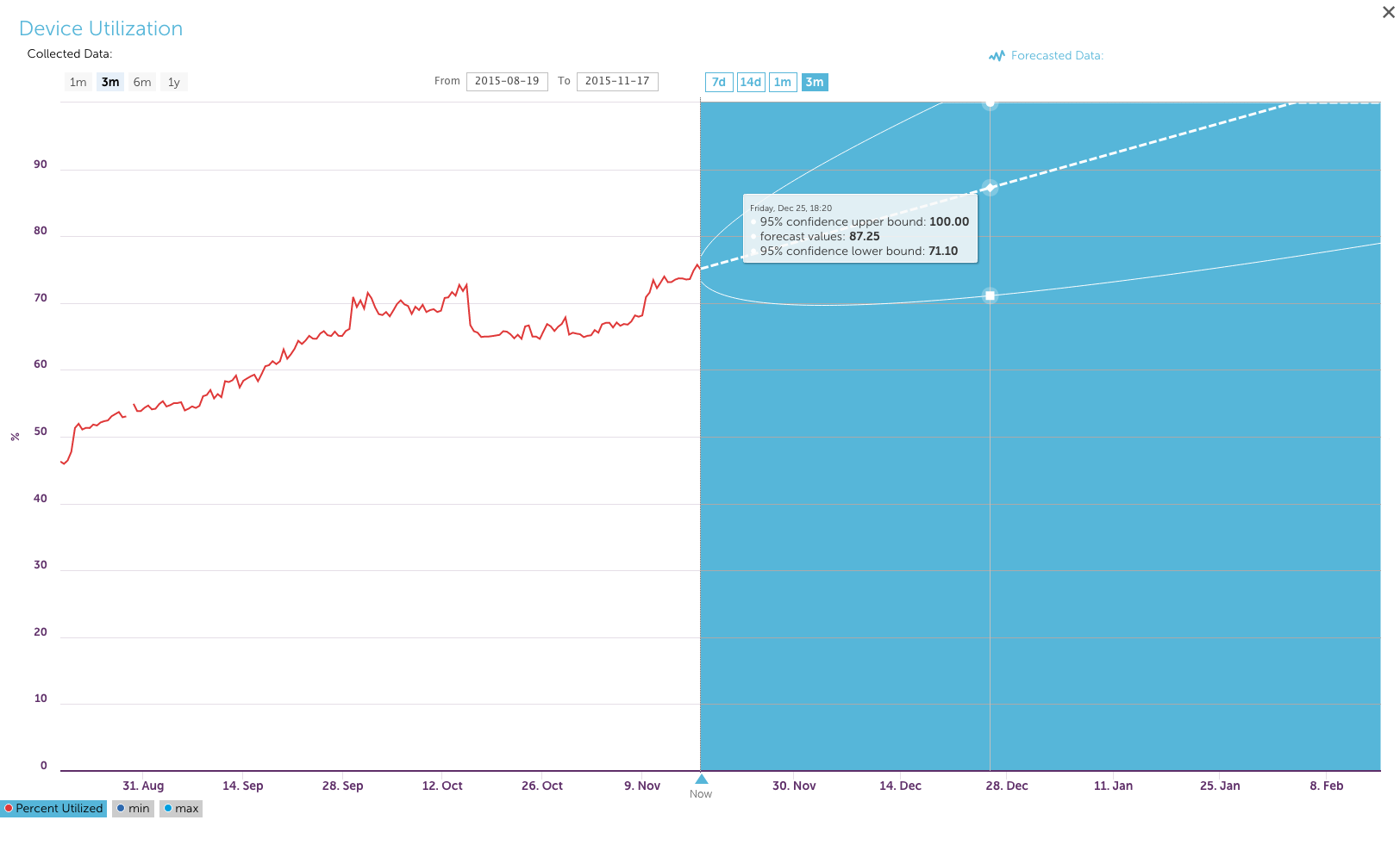

Over a longer time period, it started to look like it was increasing. So then I ran a forecast to see just how much time this system had until things break:
The forecast indicated that we didn’t have to worry about this breaking on Christmas day, as by that time Tech Ops would have been paged. On the upside, I now was able to schedule maintenance on this machine, which I knew would be completed before Christmas. I may not have broken the record for fewest number of active alerts, but at least I knew that whoever is on-call that week will sleep a little easier. As will I.
