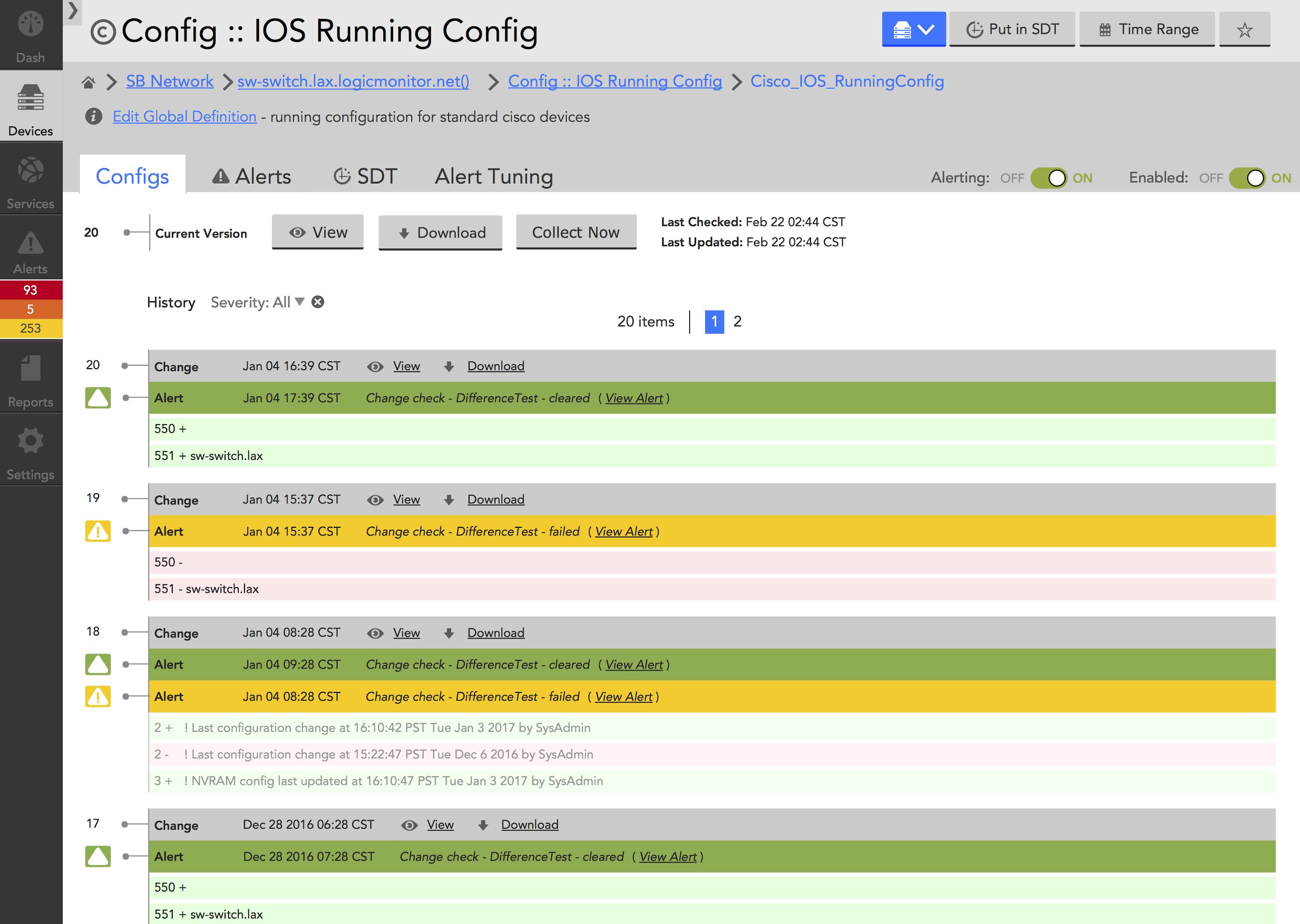

The other option would to be use the new LM Config feature. LM Config gives engineers the ability to monitor, manage, and alert on configuration files for any device. Although LM Config is primarily used for network device configurations (switches, load balancers, firewalls, etc), its functionality can easily be extended in scintillating fashion to collect all sorts of configurations....

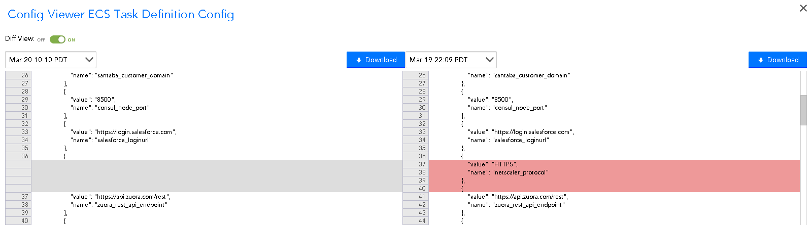

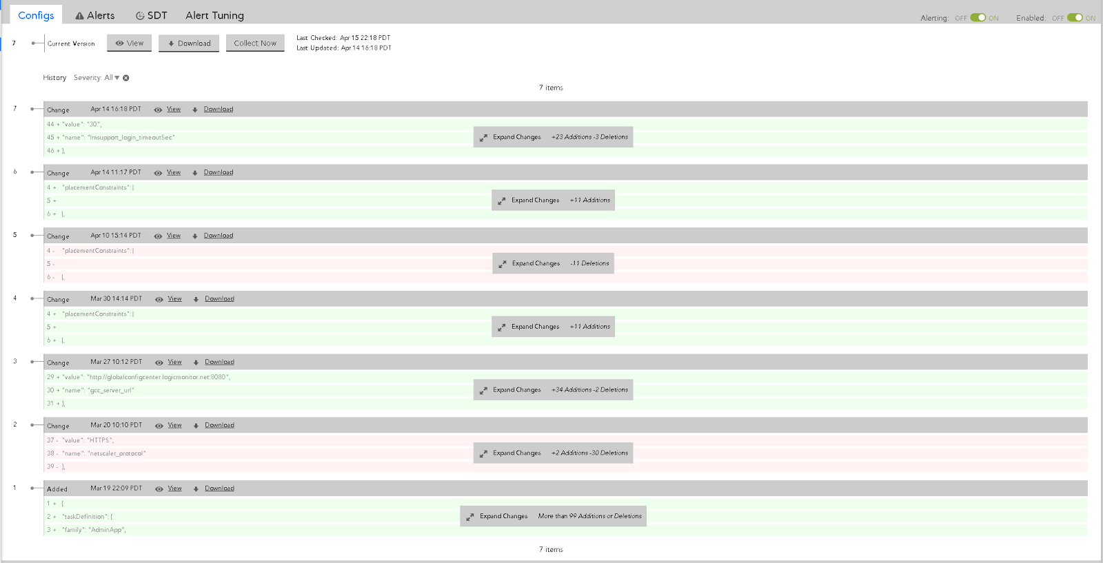

For data collection, I issue an API call to AWS that describes the task definition of a specified family:revision. This is returned in JSON. Currently, I only want to check when the latest task definition has been modified so the Active Discovery is grabbing the unique family name, but this could easily be adjusted to include specific/all revisions. From there, I set the ConfigSource to alert on any changes that occur on all task definitions. It also serves as a nice backup in case an old revision is accidentally deleted. There is a copy of the task definition in LogicMonitor. This is also a very easy way to identify changes created by Terraform or other cloud infrastructure automation tools.
ECS Configuration Monitoring
Using LM Config to monitor ECS task definition changes allows me to immediately identify changes to existing containers. I can quickly revert or fix problems that may arise from typos or issues in new containers. Reverting the task definition in this case allows me to get the troublesome container back up and running happily.
