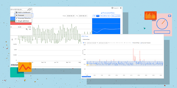

    • Dynamic Threshold will learn each units normal operating consumption and alerts when reading shows outside the benchmarked band (gray bar below) even when consumption within the rPDU’s capability
LogicMonitor Dynamic Thresholds showing alertable thresholds.

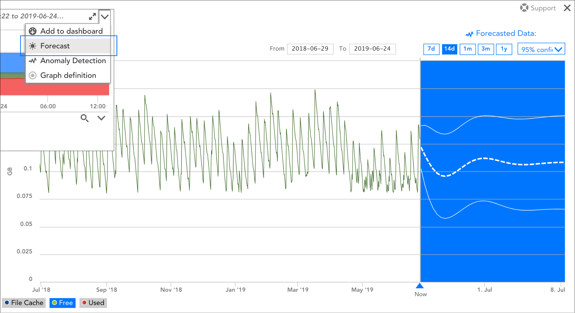

  • Forecasting will provide early visibility to a potential risk of reaching the ceiling of the rPDU capacity
Forecasting dashboard in LogicMonitor
