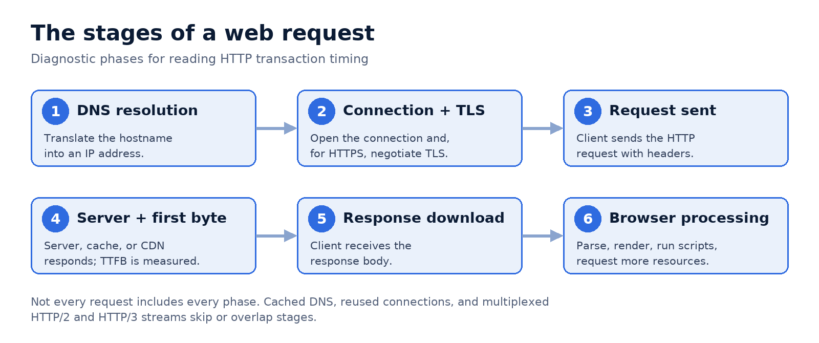

The stages of an HTTP transaction
An end-to-end web request may include these stages. Not every request incurs every phase: cached DNS, reused connections, and multiplexed HTTP/2 and HTTP/3 streams skip or overlap some of them. Naming the stages still gives you a checklist to work through when a page is slow.
- DNS resolution: the client translates a hostname like shop.example.com into an IP address.
- Connection and security setup: the client opens a connection to that IP address, and for HTTPS it negotiates encryption through TLS.
- Request sent: the browser sends the HTTP request, such as GET /checkout, with headers describing what it wants.
- Server processing and first byte: the server, cache, or CDN builds a response, and time to first byte (TTFB) marks the first byte back.
- Response download: the client receives the response body, such as the HTML for the checkout page.
- Browser processing and dependent requests: the browser parses HTML, runs scripts, renders, and requests more resources like images, fonts, and APIs.
A slow product page might spend 10 milliseconds on DNS, 2 seconds waiting for the server, and another second downloading oversized images. Three stages point to three owners: the DNS provider, the application team, and whoever manages image compression.
The value of the sequence is that it turns one vague complaint into measurable pieces. A team that reports timing per stage can compare a healthy request against a slow one and see which phase grew. That comparison is usually faster than reading application logs blind.
The stages of a modern web request. These are diagnostic phases, not an identical packet-by-packet sequence for every HTTP version or tool.
Treat these six stages as diagnostic phases, not an identical packet-by-packet sequence for each HTTP version or monitoring tool. HTTP/2 and HTTP/3 reorder and overlap much of this work, but the stages still give your team shared language for finding delay.
