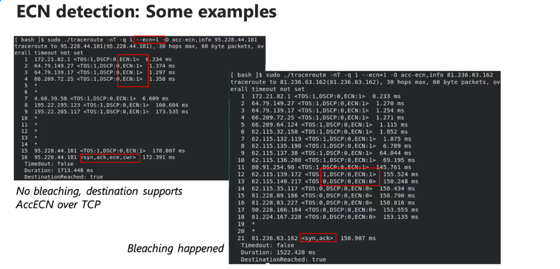

ECN bleaching happens when a device along the path clears those markings before they arrive. If bleaching occurs at any point between client and server, the endpoints never see the congestion signal, and L4S becomes unusable. A single bleaching hop anywhere in the path is enough to break it.
ECN and L4S need support from the client and server, but also from every device in between. A single device that clears the ECN bits can prevent the endpoints from receiving the congestion feedback L4S depends on.
Example of ECN bleaching (identified by Catchpoint)

The findings come from a global measurement campaign that Catchpoint ran across its global monitoring network. Using Pietrasanta Traceroute, an enhanced traceroute tool, the team ran more than 330,000 traceroutes from over 500 nodes in more than 80 countries. The dataset was last updated May 3, 2024, and was originally prepared for RIPE 88. The campaign tested pairs of nodes in the same region, though not always the same country, and each result logged where congestion markings survived and where a device cleared them.

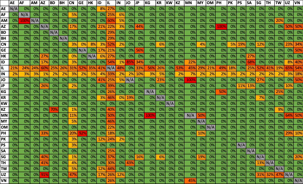

The charts below break the results down by region, showing how often ECN bleaching appeared on paths within each one. Reading them side by side shows where L4S has room to run today and where bleaching still stands in the way.

Rates in Europe
ECN bleaching percentage across observed paths in Europe during the May 2024 campaign.
