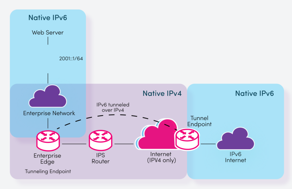

How does IPv6 tunnelling help achieve this coexistence? Imagine you have an enterprise network for which you have purchased a range of public IPv6 addresses. You use those IP addresses for the internal hosts of your network, both user devices and network services. However, the physical location of your enterprise does not have any ISPs that offer IPv6 infrastructure: The Internet in your area only supports IPv4. What do you do?
You implement IPv6 tunnelling, as shown in the diagram. In the above scenario, the enterprise edge router is one IPv6 tunnelling endpoint, where IPv6 packets are encapsulated into IPv4 packets, sent over the IPv4-only Internet, and received by another router that acts as the other endpoint of the tunnel. Once they reach that endpoint, the packets are decapsulated and sent on their way within the IPv6 infrastructure.
Routers that play the role of tunnelling endpoints are also called dual-stack routers because they support both the IPv4 and IPv6 protocol stacks.

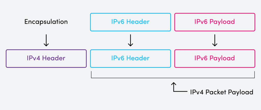

IPv6 Encapsulation into IPv4
An IPv6 packet is composed of a header and a payload. The header contains the source and destination IPv6 addresses as well as additional information that pertains to security, routing, quality of service, and other features specific to IPv6. When such a packet reaches a dual-stack router for encapsulation, an IPv4 header is added to the IPv6 packet. The IPv6 packet essentially becomes the payload of the IPv4 packet. The following diagram depicts this encapsulation:
The IPv4 header contains the source and destination IPv4 addresses that correspond to the two tunnelling endpoints, while the IPv6 header contains the source and destination IPv6 addresses of the actual hosts communicating with each other.

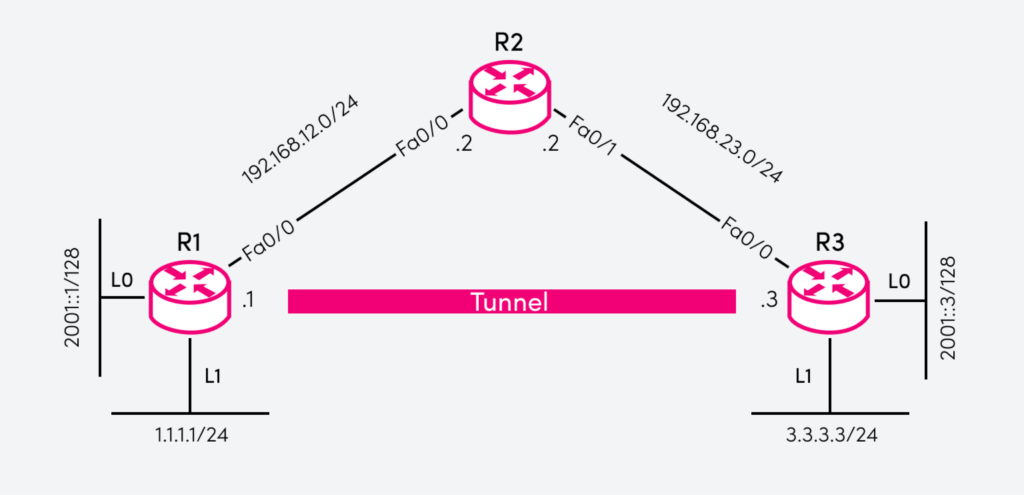

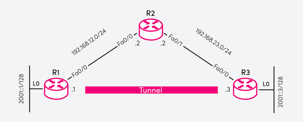

For our first configuration, let’s consider the following network topology:
R1 and R3 are our dual-stack routers that have IPv6 addresses on their L0 loopback interfaces. R1 and R3 are also connected to an IPv4 infrastructure via R2. We want to create a manual 6in4 IPv6 tunnel so that the loopbacks can communicate with each other. R1 and R3 also have L1 loopback interfaces that will be used to terminate the tunnel.
Assume the above IPv4 and IPv6 addressing has already been configured in all routers and that routing between all IPv4 addresses has been established using a dynamic routing protocol such as EIGRP.
Let’s start by creating the tunnel on R1 and R3 that terminates on the L1 interfaces:

Our tunnel is now complete, but our IPv6 loopbacks cannot yet communicate. We must configure IPv6 routing, so they can reach each other over the tunnel infrastructure. To do so, let’s enable the routing protocol RIPng on R1 and R3. Here’s the config for these routers:

Automatic 6to4 tunnelling configuration
For this configuration, we’ll use the same topology as before, but this time we won’t be using loopbacks to terminate the IPv4 tunnel:
Once again, we assume that IPv4 routing has been established between all routers.
The advantage of this method is that when creating the tunnel, we don’t need to know the tunnel destination on R1 or R3; it is created dynamically from the IPv6 address you will use. Here’s the configuration of the tunnel interfaces on R1 and R3:

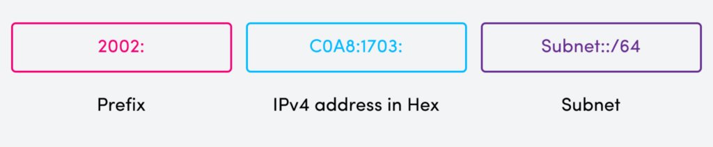

R3(config-if)#tunnel mode ipv6ip 6to4Here we’re using IPv6 addresses on the tunnels, but we’re not specifying the destination, which is inferred from the IPv6 address used. How is this done? All 6to4 addresses have the following format:
The prefix is always 2002: and is reserved on the Internet for use with 6to4 IPv6 tunnelling. The next 32 bits in hexadecimal are equivalent to the IPv4 address. If you check it out, you will see that the C0A8:1703 in hexadecimal is equivalent to 192.168.23.3. Similarly, C0A8:C01 is equivalent to 192.168.12.1.
Another key thing to note here is the tunnel mode being used. It’s ipv6ip with the 6to4 keyword, which tells the router to determine the tunnel endpoint IPv4 address from the IPv6 address.

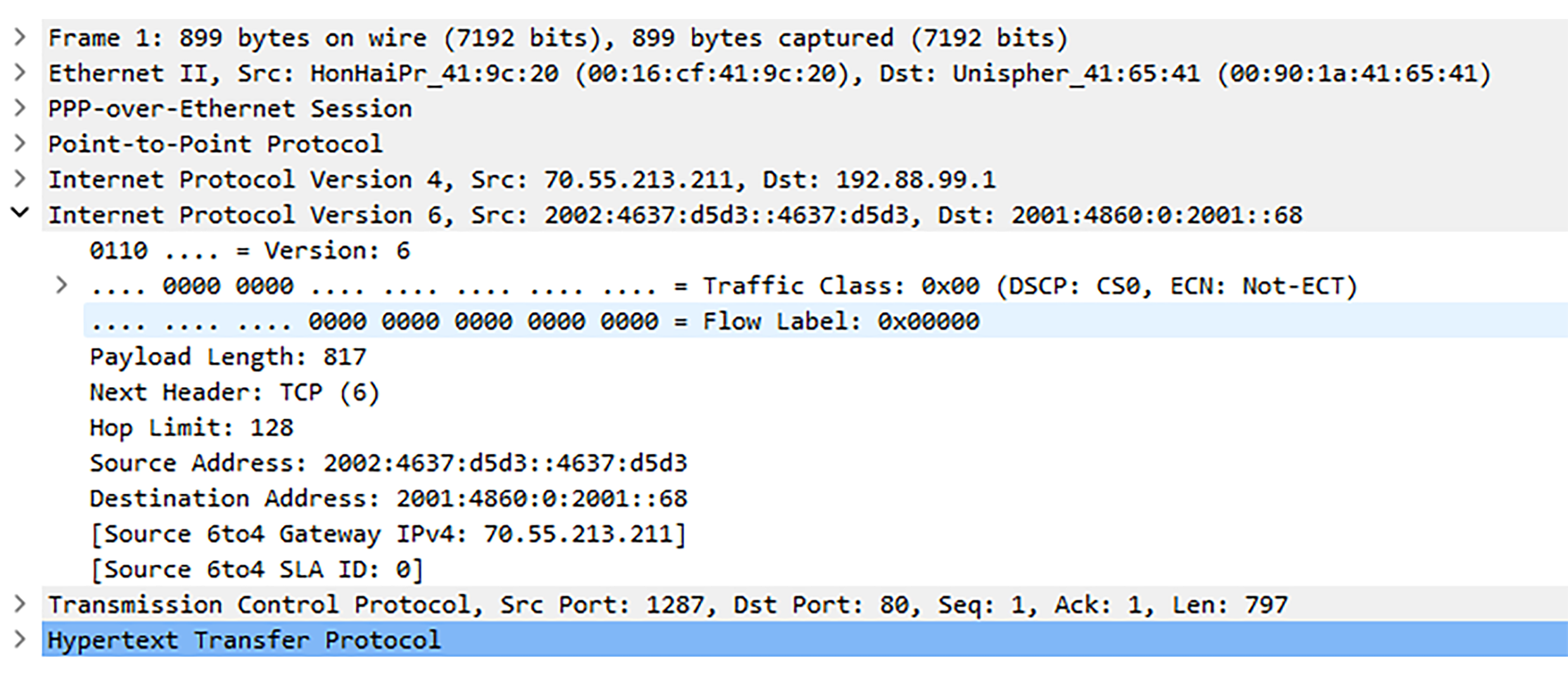

Success rate is 100 percent (5/5), round-trip min/avg/max = 8/8/8 msWireshark capture
So what does IPv6 tunnelling look like? Well, take a look at this Wireshark capture of an IPv6 packet tunnelled within an IPv4 packet. The addresses are different from the above examples, but it clarifies the concept quite well.
Notice the 6to4 gateway information found within the IPv6 header. You can further explore this particular pcap capture file using your own Wireshark application to gain more insight into the operation of this feature.
