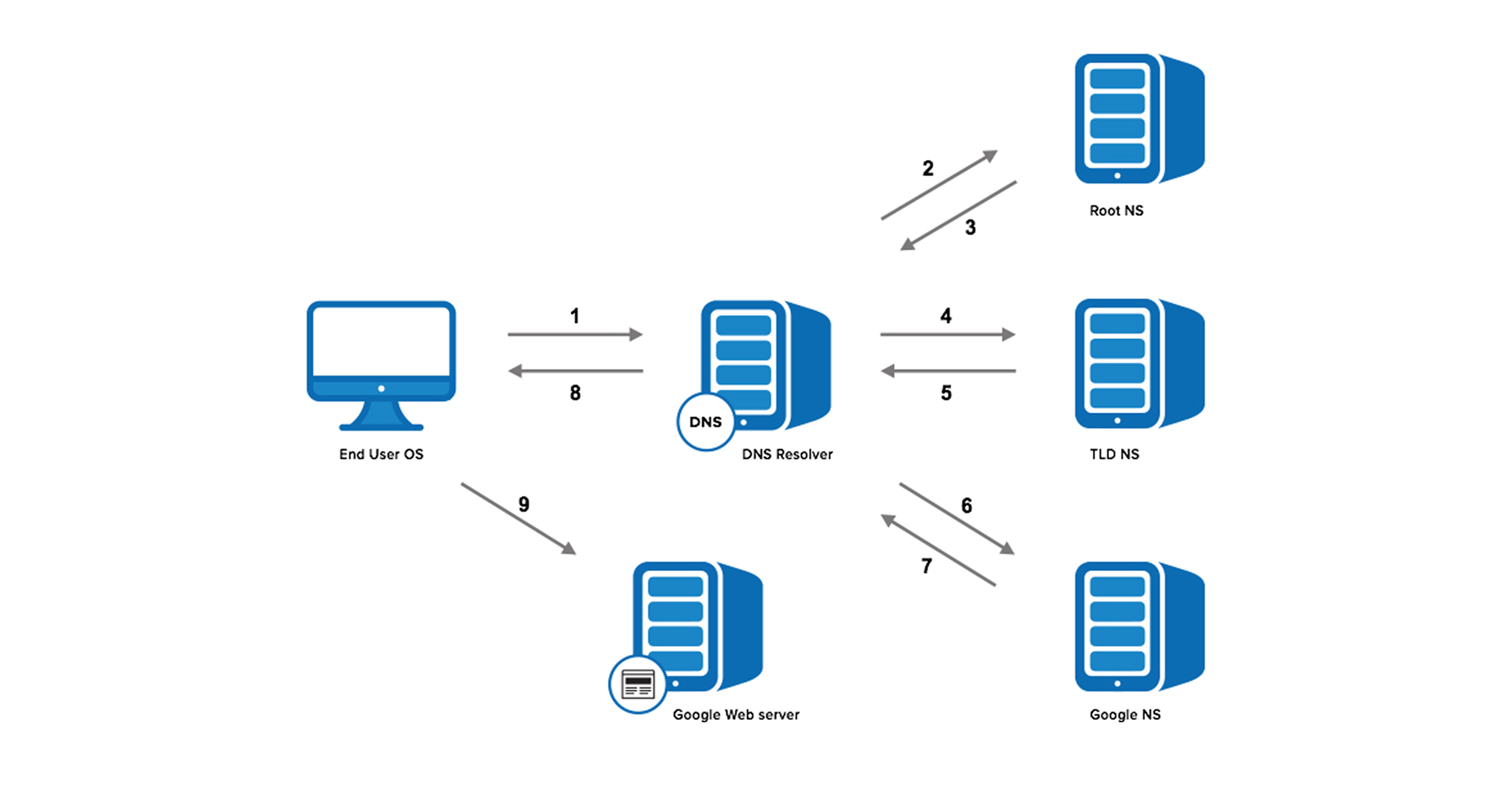

The DNS lookup process, step by step
Step 1: The OS sends a recursive query to a DNS resolver
The operating system doesn’t know where www.google.com is, so it queries a DNS resolver. The query carries a special flag marking it a recursive query. That flag means the resolver has to finish the recursion and return either an IP address or an error.
For most users, the resolver comes from their Internet Service Provider (ISP). Others use an open alternative such as Google DNS (8.8.8.8) or OpenDNS (208.67.222.222).
You can view or change it in your network or router settings. From here, the resolver runs recursion to turn the domain name into an IP address.
Step 2: The resolver sends an iterative query to a root server
The resolver starts by asking one of the root DNS servers for the IP of www.google.com. This query has no recursive flag, so it’s an iterative query. Its response must be an address, the location of an authoritative name server, or an error.
The root is represented by the hidden trailing dot at the end of a domain name. You don’t type it, because the browser adds it automatically.
The DNS root is served by 13 named root-server authorities, A through M, operated by 12 independent organizations and backed by more than 2,000 operational server instances worldwide. These instances serve the same authoritative root-zone data.
Step 3: The root server responds with the TLD servers
These root servers hold the locations of all of the top level domains (TLDs), such as .com, .de, .io, and newer generic TLDs like .camera. The root doesn’t have the IP for www.google.com, but it knows .com might. So it returns the location of the .com servers, sent as a list of the 13 .com gTLD name server (NS) records.
Step 4: The resolver queries a TLD name server
Next, the resolver queries one of the .com name servers for the location of google.com. Like the root servers, each TLD has 4 to 13 clustered name servers in many locations.
TLDs come in two types.
TLDs include country-code TLDs (ccTLDs), such as .uk or .de, and generic TLDs (gTLDs), such as .com. Each TLD has a designated registry operator responsible for its authoritative DNS infrastructure.
For this example, the resolver queries the .com registry infrastructure, operated by Verisign..
Step 5: The TLD server responds with the domain’s name servers
Each TLD server holds a list of all the authoritative name servers for every domain in that TLD. For example, each of the 13 .com gTLD servers lists the name servers for .com domains.
The .com gTLD server doesn’t have the IP for google.com, but it knows where google.com’s name servers are. It responds with all of google.com’s NS records. In this case Google has four name servers, ns1.google.com through ns4.google.com.
Step 6: The resolver queries the domain’s authoritative name server
Finally, the resolver queries one of Google’s name servers for the IP of www.google.com.
Step 7: The authoritative name server returns the IP address
This time the name server knows the IP. It responds with an A or AAAA address record, for IPv4 and IPv6 respectively, depending on the query type.
Step 8: The resolver returns the IP address to the OS
The resolver has now finished the recursion. It can return an IP address to the end user’s operating system.
Step 9: The browser starts the TCP handshake
The operating system now has www.google.com’s IP address. It hands the IP to the application, the browser, which opens the TCP connection and starts loading the page. For more on that process, see our blog post on the anatomy of HTTP.
