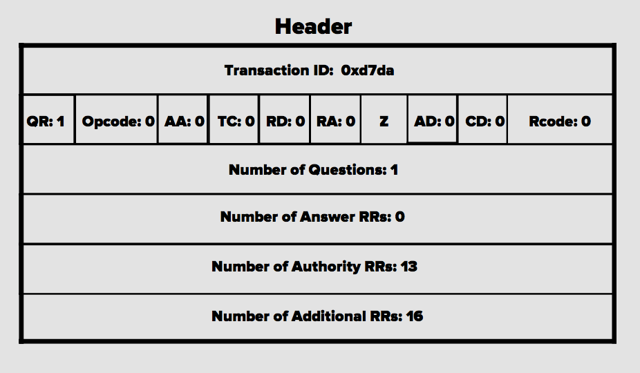

Reading a DNS Packet
Every DNS message, query or response, is built from the same sections.
Here’s what each one tells you.
Header
The header is a fixed 12-byte block at the start of every message.
It carries a transaction ID (used to match a response to its query) and a set of flags that tell you what kind of message you’re looking at: whether it’s a query or a response (QR), whether the answer came from an authoritative server (AA), whether the query wants a full recursive lookup (RD) or just a referral, and a return code (Rcode) that’s 0 for success or 3 if the domain doesn’t exist.
The remaining header fields simply count how many questions and records follow.
