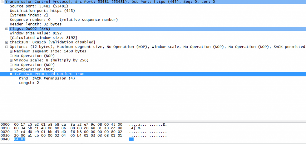

The SACK-Permitted option
SACK support is negotiated during the TCP handshake. Each side advertises it by including the SACK-Permitted option in its SYN segment. In a Wireshark capture, this option appears as Kind 4, Length 2, and it carries no payload of its own.

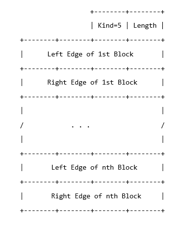

Once both sides agree to use SACK, the receiver sends the SACK option inside its ACK segments. Each SACK block is defined by two 32-bit values.
The left edge marks the first byte of the received block, and the right edge marks the first byte just past it. A single ACK can carry several blocks to report multiple non-contiguous ranges at once.

A packet capture makes the SACK options concrete. During connection setup, Wireshark shows the SACK-Permitted option as Kind 4, Length 2, confirming that both ends will use SACK.

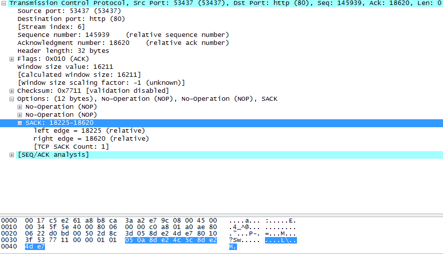

Later in the connection, an ACK carries a SACK block with a left edge of 18225 and a right edge of 18620. That block reports to the sender that the receiver already holds bytes 18225 through 18619, while an earlier segment is still outstanding.
