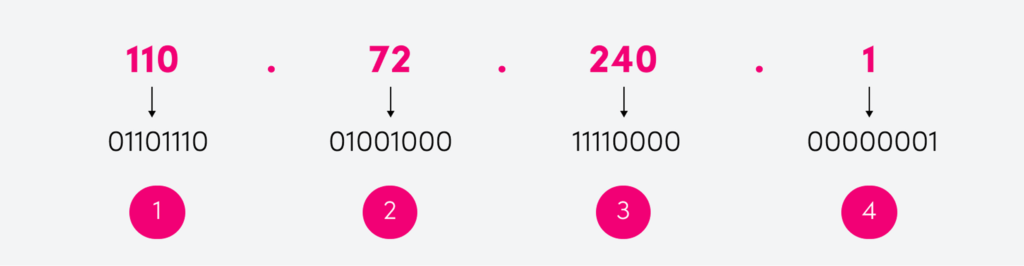

    If you are reading this article, you are undoubtedly already familiar with IPv4 addresses. They are usually shown in what is called dotted decimal notation: four bytes, each expressed as a decimal (base-10) number and separated by periods, as shown below:
    Mapping of a 32-bit IPv4 address into dotted decimal notation

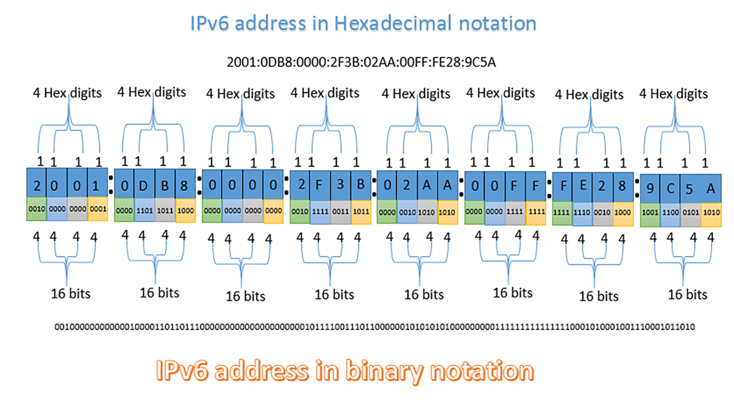

    The initial step to solving the problem with IPv6 addresses was to go away from decimal numbers and use hexadecimal (hex) notation. In hex, each set of four bits, which has a value of 0 to 15, is replaced by one base-16 digit, with the letters “A” through “F” acting as single-digit stand-ins for 10 to 15. (The letters can be upper or lower case; this is just a matter of style.)
    Hex numbers can be confusing for “normal people,” but techies are used to dealing with them. They also have the advantage that each hex digit is exactly equivalent to four bits, so each byte of eight bits is always two hex digits.
    Hexadecimal notation is often encountered when working with MAC addresses, the hardware addresses assigned to network devices. These addresses are 48 bits long and are usually expressed as six groups of two hex digits separated by hyphens, like this:

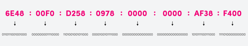

    This same method was adapted for IPv6 addresses to make them more uniform. IPv6 addresses are much longer than MAC addresses, so instead of 8-bit bytes with separators, they are grouped into 16-bit words. These are separated by colons, which have the advantage of taking up less space than hyphens (at least in proportional fonts). This is sometimes called colon hexadecimal (or colon hex) notation.
    Using this method, the example made-up IPv6 address above is expressed as:
    Mapping of a (made up) 128-bit IPv6 address into colon hexadecimal notation
