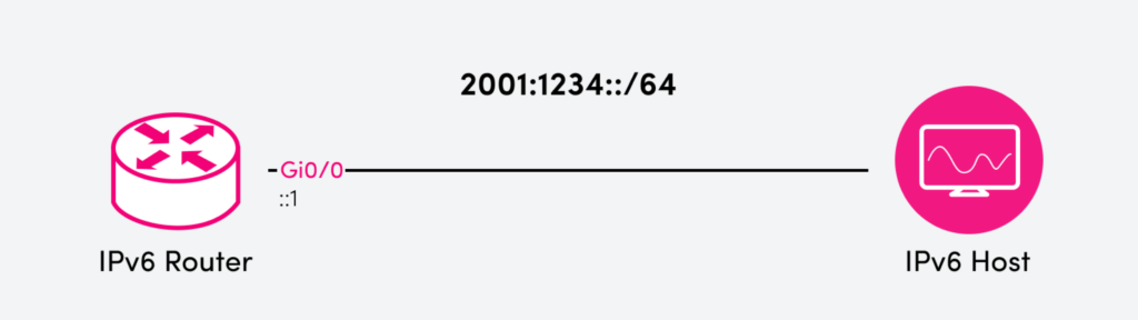

    Let’s go through the steps of how an IPv6 host obtains IPv6 network parameters via SLAAC. We’ll be using the following topology with the indicated IPv6 address space:
    Network topology of an IPv6 host connected to an IPv6 router
    Note that the address space being used is for demonstration purposes. You can use any valid global unicast address space.

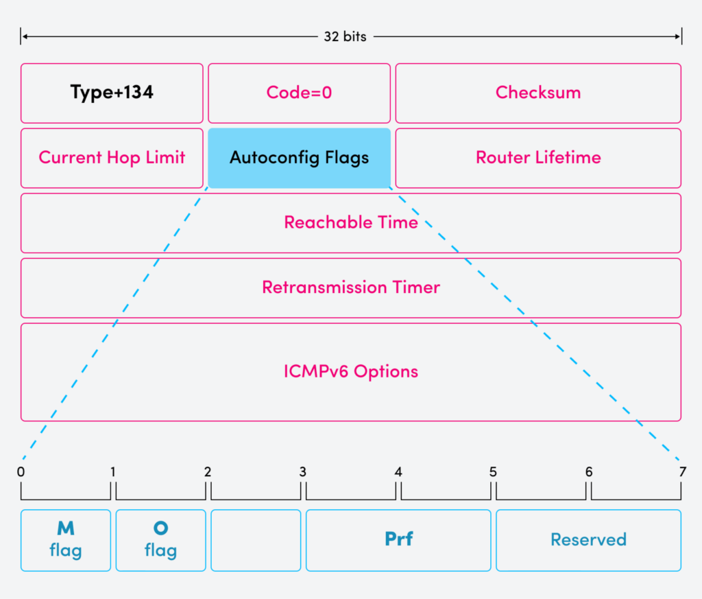

    An IPv6 host is instructed to do one of the above based on the settings of the autoconfiguration flags found within a field of the RA message. Below you can see a depiction of an RA message focusing on the contents of the Autoconfig Flags field:
    The details of the Autoconfig Flags field found within an RA (source)
    The host will respond as follows based on the flag values:
    • If the Managed (M) flag is set to 1, the host is instructed to obtain all of its IPv6 network parameters from a DHCPv6 server. If so, the value of the Other Configuration (O) flag has no meaning and is ignored.
    • If the M flag is set to 0 and the O flag is set to 1, the host is instructed to receive its prefix, prefix length, and default router information from the contents of the RA message but to request a DNS server address from a DHCPv6 server.
    • If M and O are set to 0, the host is instructed to simply use the prefix, prefix length, and the default router provided in the RA and nothing more.
    The Default Router Preference (Prf) is two bits in length and can have the values of 01 (high), 00 (medium), or 11 (low). (Note that the seemingly odd choices of numbers for these priorities are intentional; see RFC4191 for more details.) When a host receives RAs from multiple messages, the value of the Prf field is used to determine which router to prefer as the default router.

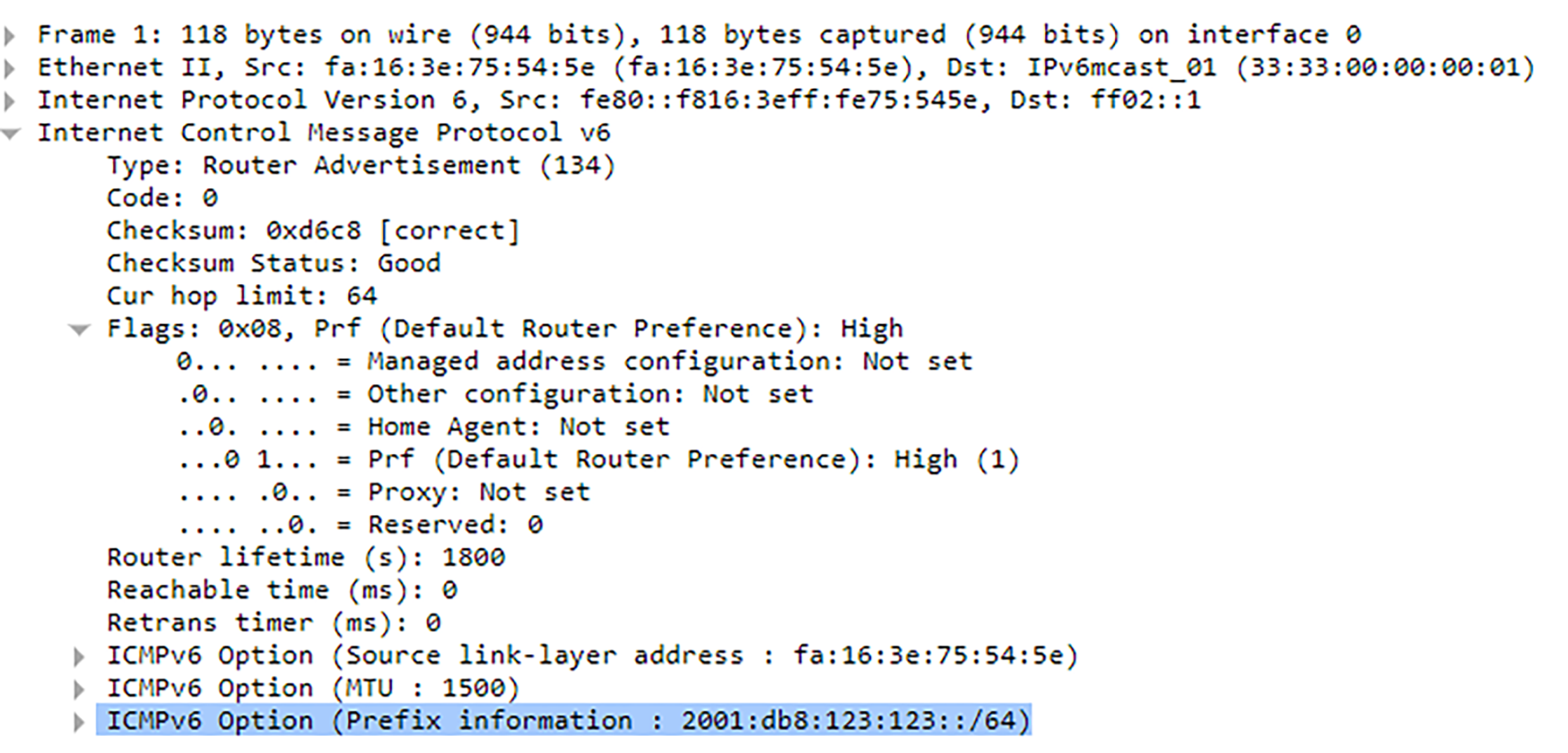

    The following is a Wireshark packet capture of an RA message:
    Wireshark capture of an RA message
    Note the following:
    • The source address is the link-local address of the router, while the destination address is the all hosts multicast address.
    • The message is contained within an ICMPv6 packet.
    • The type is set to 134, which indicates an RA.
    • The flags are set to M=0 and O=0, so the RA is instructing the host to use the prefix, prefix length, and default router delivered by the RA only.
    • The Prf is set to 01, which is high.
    • The prefix and prefix length are 2001:db8:123:123::/64 and are contained within an ICMPv6 option called Prefix Information.

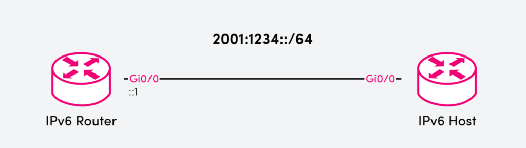

    In the following example, we’ll configure SLAAC on two Cisco routers using the following topology:
    One router will play the role of the IPv6 router on the network segment, while the other will play the role of the host. Before we start, let’s enable IPv6 Neighbor Discovery debugging to see what messages are being sent between the router and client:

    Let’s begin by configuring the IPv6 router’s Gi0/0 interface to act as an IPv6 router on the network segment:
    IPv6_Router#conf t
    IPv6_Router(config)#ipv6 unicast-routing
    IPv6_Router(config)#interface gigabitethernet 0/0
    IPv6_Router(config-if)#ipv6 address 2001:1234::1/64
    Now we have enabled unicast routing, which essentially makes this router an active IPv6 router, and we’ve assigned an IP address to the Gi0/0 interface.
