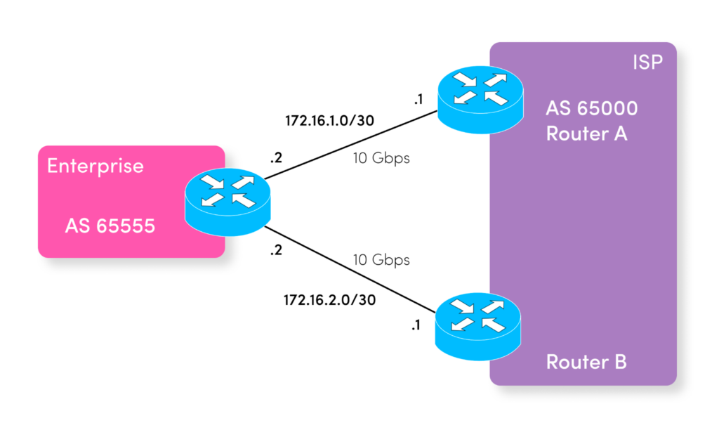

Let’s look at a basic use case to illustrate the concept. Below, an enterprise router connects to two ISP routers via two independent links and BGP sessions. Instead of configuring the links in a primary/backup failover configuration, the goal is to load-balance traffic across them.
The ISP advertises a default route to us via each BGP session and both routes are accepted and installed in our RIB. Without enabling BGP multipath, our RIB looks like this:
user@router> show route 0.0.0.0/0 exact
0.0.0.0/0 *[BGP/170] 1w5d 18:04:33, MED 0, localpref 100
AS path: 65000 I, validation-state: unknown
> to 172.16.1.1 via xe-0/0/1.0
[BGP/170] 0w6d 22:42:11, MED 0, localpref 100
> to 172.16.2.1 via xe-0/0/2.0We see two routes to 0.0.0.0/0, and the route learned via BGP session over xe-0/0/1.0 with next hop 172.16.1.1 is the preferred, active path. This is because this path is the oldest, i.e., it has been up and stable the longest.
Immediately you can see all outbound traffic will use this path. The other path is available for failover but is currently unused.
You can confirm this by viewing the forwarding table. Here, we see a single next hop MAC address and a single next-hop interface. Outgoing packets towards 0.0.0.0/0 use this interface and destination MAC address.
user@router> show route forwarding-table destination 0.0.0.0/0
Routing table: default.inet
Internet:
Enabled protocols: Bridging,
Destination Type RtRef Next hop Type Index NhRef Netif
default user 5 172.16.1.1
ucst 16975 11 xe-0/0/1.0In contrast, if we enable BGP multipath, then both routes can be used. In the next section, we’ll configure and verify it.

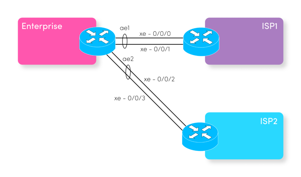

Link aggregation as an alternative or complement to BGP multipath
Link aggregation is a feasible alternative or complementary option to multipathing in some circumstances. Combining multiple similar or identical links into a single logical link provides physical redundancy and increased capacity while managing only a single logical link and routing protocol.
Such aggregated links are commonly known as Link Aggregation Groups (LAGs) and Aggregated Ethernet interfaces (AggEth or ae interfaces in Junos). Expanding on our previous example, we now have connectivity to two different ISPs. We also have two physical links to each ISP.
We can aggregate these links to simplify configuration and management instead of establishing four BGP sessions (one session per link).
On our side, we can create a single logical ae interface per ISP, each ae interface having two physical member links. The same configuration is used on the ISP side. Each ae link behaves like any standard link, having a single IP and MAC address assigned. We also enable an additional protocol called Link Aggregation Control Protocol (LACP) which manages the state and membership of physical links inside the logical one.
Configuration
# first enable the creation of aggregate ethernet interfaces
set chassis aggregated-devices ethernet device-count 8
# then create our new logical interfaces, MYISP1 first
set interfaces ae1 description "MYISP1 Circuit ID: 11111"
set interfaces ae1 aggregated-ether-options lacp active
set interfaces ae1 aggregated-ether-options lacp periodic fast
set interfaces ae1 unit 0 family inet address 172.16.1.1/30
# then configure physical interfaces, adding to the ae
set interfaces xe-0/0/0 description "MYISP1 Link #1"
set interfaces xe-0/0/0 gigether-options 802.1ad ae1
set interfaces xe-0/0/1 description "MYISP1 Link #2"
set interfaces xe-0/0/1 gigether-options 802.1ad ae1
# repeat for MYISP2
set interfaces ae2 description "MYISP2 Circuit ID: 22222"
set interfaces ae2 aggregated-ether-options lacp active
set interfaces ae2 aggregated-ether-options lacp periodic fast
set interfaces ae2 unit 0 family inet address 172.16.2.1/30
set interfaces xe-0/0/2 description "MYISP2 Link #1"
set interfaces xe-0/0/2 gigether-options 802.1ad ae2
set interfaces xe-0/0/3 description "MYISP2 Link #2"
set interfaces xe-0/0/3 gigether-options 802.1ad ae2Verification
Confirm the LACP adjacency has come up on each new ae interface:
user@router> show lacp interfaces ae1
Aggregated interface: ae1
LACP state: Role Exp Def Dist Col Syn Aggr Timeout Activity
xe-0/0/1 Actor No No Yes Yes Yes Yes Fast Active
xe-0/0/1 Partner No No Yes Yes Yes Yes Fast Active
xe-0/0/2 Actor No No Yes Yes Yes Yes Fast Active
xe-0/0/2 Partner No No Yes Yes Yes Yes Fast Active
LACP protocol: Receive State Transmit State Mux State
xe-0/0/1 Current Fast periodic Collecting distributing
xe-0/0/2 Current Fast periodic Collecting distributingWith this configuration we have avoided the need to run one BGP session per link, whilst still retaining link redundancy and availing of the additional capacity.

Combining LAGs and ECMP
It’s possible to combine LACP LAGs and ECMP. Suppose we have configured one LAG per ISP and receive default routes (0.0.0.0/0) from each one.
With a small modification to the previous load-balancing configuration, you can balance traffic across both ISPs.
In this scenario, we have link redundancy with each ISP as well as redundancy between ISPs. Additionally, we have fast failover with less impact on active traffic as only approximately half is affected if one ISP fails.
Configuration
# define policy-statement matching each ISP’s route
# then load-balancing across them
set policy-options policy-statement ECMP-FIB from next-hop 172.16.1.2
set policy-options policy-statement ECMP-FIB from next-hop 172.16.2.2
set policy-options policy-statement ECMP-FIB then load-balance per-packetVerification
We can check the RIB and FIB to confirm that both 0.0.0.0/0 routes are active. Observe two paths in the RIB; though only one is marked active, you will see two active next hops in the FIB output.

This brings us to the LAG configuration option minimum-links. Whether connected to an ISP, another internal router or datacenter switch, you can configure your LAGs to completely fail if they no longer have sufficient operable links.
For instance, you may have a 2x10G LAG which you deem operable only if both links remain up, or a 4x10G LAG which you can comfortably tolerate running at half capacity. The configuration is straightforward:
set interfaces xe-3/1/1 gigether-options 802.1ad ae5
set interfaces xe-3/1/2 gigether-options 802.1ad ae5
set interfaces xe-3/1/3 gigether-options 802.1ad ae5
set interfaces xe-3/1/4 gigether-options 802.1ad ae5
set interfaces ae5 aggregated-ether-options minimum-links 2Unequal-cost multipathing (UCMP)
