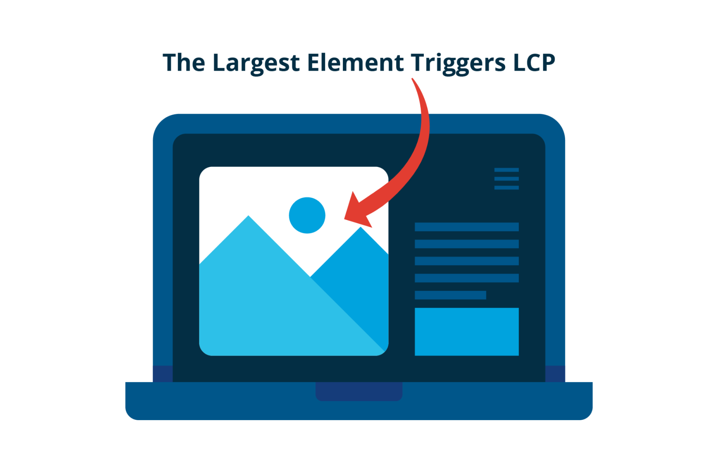

    The Largest Contentful Paint refers to the biggest visual part of the page. It reports the render time for the largest visible element (often images) in the viewport before a user scrolls down or taps a button.
     The Largest Contentful Paint visual concept (source)
    Primarily, LCP only considers the objects that are located above the page fold, which is the content visible to the user without scrolling. These objects normally include elements such as hero images, block-level texts, or video poster images. LCP does not consider anything that falls outside of the viewport (the visible area of a web page that can change based on the device used for browsing).

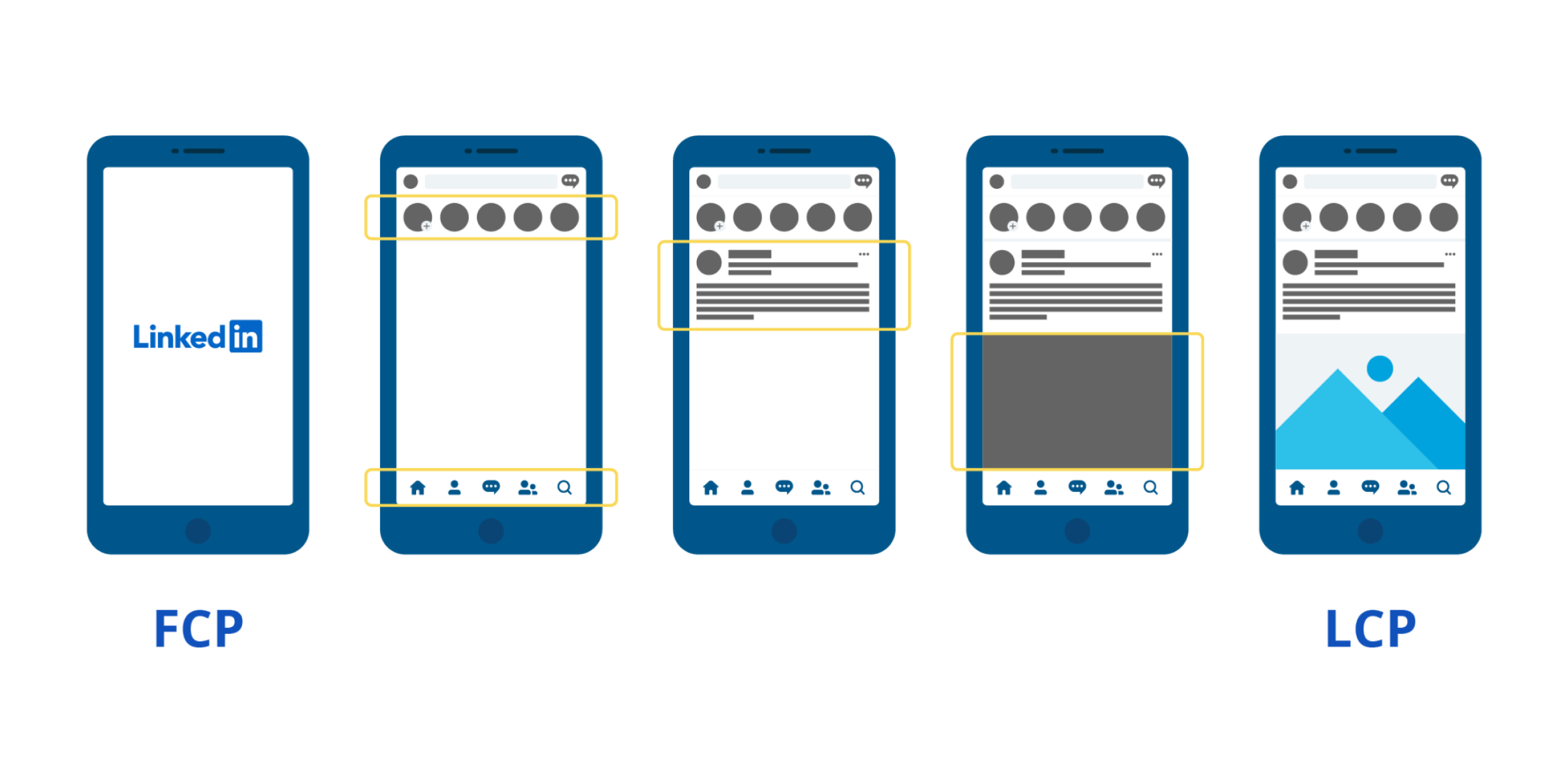

    Largest Contentful Paint vs. First Contentful Paint
    In contrast to the load time for the largest element, First Contentful Paint (FCP) refers to the time taken by the first visual element to appear in the viewport.
    While traditionally, the site’s overall loading speed determines its performance, LCP and FCP have become the recognized measurements used in the industry to gauge a website’s perceived load speed.
    The largest element changes as the LinkedIn website loads the first and largest contentful paint (source)

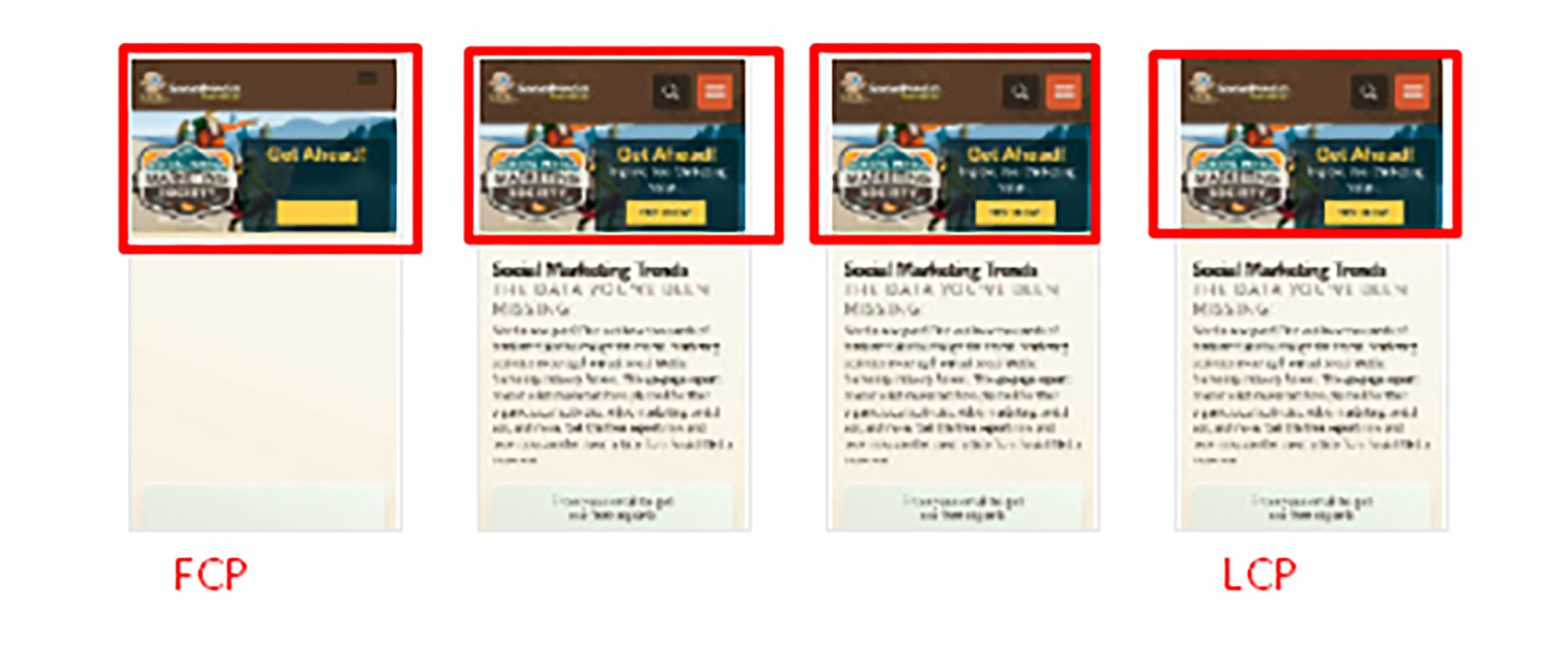

    Here’s another example of a famous Social Media Examiner website in which the largest element remains the same as the content loads
    While FCP is an important metric, it is not a critical metric as LCP because it simply measures the moment the web page shows the first visible element that may be well in advance of other larger elements. On the other hand, LCP is more closely correlated to the user experience, and a fast LCP usually minimizes user irritation.

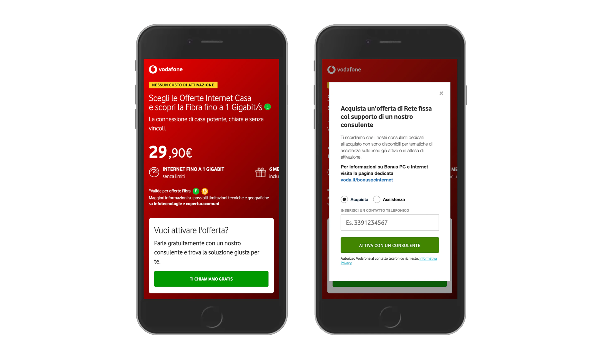

    Vodafone is one of the largest wireless service providers globally, with over 90,000 employees operating in 22 countries. A case study documented by Google claims that the company was able to increase its sales by 5% on the back of improving its LCP by 31% by converting more website visitors to purchases. That increase translates into tens of millions of dollars given Vodafone’s size.
    They conducted an A/B test with two landing pages (the two screenshots below), each receiving 34k visitors from multiple channels, including display ads, social media, and organic search.
    The screenshot on the left leveraged the best practices for improving LCP, also explained later in this article. In this case, the improvements involved shifting some logic from the client-side (the phone) to the server-side and improving how the images were formatted and loaded.
    Based on these improvements, the largest contentful paint happened in 5.7 seconds instead of 8.3 seconds, which improved the sales conversion results from the page on the left by 11 to 15%.
    The left and right screens have identical functionality, but the left has a better LCP.

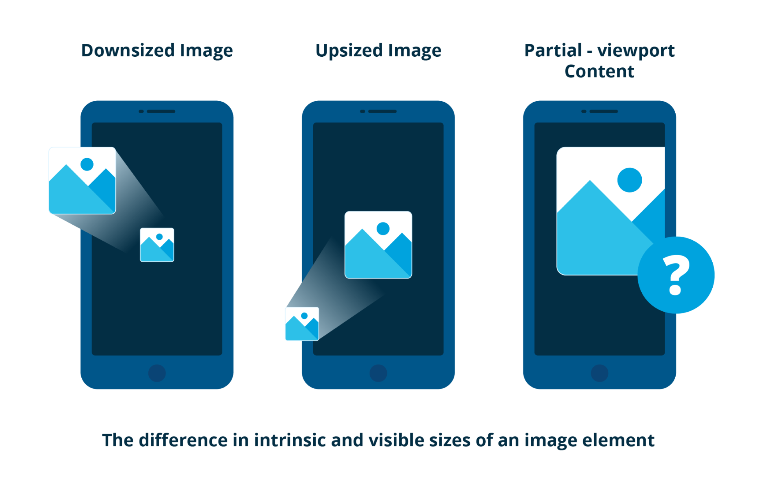

    How is element size determined?
    Typically, the element’s size visible to the naked eye within the viewport is reported for LCP.
    Size = Width x Height
    The margin, padding, and border are not part of the size calculation.
    Remember to distinguish between the intrinsic size (original size of the uploaded element) instead of the visible size of the element. Google considers whichever pixel size is smaller between the visible and intrinsic sizes to calculate the element size.

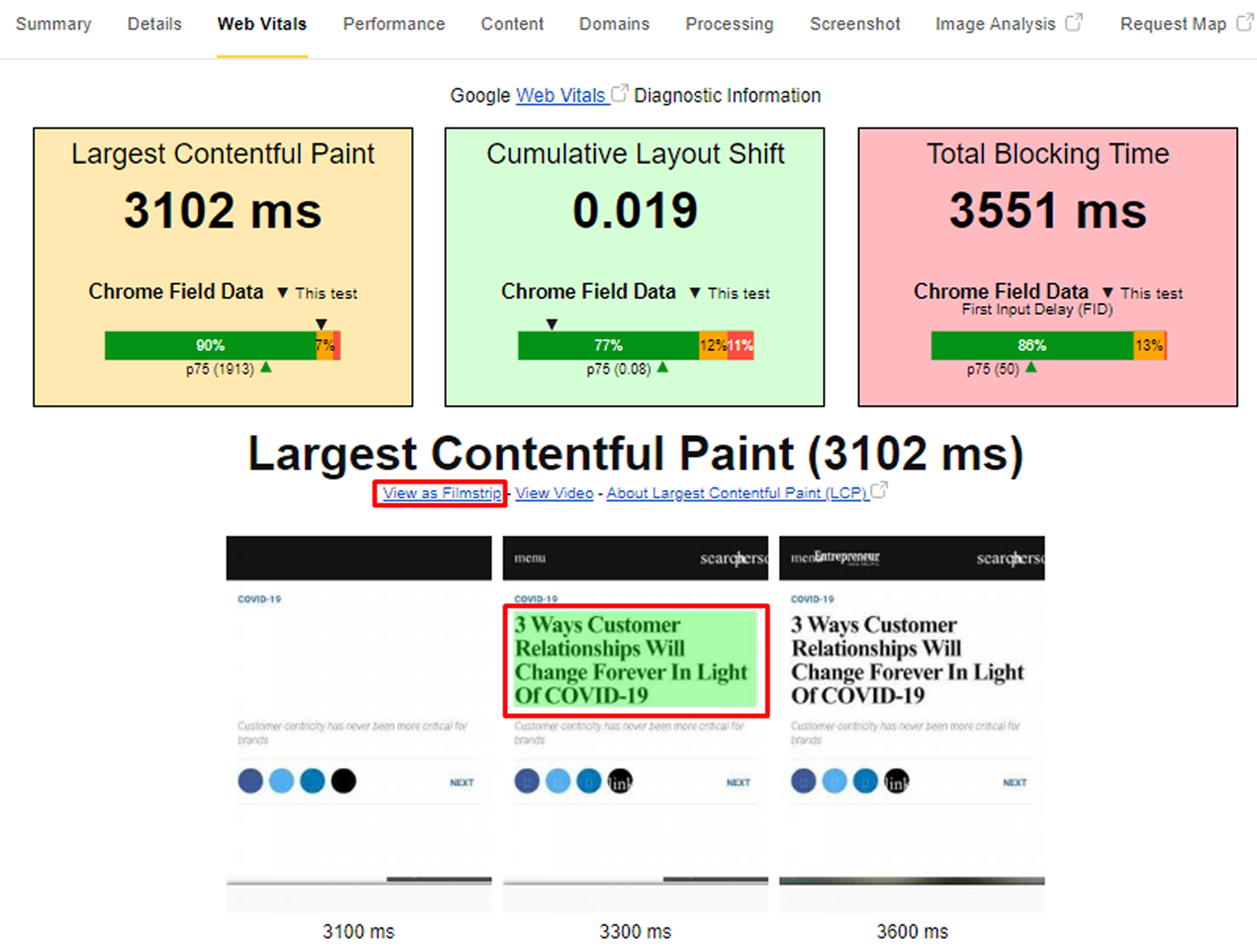

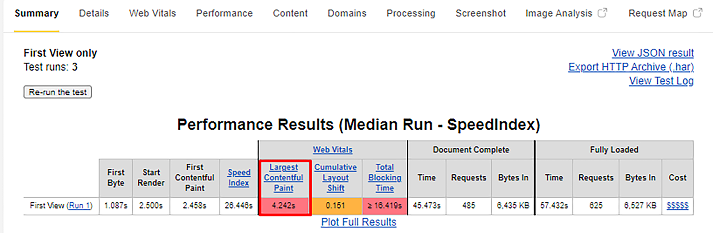

    Follow the steps below to quickly find the largest element using WebPageTest:
    1. Go to www.webpagetest.org/webvitals
    2. Enter the web page URL you want to test (we used this URL in the example below).
    3. Click on Start Test and wait a couple of minutes to get the final results.

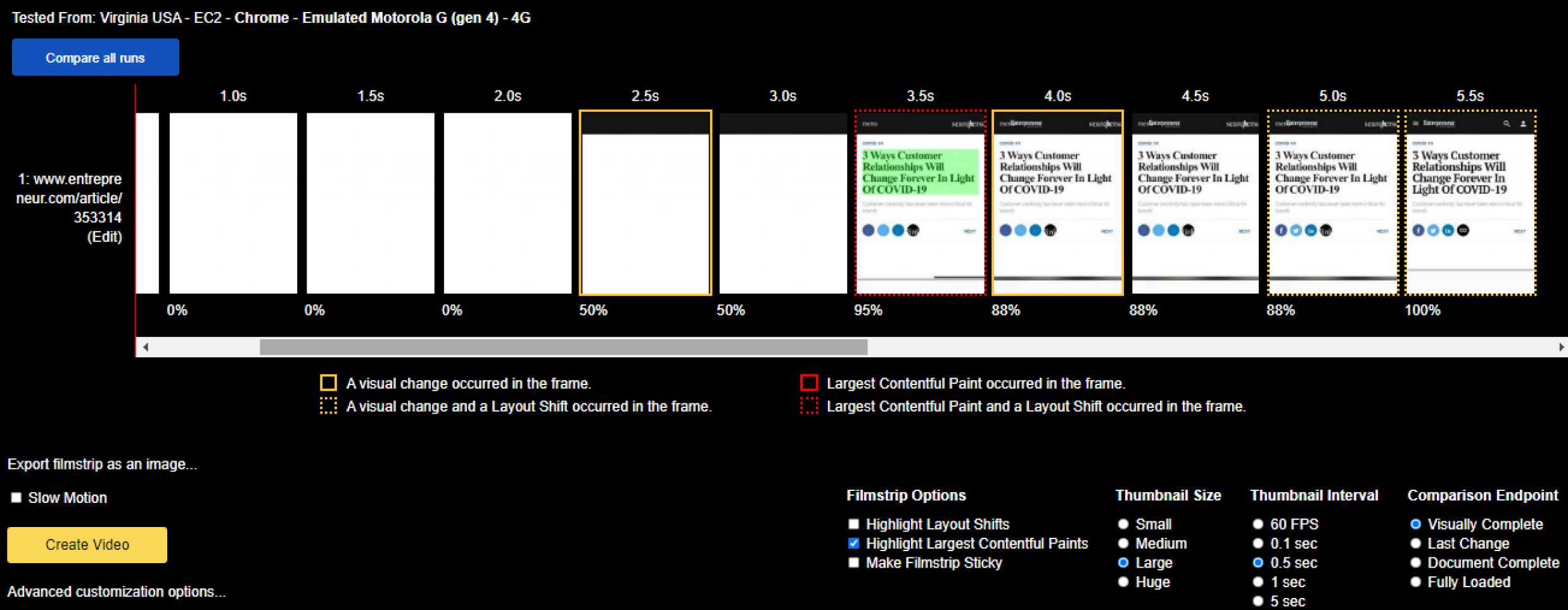

    Select View as Filmstrip to see the entire test frame-by-frame Or View Video to watch a recording of the user experience as the page loads. These two features are unique to WebPageTest and a core differentiating factor compared to other measurement methods.
    The archived report generated by WebPageTest is accessible here.
    In this example <H1> is the largest element causing LCP.
    You can use the following options in Filmstrip View for better understanding.
    • Highlight Largest Contentful Paints
    • Thumbnail Size: Large
    • Thumbnail Interval: 0.5 sec

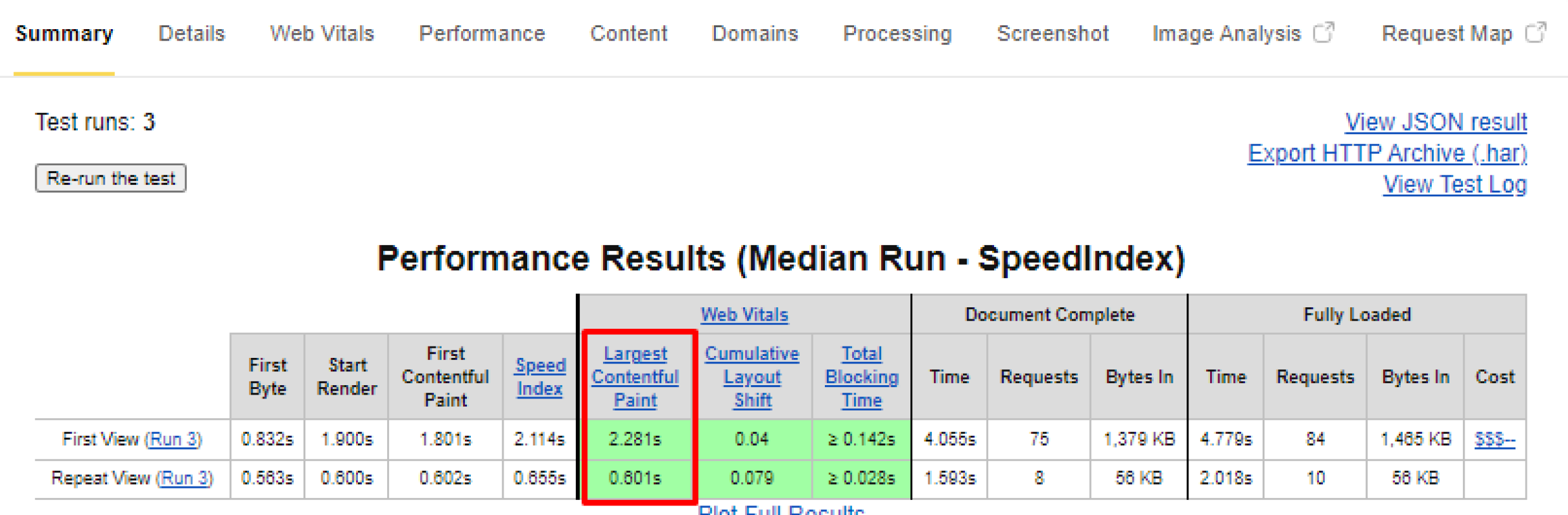

    Example of a good Largest Contentful Paint score
    The screenshot below shows Socialmediaexaminer.com with a good LCP score, which is highlighted by a red rectangle. Check the complete archived web performance report here, generated by the WebPageTest tool.

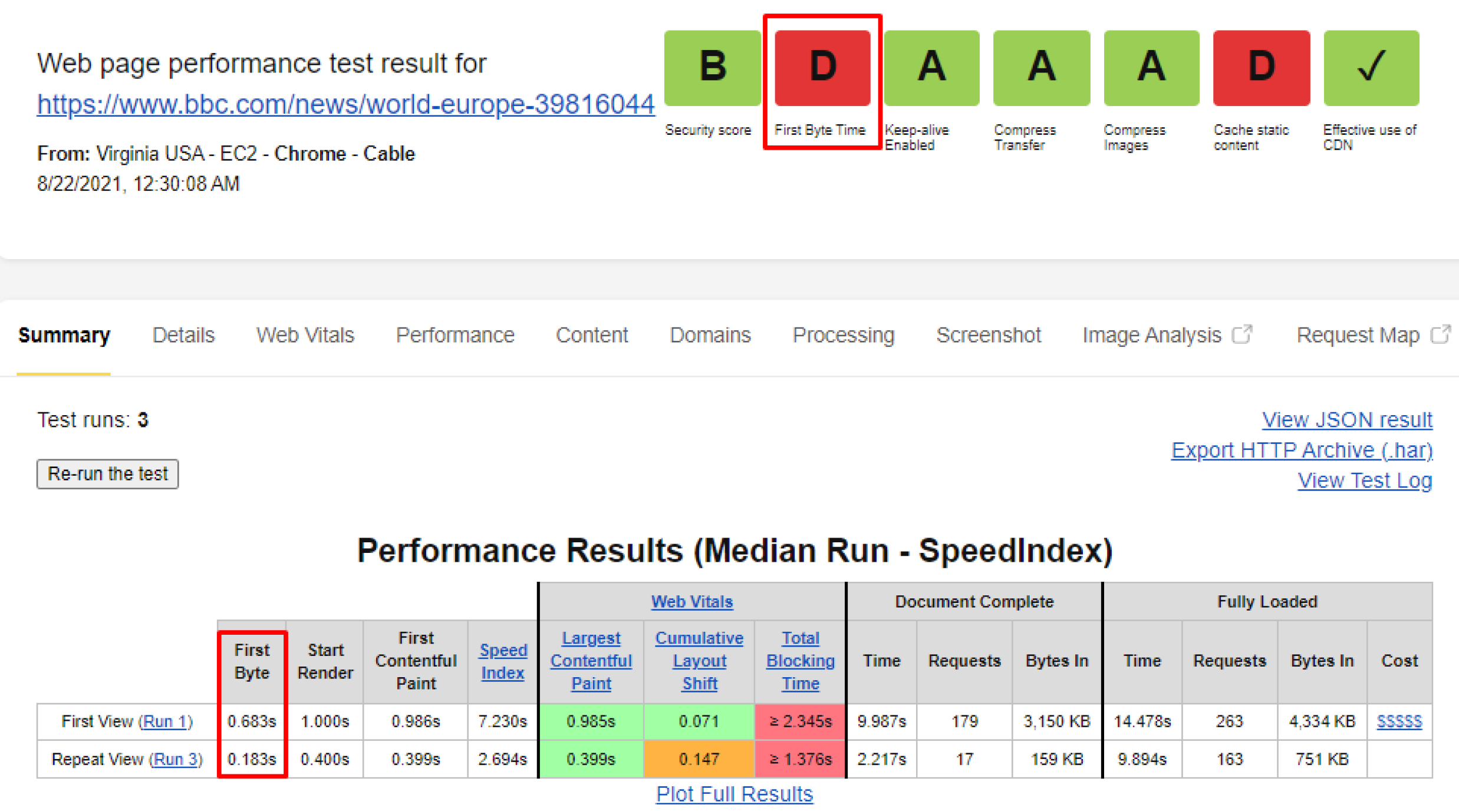

    1.   Slow Server Response

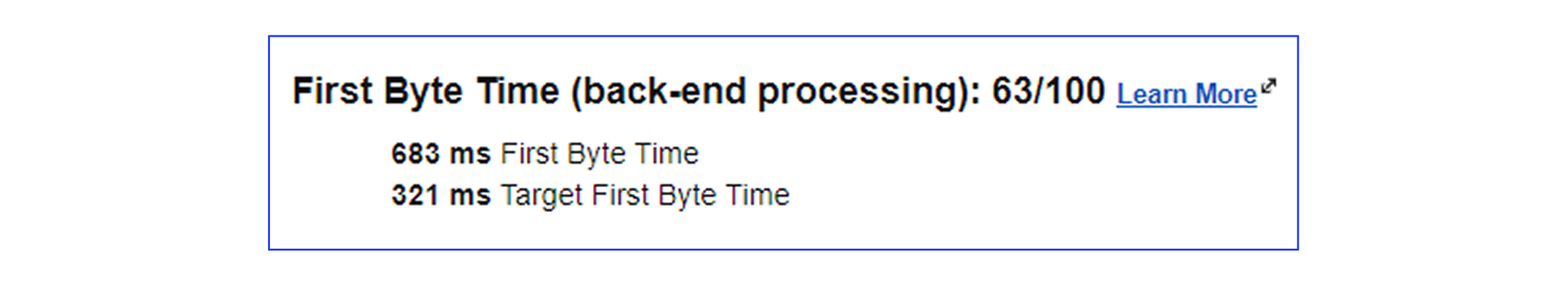

    The server on which your website is hosted can take too long to respond to the user requests, causing a poor user experience.  You can measure your server response time using a metric known as the Time to First Byte (TTFB). According to the WebPage Test glossary, “TTFB is measured as the time from the start of the initial navigation until the first byte of the base page is received by the browser (after following redirects).”
    A high TTFB indicates that your server is approaching its maximum capacity. Google recommends maintaining your web page’s TTFB to be less than 200ms.
    In the following screenshot, you can see the red boxed area – First Byte Time – denoting ‘Grade D’ for an article published on bbc.com/news, which suggests that the server response time has an underlying performance issue.
    By clicking on the “First Byte” grade, you will see the details (also shown below), including the measured TTFB value and a recommended value that the web publishers should target in this case.
    How to fix it?
    • Improve Server Performance
      The simplest of all solutions to improve server performance is upgrading your hosting plan. If the hosting server is overloaded, you need to optimize it by fixing the bottlenecks (e.g., heavy traffic, slow routing, resource CPU starvation, slow database quire, memory starvation, etc.) that slow down your systems.

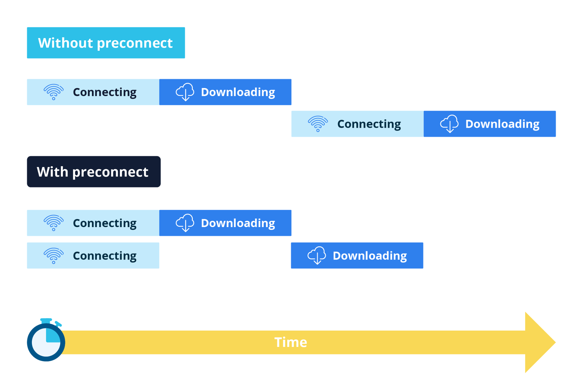

    • Establish Third-Party Connections Early
      You can do this by using the preconnecting and prefetching feature on your website if it contains third-party scripts such as videos or Google fonts. With this approach, the browser fetches content while the user is browsing the content that has already been loaded.
    Adding the attributes  rel=”dns-prefetch” or rel=“preconnect” tag to a <link> informs the browsers that your web page intends to be connected with another domain and that you would like to perform this process as soon as possible and before the user clicks.
    <link rel=“preconnect” href=“https://example.com”/>
    <link rel=“dns-prefetch” href=“https://example.com”/>
    You can also use Prefetch DNS for various other external assets Google Analytics, Google fonts, and even a CDN, as shown below.
    <link rel="dns-prefetch" href="//fonts.googleapis.com">
    <link rel="dns-prefetch" href="//www.google-analytics.com">
    <link rel="dns-prefetch" href="//cdn.domain.com">
    You can eliminate roundtrips latency from the request path by even thousands of milliseconds – saving render-blocking time for users by increasing load speed.

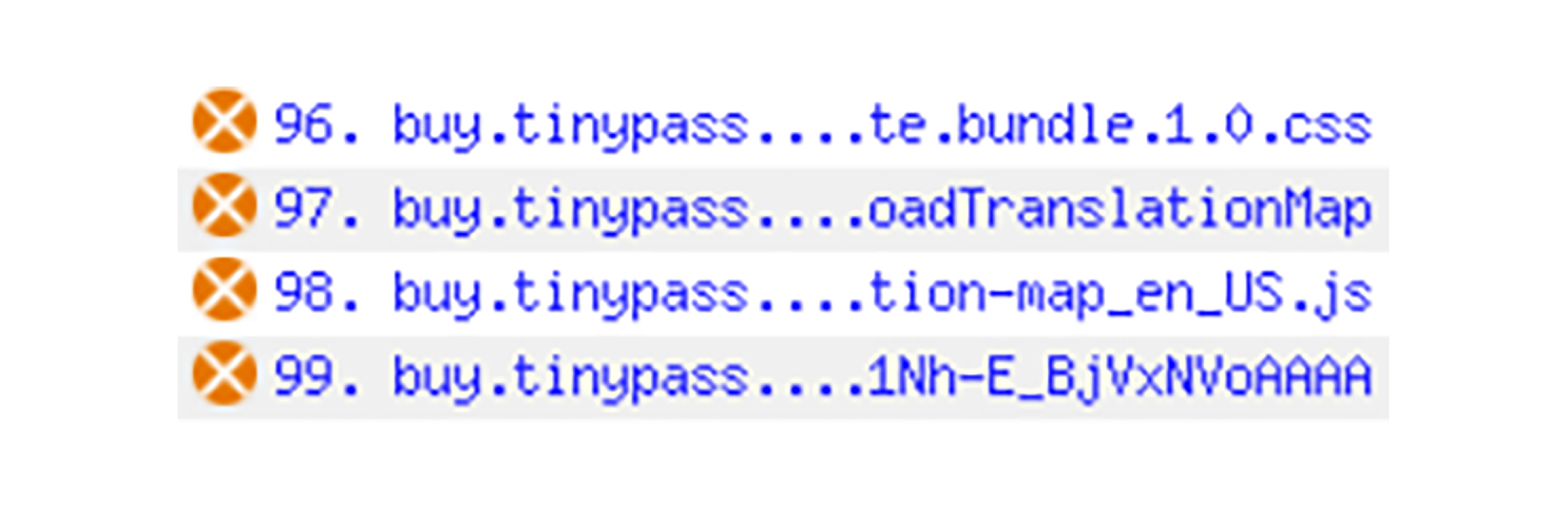

    2.   Render-blocking CSS and JavaScript
    A browser needs only the essential elements required to construct a page before rendering it for viewers to see. Any other element or code (such as a JavaScript or stylesheet) that can be loaded after the page is rendered is considered non-critical to displaying the web page. The loading and processing of non-critical elements unnecessarily slow down a page’s rendering time. This concept is referred to as render-blocking and is a common cause of website loading delays. Since the browser must first download and process it before knowing if it’s critical or not, it’s the job of web developers to make this process lean.In the waterfall view of the same bbc.com/news example shared earlier in this article, you can see the render-blocking resources shown in the following screenshot.
    WebPageTest analyzes the browser rendering process and identifies the blocking files so that you can address them to improve your page loading time. You can click here (navigate to the “waterfall view”) the detailed archived report produced by WebPageTest showing CSS and JS elements causing page load delay.

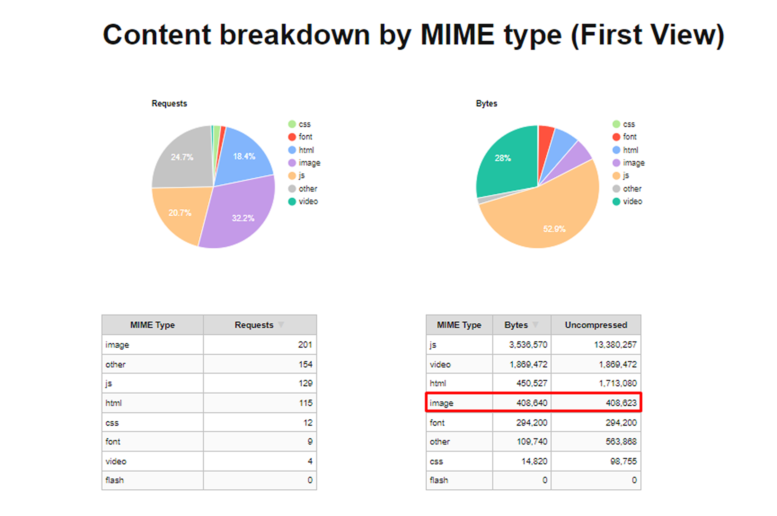

    Go to the Performance Tab of the test result in the archived WebPageTest (linked below) for more details.
    You can click here to see the details about these uncompressed elements playing a significant role in the poor LCP of the Forbes article under review.

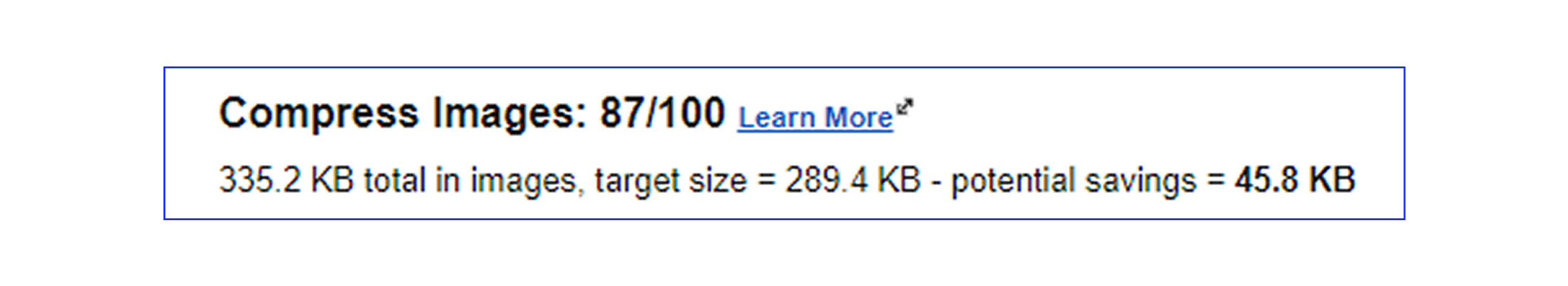

    The simplest remedy in this situation is to compress and optimize large high-resolution images. Here is a list of best practices for addressing large images:
    • Compress large images before uploading them to your site
    • Use a plugin to compress the images once uploaded to your site
    • Serve graphic content in WebP format instead of PNG or JPEG
    • Preferably use high-quality and responsive images in correct sizes
