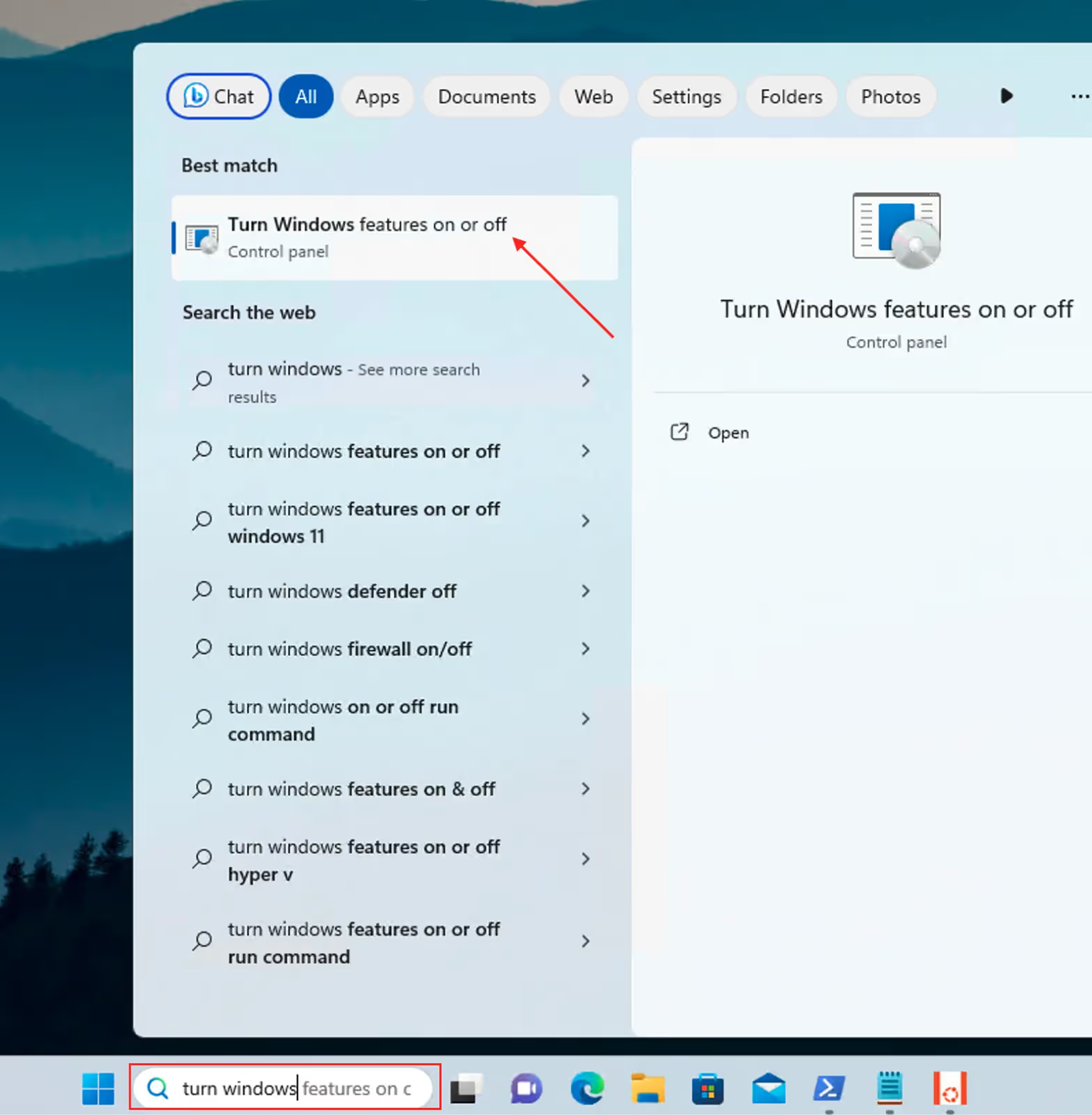

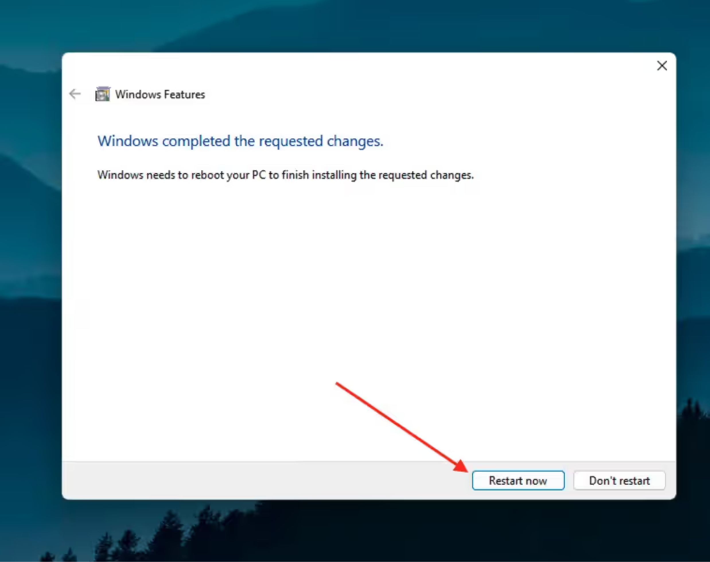

Step 1 To start, we’ll need to enable the Virtual Machine Platform module and Windows Subsystem for Linux feature. Open up your Start menu and locate the Turn Windows features on or off menu.

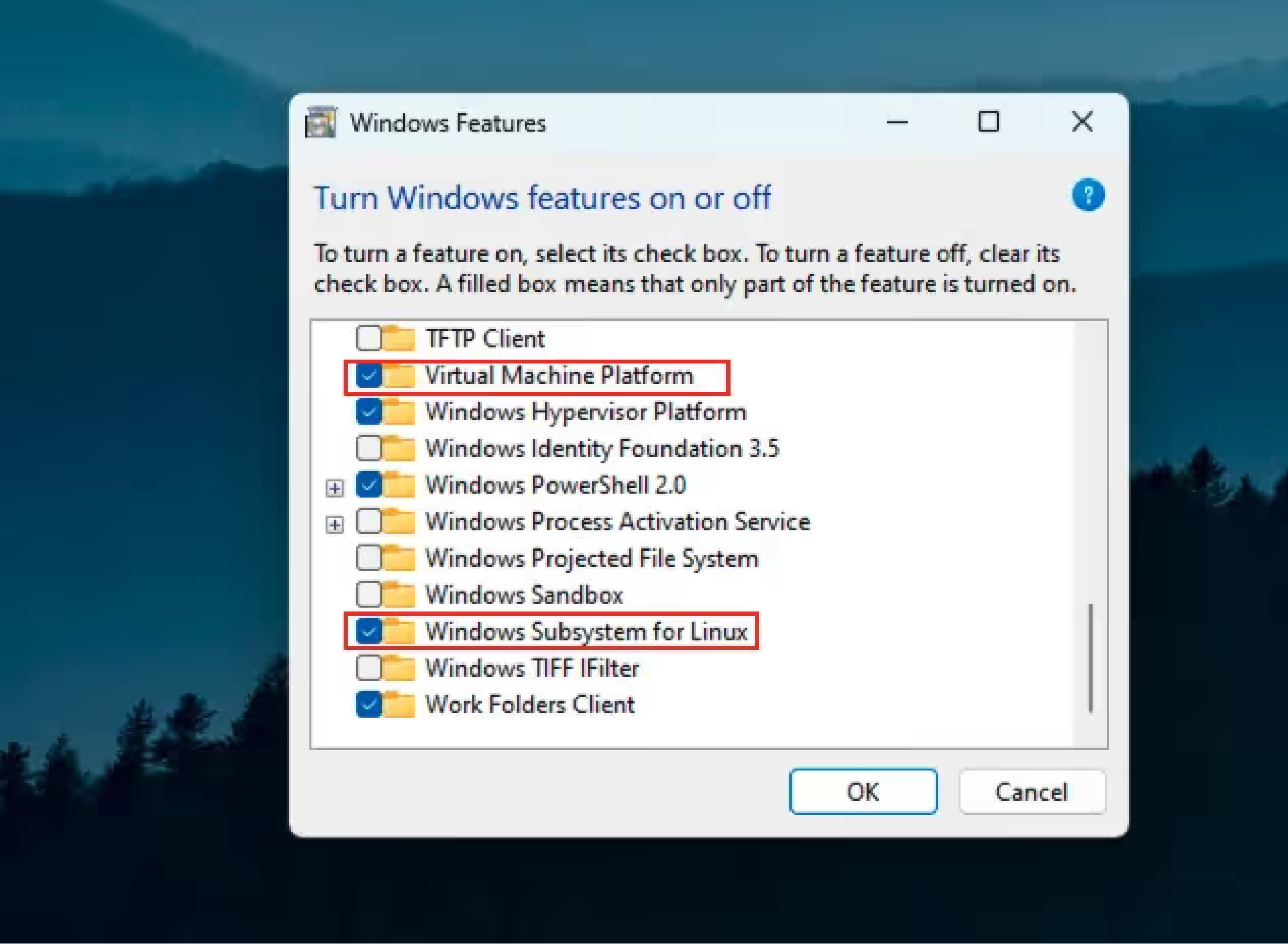

Step 2 Next, find the Virtual Machine Platform and Windows Subsystem for Linux options. Check both of these boxes and then press OK to enable these features.
Step 3 Windows will make the desired changes, which may take a minute or two, then it will ask you to restart your system for the changes to take effect. Proceed with the reboot.

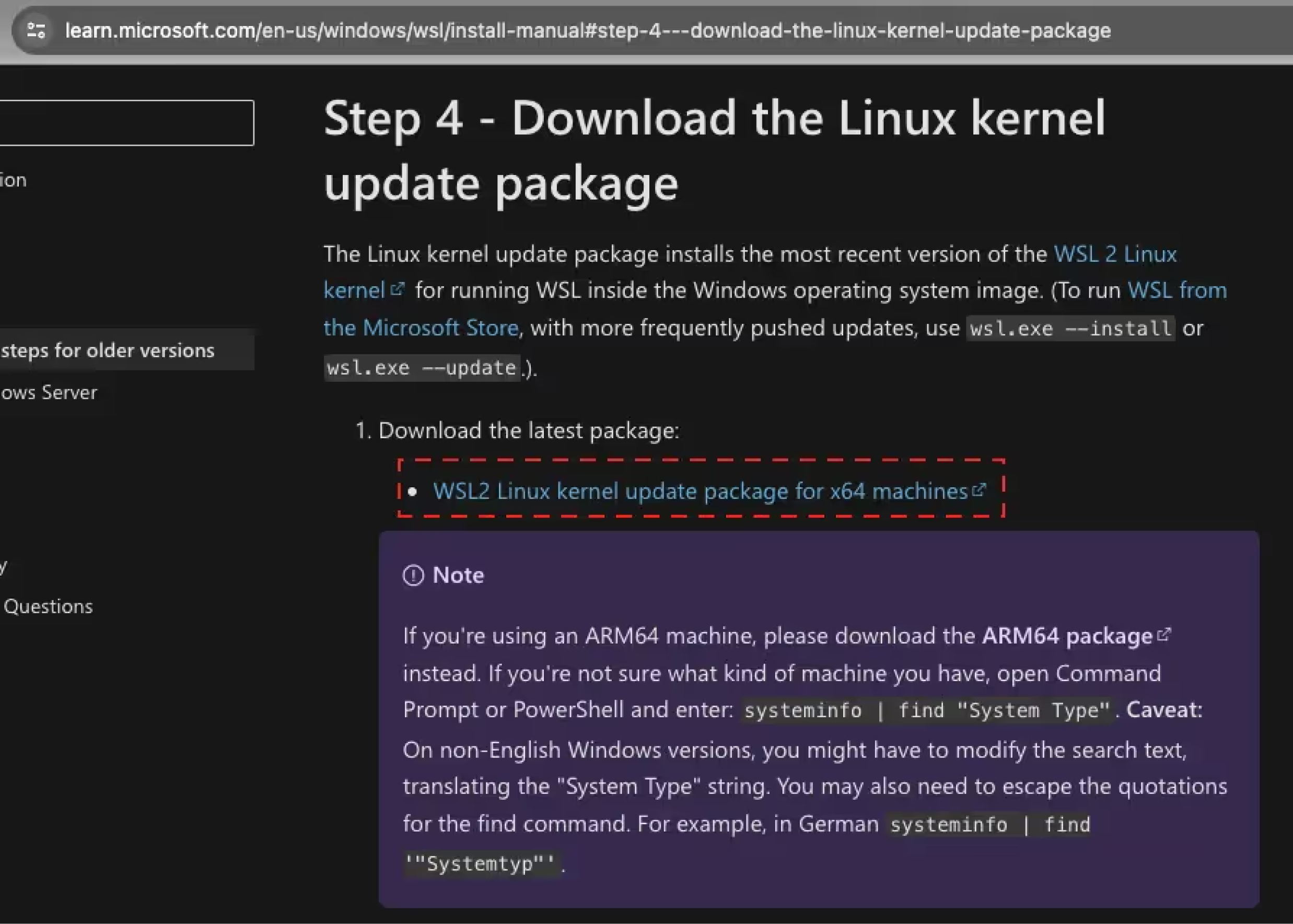

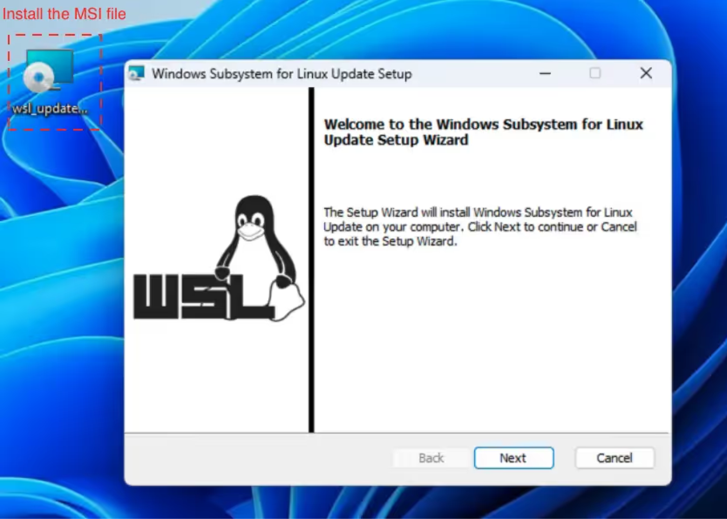

Step 4 Download and update the WSL 2 Linux Kernel:
- Access the latest WSL 2 Linux Kernel package from Microsoft at aka.ms/wsl2kernel
- Install the downloaded MSI package.

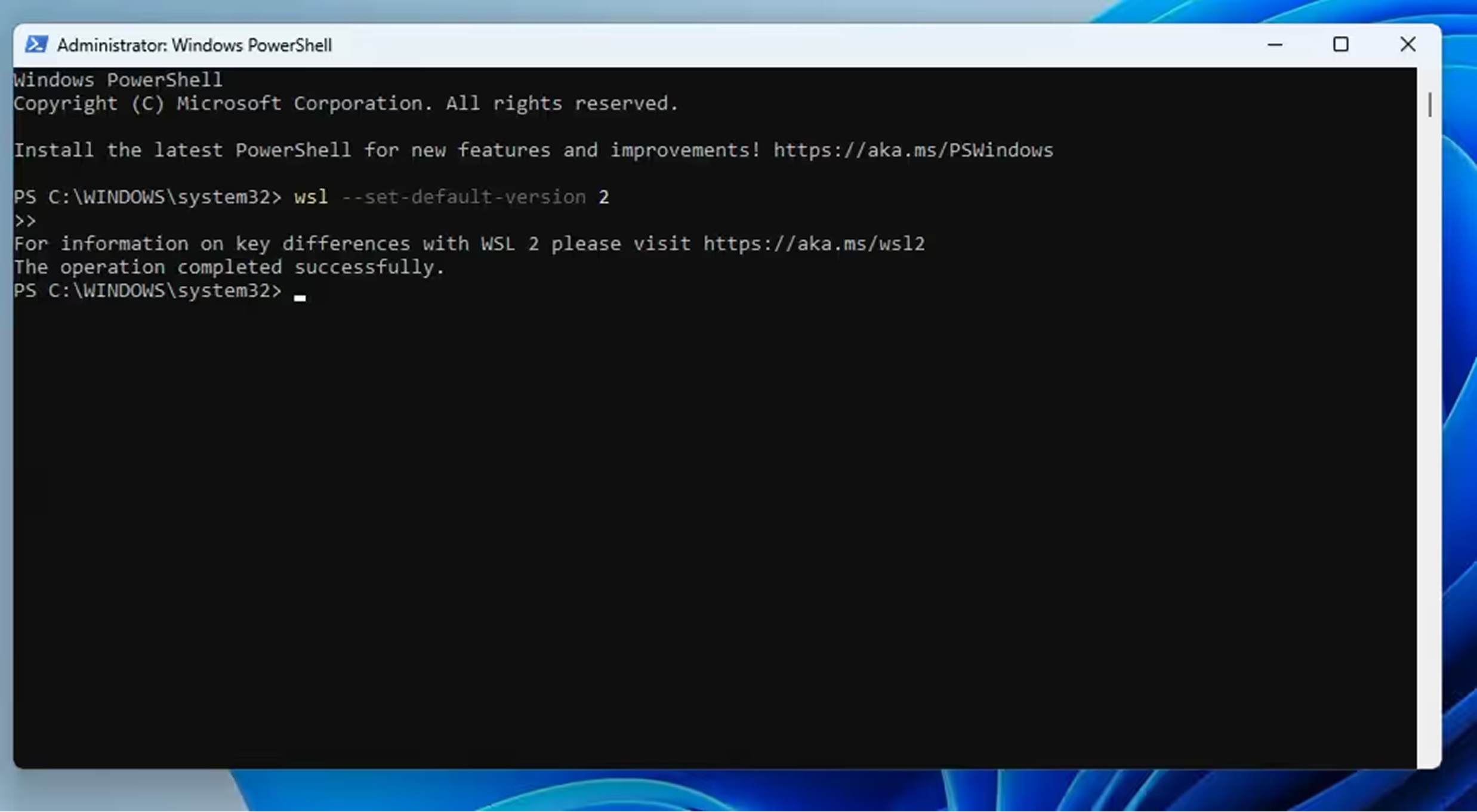

Step 5 Set WSL 2 as the default version:
- In PowerShell as Administrator, enter: wsl –set-default-version 2

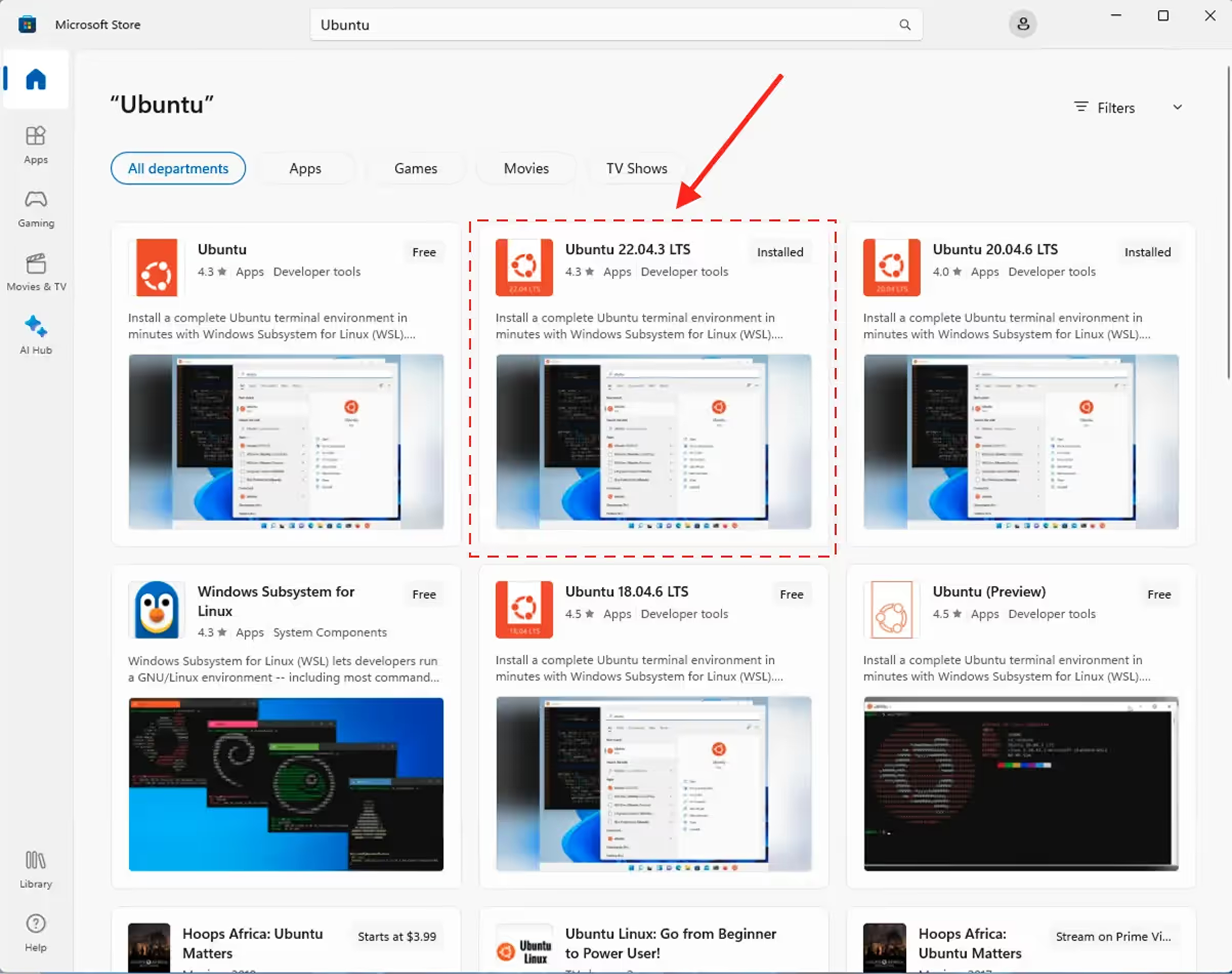

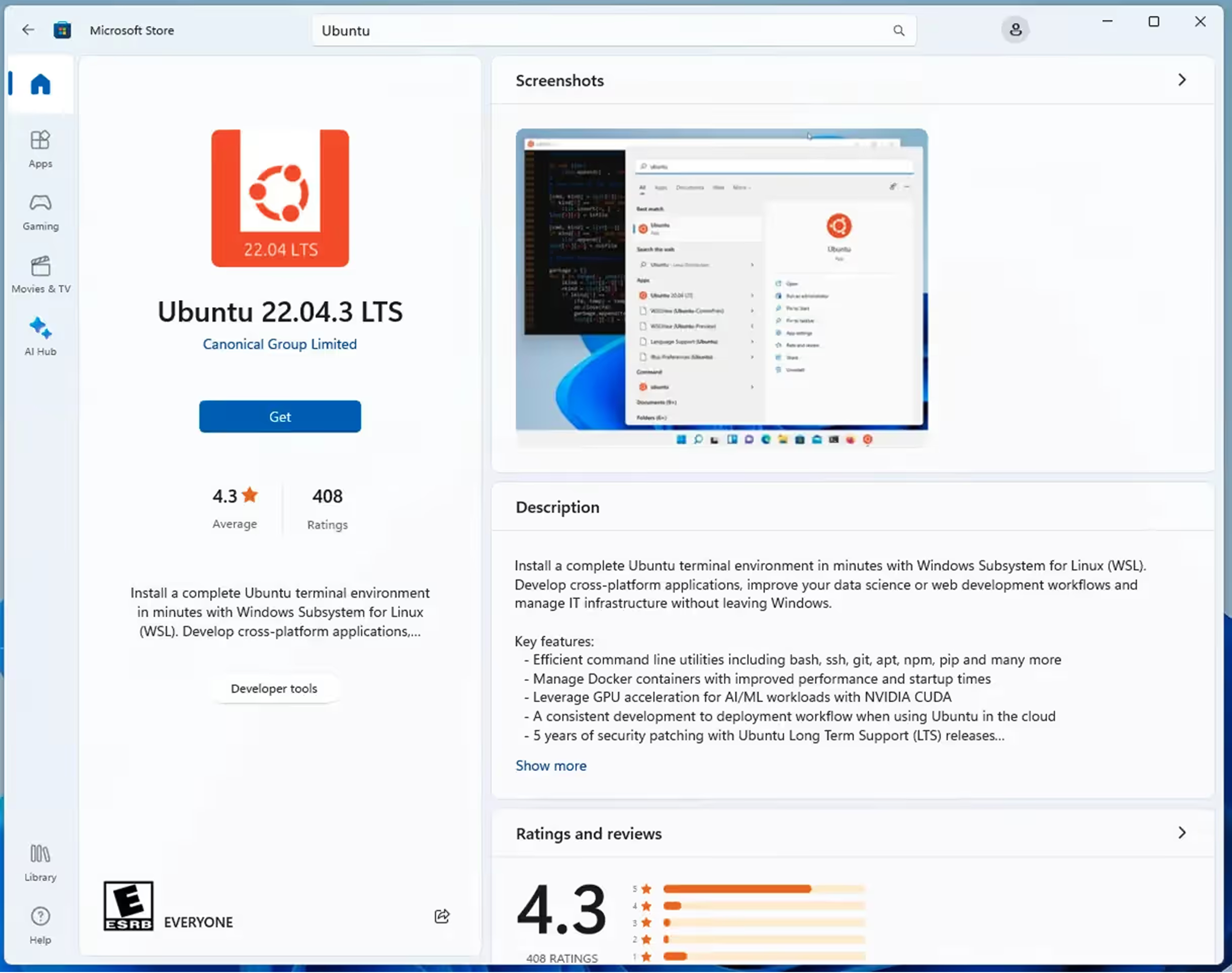

Step 6 Get Ubuntu 22.04 LTS from the Microsoft Store:
- Open the Microsoft Store app and search for “Ubuntu 22.04 LTS.”
- Download and install the Ubuntu 22.04 app.

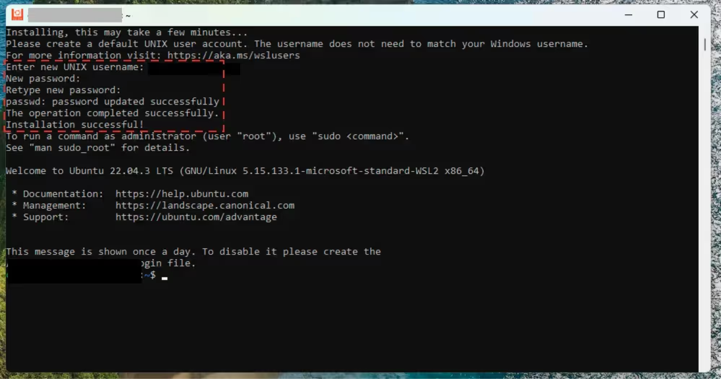

Step 7 Complete Ubuntu 22.04 LTS setup:
- Launch the installed Ubuntu 22.04 app and create a username and password for your Linux account.
- Congratulations, you’ve successfully installed WSL and Ubuntu 22.04 LTS on your Windows 11 device. You can now use the terminal window to run Linux commands and applications.

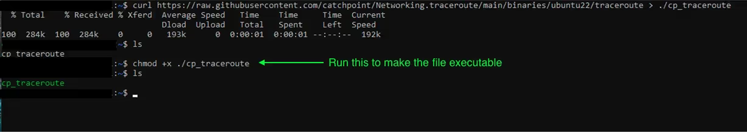

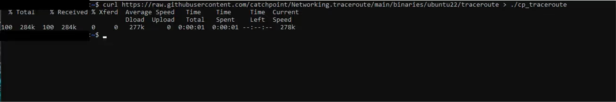

- Download and make the program executable:
- Open the terminal window within Ubuntu 22.04 LTS.
- Run:
- curl https://raw.githubusercontent.com/catchpoint/Networking.traceroute/main/binaries/ubuntu22/traceroute > ./cp_traceroute
- Make the downloaded binary file executable:
chmod +x ./cp_traceroute
Note: To execute all traceroute modes without requiring sudo or root access, we recommend running the following command:
Command: sudo setcap cap_net_raw+ep ./cp_traceroute

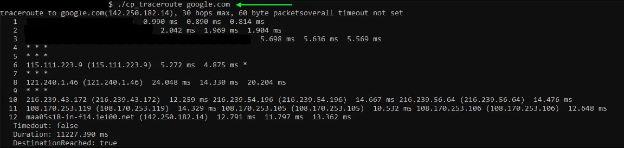

UDP Traceroute:
- Command: ./cp_traceroute <target>
- Purpose: UDP traceroute typically utilizes UDP packets with incremental TTL values, not dependent on specific ports. It sends UDP packets incrementing port numbers at each hop. It’s instrumental in diagnosing connectivity issues, revealing the route traversed by UDP traffic across various routers, aiding in understanding potential bottlenecks or disruptions.

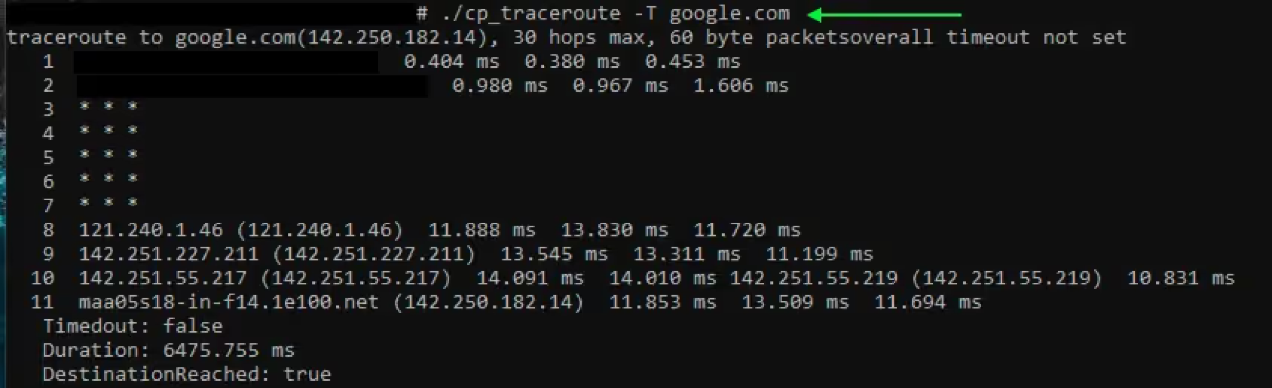

TCP Traceroute:
- Command: ./cp_traceroute -T <target>
- Purpose: TCP traceroute employs TCP packets and generally operates by sending SYN packets to port 80. It’s invaluable for pinpointing the path and latency encountered by TCP traffic, essential for troubleshooting TCP service-related connection problems.

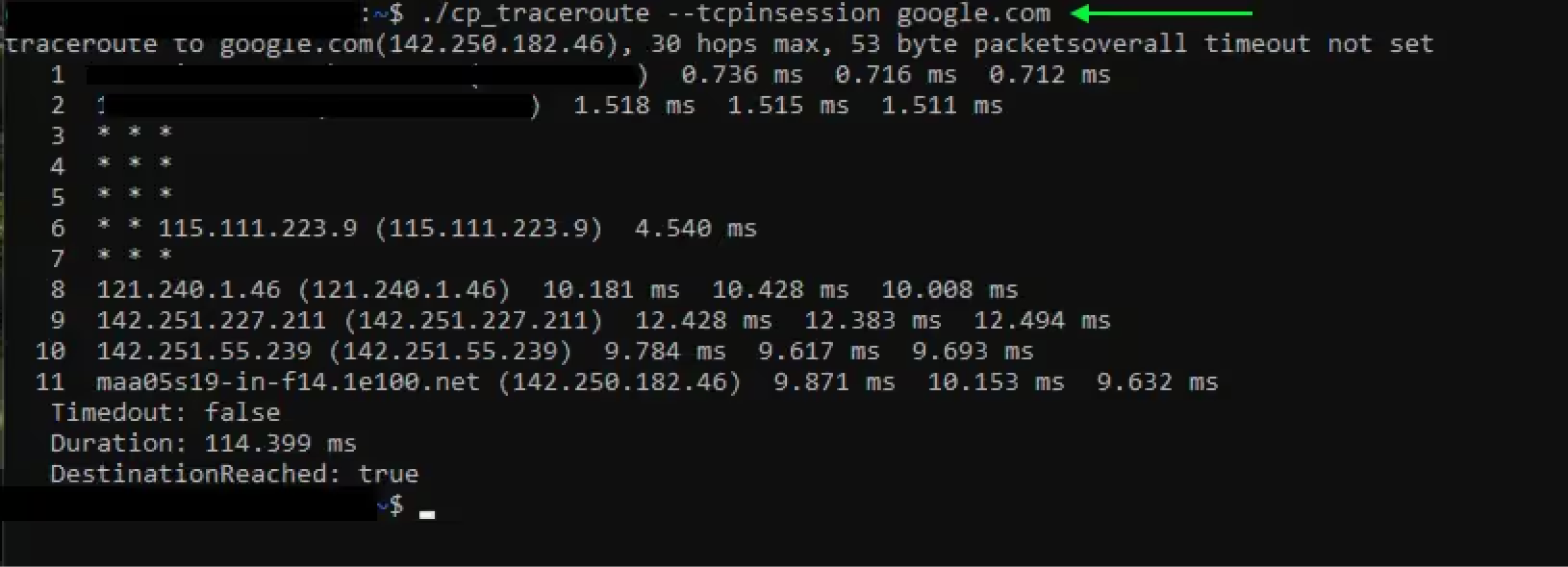

TCP InSession:
- Command: ./cp_traceroute –tcpinsession <target>
Purpose: Different from the classic TCP traceroute, where each traceroute packet is a SYN packet, TCP InSession first establishes a TCP connection with the destination, then it sends 1-byte data packets within the opened session with incremental TTL, until the destination is reached. To avoid bothering the destination application, it inserts a gap into the stream of sequence numbers, with the aim of avoiding any data that’s delivered to the application level (since it’s incomplete).
The main advantages of TCP InSession are:
- Each traceroute doesn’t risk being seen as a SYN flood attack and therefore being filtered by firewall protection rules, because only one SYN is sent per traceroute
- Probes are more likely to cross the same IP-level path, because they belong to the same TCP session, and thus load balancers are more likely to treat them equally.
One drawback of TCP InSession, however, is that it requires an application to listen on the destination port, in order for the TCP session to be established.

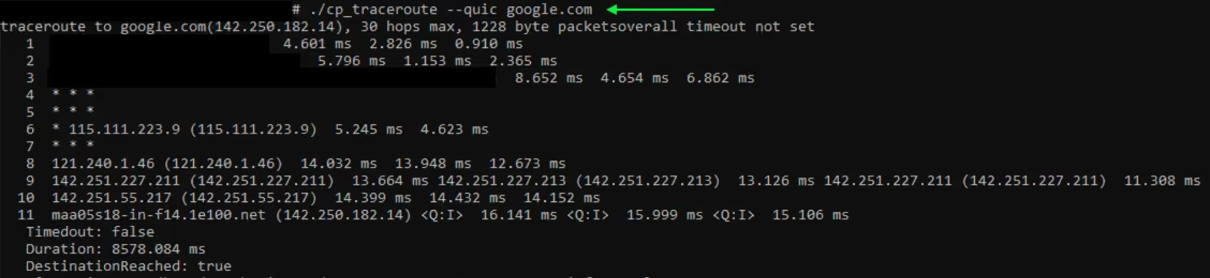

QUIC Traceroute:
- Command: ./cp_traceroute –quic <target>
- Purpose: QUIC is a modern protocol that runs more and more of the Internet (specifically the World Wide Web). Although it’s based on UDP, it provides mechanisms such as connection establishment, congestion control, and encryption. For instance, HTTP/3 uses QUIC as its transport layer.
During traceroute, the probes sent correspond to QUIC Initial packets, instrumental in the initial handshake phase as mandated by the QUIC protocol.
The primary objective of a QUIC traceroute is to unveil the route taken by these QUIC initial packets and ascertain the destination’s support for QUIC. Given the default target port of 443 (HTTPS), this type of traceroute is also beneficial for determining the likelihood of whether the destination will support HTTP/3.

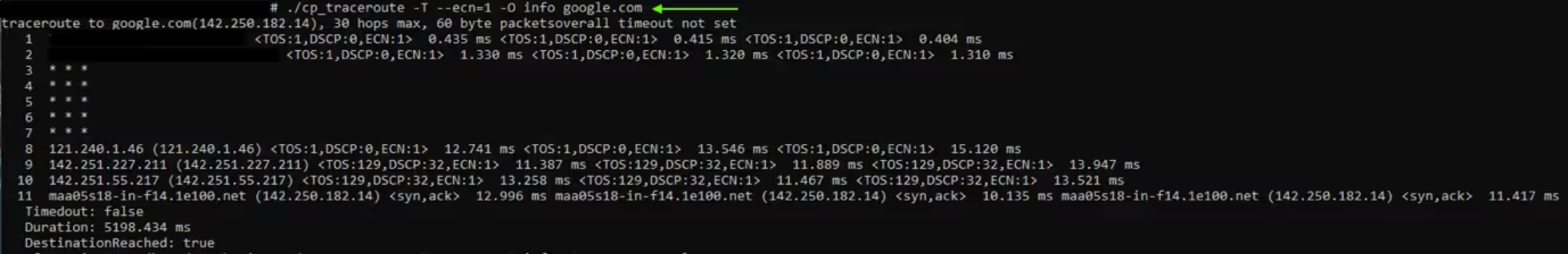

Classic ECN with TCP:
- Command: ./cp_traceroute -T –ecn=1 -O info <target>

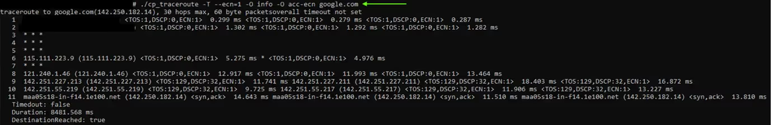

AccECN (L4S) with TCP:
- Command: ./cp_traceroute -T –ecn=1 -O info -O acc-ecn <target>
