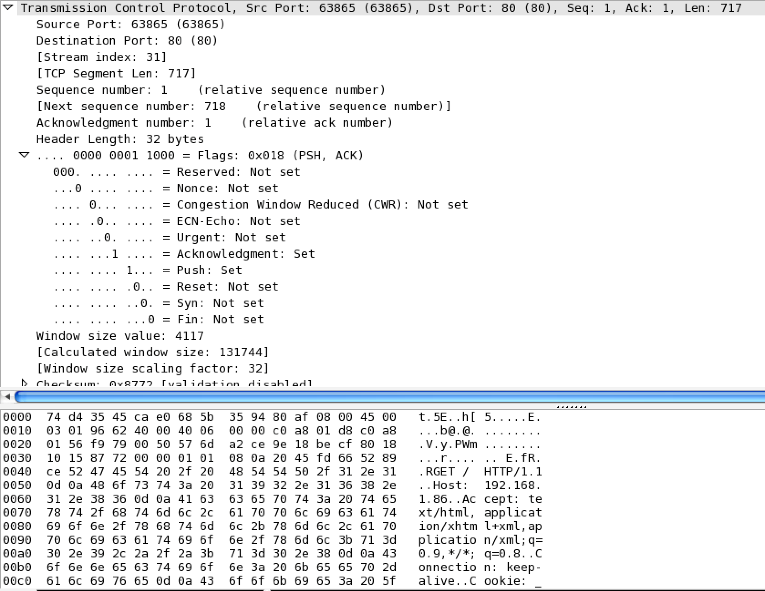

The PSH flag tells the sending TCP stack not to wait for the buffer to fill before sending data. Instead of holding smaller packets until there’s enough data to fill a full segment, PSH forces immediate dispatch to the receiving application.
A browser requesting HTML from a server sends a request too small to fill a full TCP segment. Rather than wait for the buffer to fill, the request is packaged and marked with a PSH flag, telling the operating system to send it immediately.
The PSH flag is determined by the operating system’s TCP implementation. Berkeley-derived systems, for example, set PSH to signal that the client’s send buffer is empty.

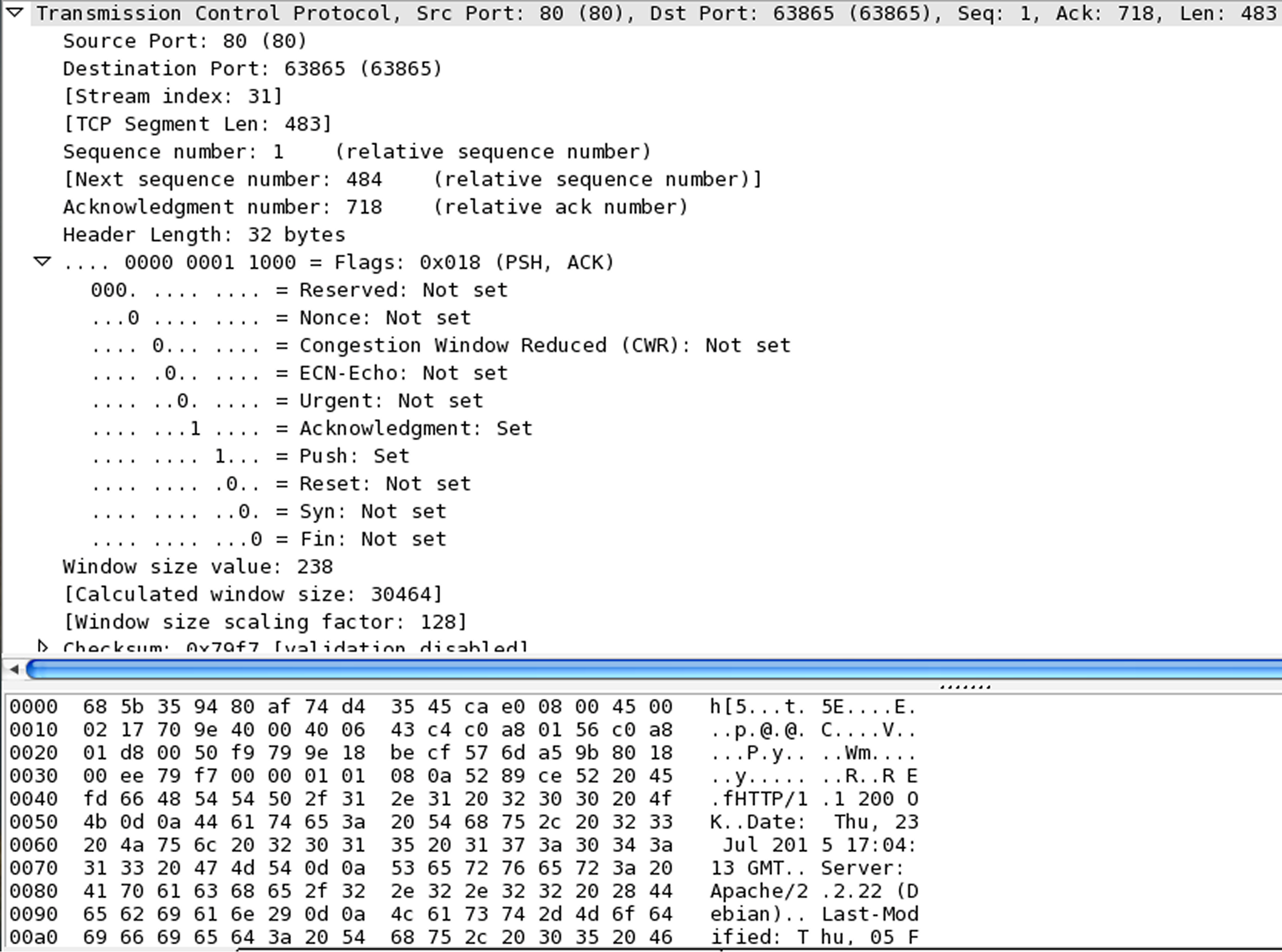

This shows up in the response to the request above, captured below.
It’s a small reply, marked with a PSH before the transaction is concluded with the FIN.
When you see PSH set in a capture, it typically means the sender had data too small to fill a segment and the OS decided not to wait. If PSH appears on nearly every packet in a trace, that’s normal; it just means the application is sending small, frequent bursts rather than large chunks.
