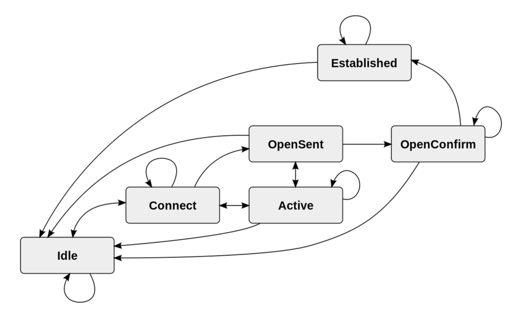

    Overview of BGP States
    Six states are involved in the BGP process as defined by the BGP finite state machine (FSM). The FSM illustrates what actions play a role at each stage of BGP session establishment. The diagram below shows how the transition between the states might occur.
    BGP Finite State Machine
    The table below summarizes all the BGP states and the pertinent processes associated with each. It is worth noting that the first three states are concerned more with TCP, while the last three  have more to do with BGP only. It is not uncommon to hear them referred to as two distinct sets: TCP phases and BGP phases.

    Deep Dive into BGP States
    Here, we will explore each of the BGP states in depth and explain how the transition between them occurs.
    Idle
    The first BGP state listens for an incoming connection request from its peer router. This connection request is expected when a new BGP session is configured or when the ConnectRetry timer is restarted.
    BGP may also get stuck in this state for many reasons. TCP port 179 or ports over 1023 being closed for any reason will result in connections being rejected.
    The ConnectRetry timer allows 120 seconds by default for connection requests between the routers to complete before shifting to the next state. During this time, BGP will listen for incoming connections and will try to connect with the remote neighbor actively. When the two routers start the TCP connection, BGP shifts to the Connect state.
    In the Connect state, BGP tries to complete the three-way TCP handshake. If successful, it resets the ConnectRetry timer and shifts to the OpenSent state.
    If the timer elapses before a TCP connection is established, the time is reset, and BGP moves to the Active State.
    If anything unexpected occurs, BGP will go back to the Idle state and start the process again.
    Active
    BGP will kick off and attempt a new TCP connection in the Active state. If it is established successfully, it will send an Open message to its peer and move to the OpenSent state.
    The progress may revert to the Connect state if the ConnectRetry timer expires before the TCP session is established, or it may go back to Idle in case of a BGP reset event.
    OpenSent
    In the OpenSent state, BGP is listening for an Open message from its neighbor. Once received, it checks for matching parameters and potential errors. The most notable variables in the Open message are as follows:
    • BGP version (which should match on both ends).
    • The autonomous system (AS) numbers.
    • The source IP address of the configured neighbor.
    • Router-ID uniqueness (there should be no duplicates).
    • Security parameters (TTL, password, etc.).
    • Capabilities (e.g., use AS numbers on 4 bytes instead of 2 bytes, enable multiprotocol for IPv6).
    If there are no errors, BGP starts to send Keepalive messages and negotiates the hold time.
    BGP will send a Notification and return to the Idle state if errors or mismatches are found in the Open message. If the TCP session drops for some reason, BGP will go to the Active state and attempt to complete the three-way handshake.
    OpenConfirm
    In the OpenConfirm state, BGP listens for Keepalive messages from its peer. If they are sent and received successfully, BGP shifts to the final Established state.
    At this point, if a Notification (error message) is received, BGP will jump back to the Idle state again.
    Established
    In the Established state, BGP neighbor adjacency has been created. Update and Keepalive messages are exchanged, and the Hold timer is reset with every message.
    If the Hold timer expires before one of these messages is received, BGP will revert to the Idle state. Receiving a Notification message will also result in going back to Idle.

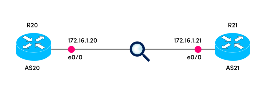

    In this section, we will demonstrate how to configure BGP in a lab environment and look under the hood with Wireshark to see how BGP states come into play.
    We have already pre configured our two routers with IP addresses and verified connectivity.
    Next, we configure BGP on R20 and specify its neighbor.

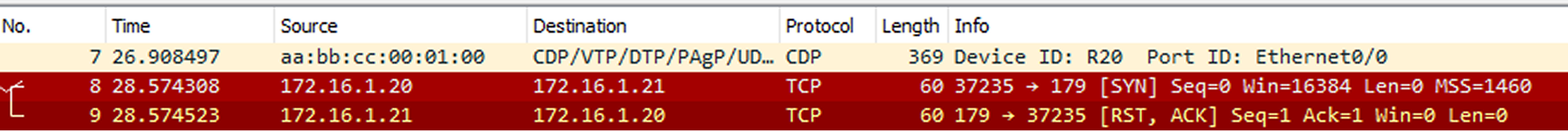

    At this point, we can see how R20 is trying to establish a TCP session, but it’s failing as we haven’t configured R21 yet.

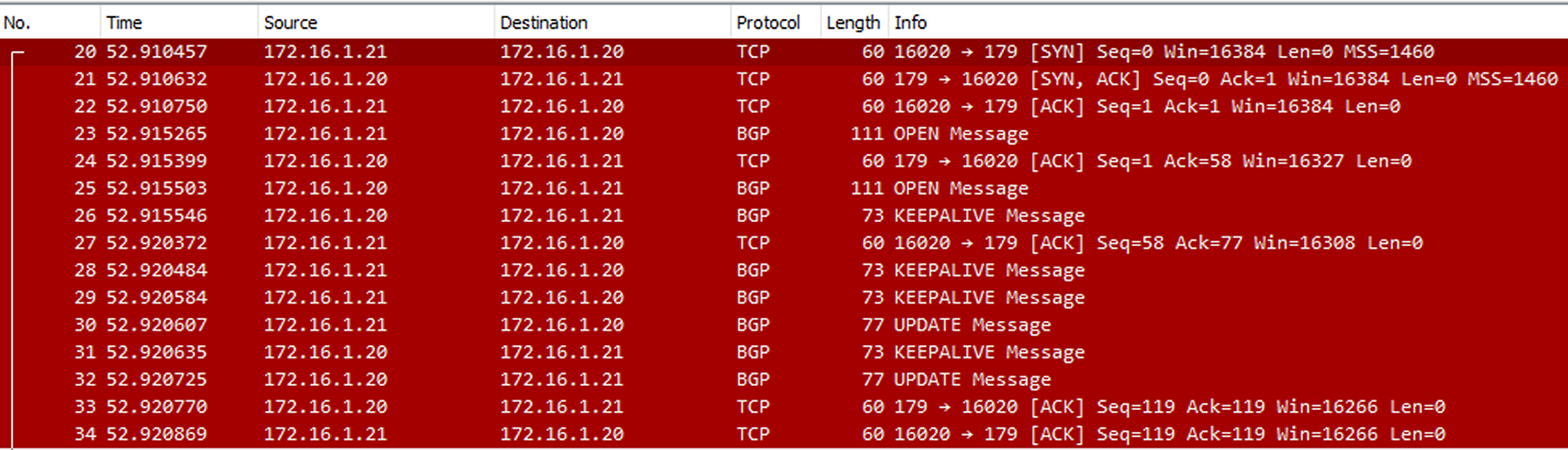

    Inspecting the traffic in Wireshark, we can see some of the states and messages we discussed earlier. This is the best-case scenario when the BGP connection is brought up smoothly:
    • TCP connection
    • Open message
    • Keepalive/Update messages

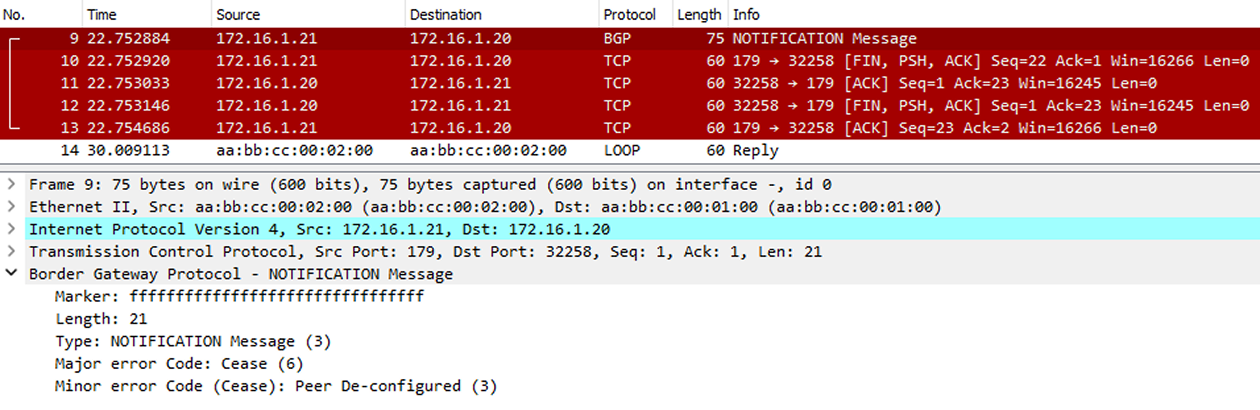

    Now suppose something happens and tears the BGP session down. We will simulate that with the command below.
    R21(config-router)#no neighbor 172.16.1.20 remote-as 20
    *Apr 10 21:57:32.632: %BGP-3-NOTIFICATION: sent to neighbor 172.16.1.20 6/3 (Peer De-configured) 0 bytes
    R21(config-router)#
    *Apr 10 21:57:32.638: %BGP_SESSION-5-ADJCHANGE: neighbor 172.16.1.20 IPv4 Unicast topology base removed from session  Neighbor deleted
    *Apr 10 21:57:32.638: %BGP-5-ADJCHANGE: neighbor 172.16.1.20 Down Neighbor deleted
    R21(config-router)#
    Now R21 sends a Notification message to R20 along with a FIN message to cut the TCP session.

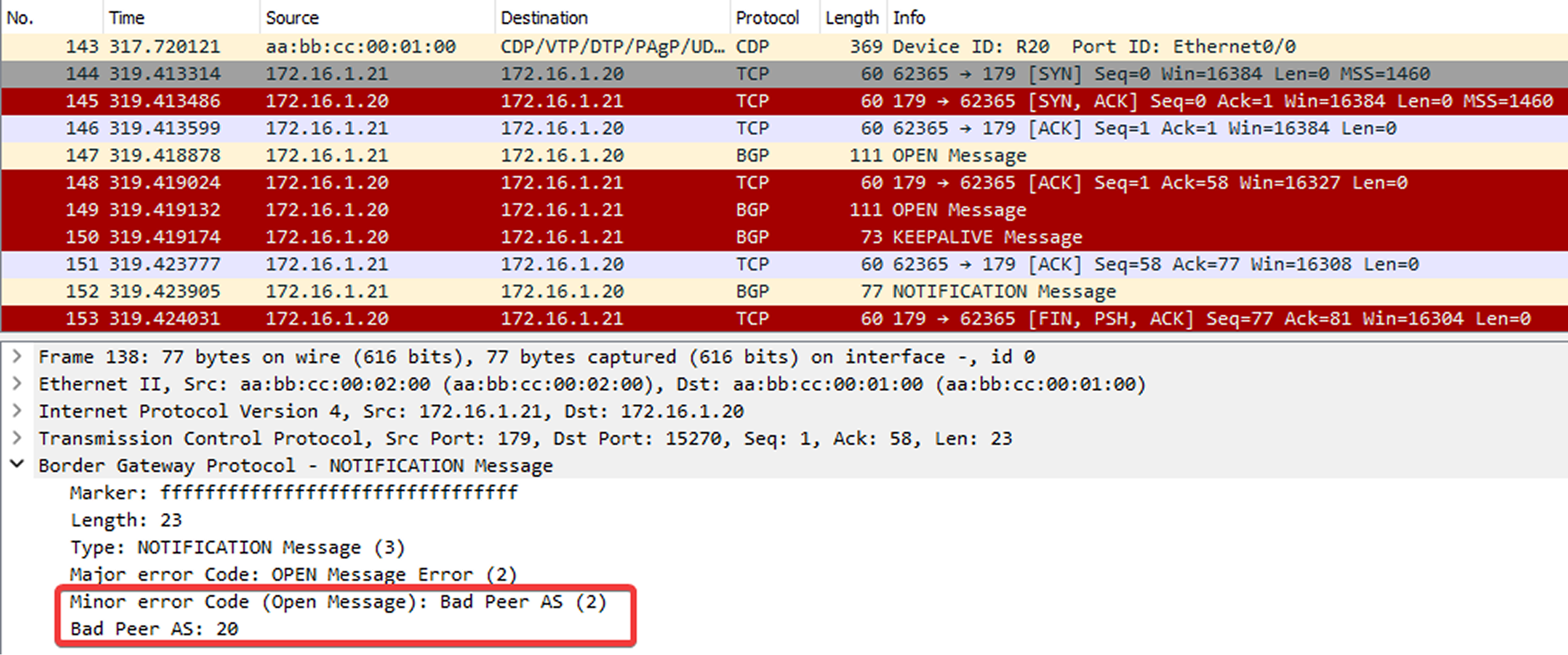

    Now suppose we configure R21 to expect an iBGP session (same AS) instead of eBGP (different AS). R20 is still in AS20, but R21 will expect it to be in AS21.
    R21(config-router)#neighbor 172.16.1.20 remote-as 21
    R21(config-router)#
    *Apr 10 21:58:45.113: %BGP-3-NOTIFICATION: sent to neighbor 172.16.1.20 passive 2/2 (peer in wrong AS) 2 bytes 0014
    R21(config-router)#
    *Apr 10 21:58:45.113: %BGP-4-MSGDUMP: unsupported or mal-formatted message received from 172.16.1.20:
    FFFF FFFF FFFF FFFF FFFF FFFF FFFF FFFF 0039 0104 0014 00B4 AC10 0114 1C02 0601
    0400 0100 0102 0280 0002 0202 0002 0246 0002 0641 0400 0000 14
    R21(config-router)#
    *Apr 10 21:58:49.211: %BGP-3-NOTIFICATION: sent to neighbor 172.16.1.20 active 2/2 (peer in wrong AS) 2 bytes 0014
    We get another Notification message saying Bad Peer AS.

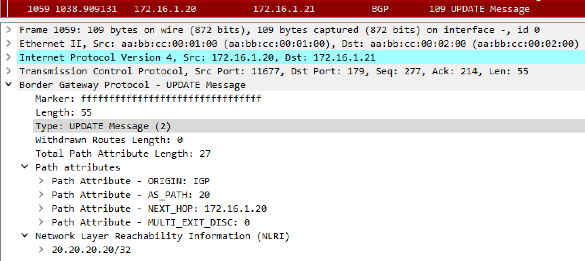

    Next, we fix that and get BGP back to working order. Now we decide to create a loopback address and advertise it over BGP.
    R20(config)#interface loopback 1
    R20(config-if)#ip address 20.20.20.20 255.255.255.255
    *Apr 10 21:51:48.312: %LINEPROTO-5-UPDOWN: Line protocol on Interface Loopback1, changed state to up
    R20(config-router)#network 20.20.20.20 mask 255.255.255.255
    R20 sends an Update message to its neighbor with the new prefix.
