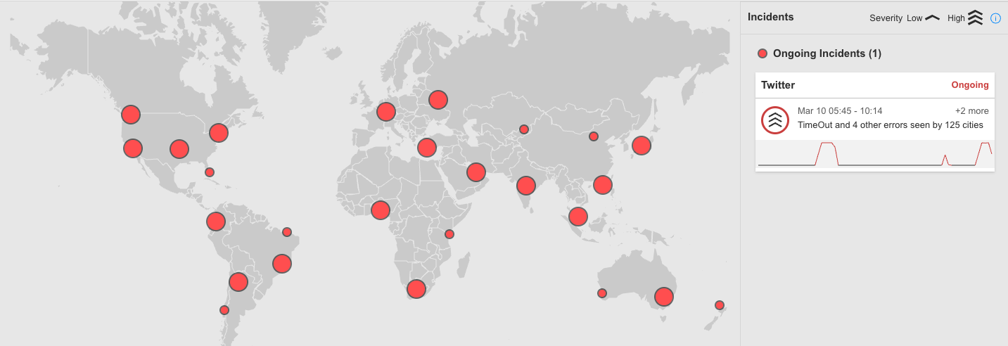

Internet Sonar detected multiple outages for X in real time as the disruptions unfolded. Multiple X-related domains were unable to deliver content. These domains are often used to load content on other websites (known as “child requests”). The widespread failures seen across many locations demonstrate how extensively the outage disrupted X and other websites relying on X’s infrastructure.

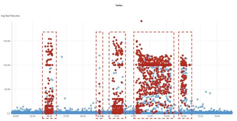

Scatterplot of X’s service disruption
The scatterplot above shows multiple tests run against X Corp’s domains throughout the outage period. The clusters of red dots highlight moments when tests consistently failed or timed out. Each cluster corresponds with one of the outage waves, clearly illustrating the recurring and widespread nature of X’s connection issues during this incident.

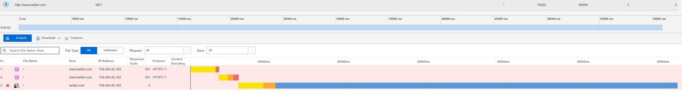

Waterfall chart from Catchpoint’s portal
The waterfall chart above shows that X’s servers could initially be reached, but response times were severely degraded. Eventually, these requests timed out completely, meaning the servers failed to deliver the requested content. This illustrates the delays users experienced during the outage.

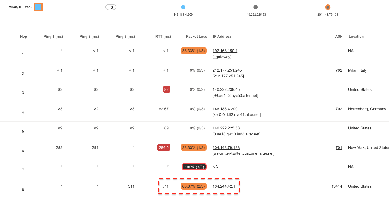

Traceroute data from Catchpoint’s portal
The traceroute data above shows significant issues during the outage, particularly large packet losses and high round-trip times (RTT). High packet loss means that data sent to X’s servers was frequently lost along the way, while increased RTT indicates that responses from X’s servers were severely delayed. Both clearly illustrate why users experienced sluggish performance during the outage.

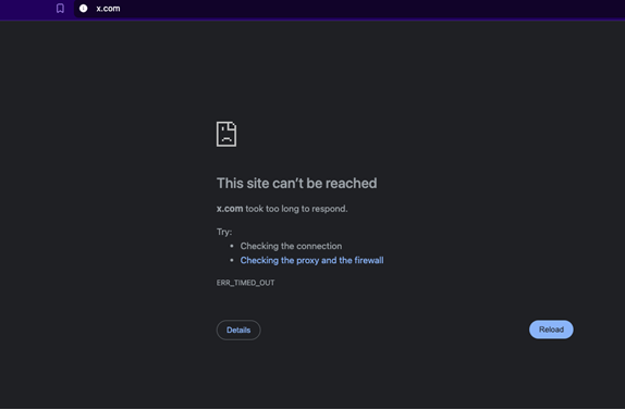

Screenshot showing a typical user experience during the outage on x.com

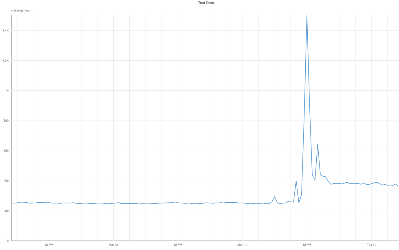

CEO Elon Musk attributed the outage to a DDoS (Denial of Service) attack. Independent monitoring data showed patterns consistent with that explanation, though monitoring alone can’t confirm the root cause definitively.
Wait time data over three-day period
Data collected over an extended baseline for X Corp’s domains shows that during the outage there was a notable spike in mean wait time. This suggests the servers were slower to respond, an effect that aligns with what typically occurs during a DDoS attack. The elevated wait times, combined with significant packet loss and degraded response patterns observed across multiple geographies, are consistent with a volumetric attack. However, similar symptoms can also result from infrastructure misconfigurations or capacity failures under unexpected load.

Internet Sonar’s map view above shows how widespread the disruption was, with outages reported across multiple locations around the globe.
