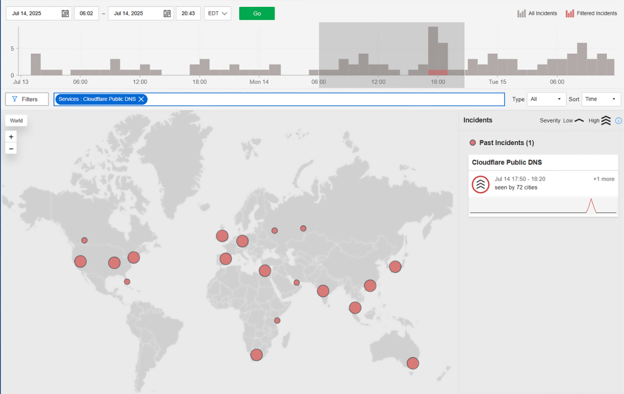

At 21:50 UTC on July 14, Catchpoint detected a sharp and sudden spike in DNS query failures targeting Cloudflare’s public resolver, 1.1.1.1, through Internet Sonar.
Internet Sonar dashboard visualizing DNS failures in real time

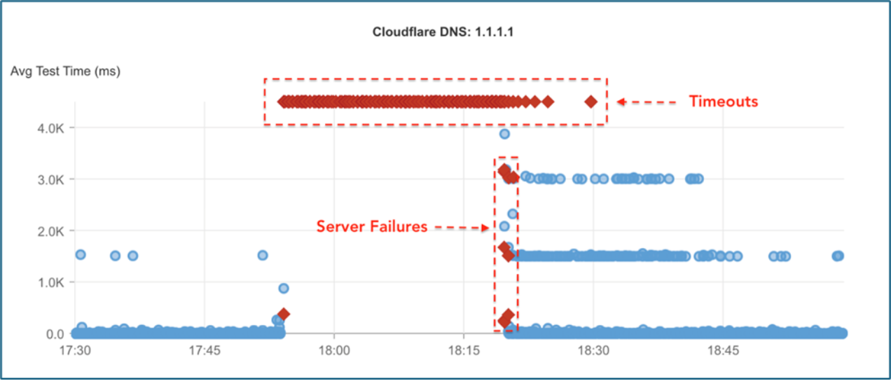

From every angle, it looked like a DNS outage: query timeouts, and toward the end of the incident, ServFail errors.
Scatterplot data indicating failures due to timeouts and server failures.
But the DNS servers themselves weren’t malfunctioning. The real problem was upstream: Cloudflare’s internal misconfiguration had withdrawn the BGP routes that made 1.1.1.1 reachable in the first place. Without valid routes, DNS queries couldn’t reach Cloudflare’s resolvers, regardless of how healthy those resolvers were.

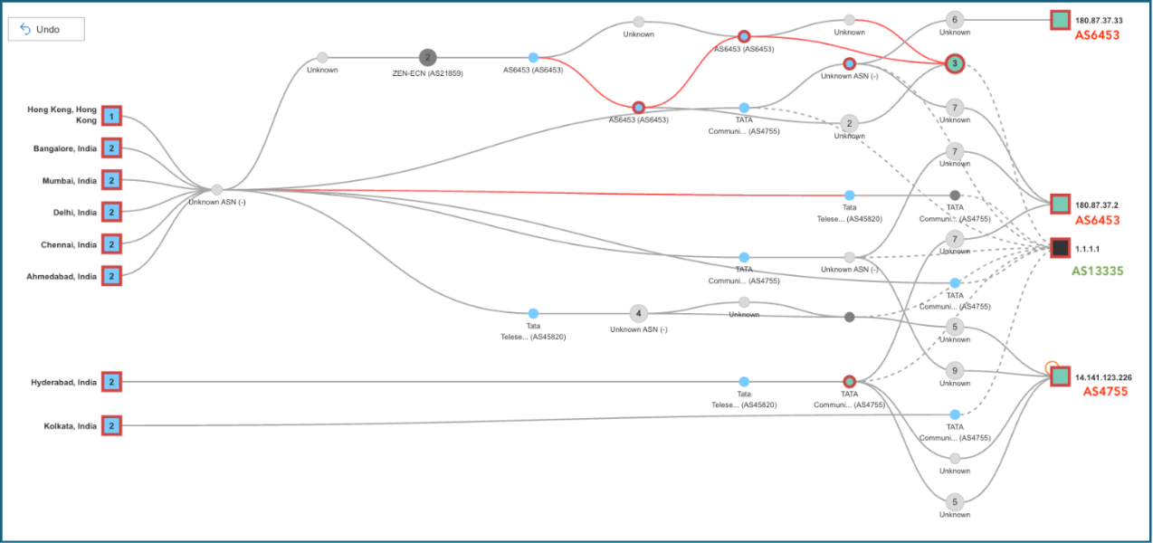

When Cloudflare withdrew its routes for 1.1.1.0/24, something else became visible. AS4755 (Tata Communications India) started advertising that same prefix. In Catchpoint’s BGP monitoring data and RouteViews collectors, the hijacked route appeared and propagated through Tata’s global backbone (AS6453) to many networks worldwide.
Sankey chart indicating the traffic intended to 1.1.1.1 is routed to other destination IPs
This traceroute visualization tells the story. Each hop is grouped by its Autonomous System Number (ASN) to show how traffic flowed, or failed to. Cloudflare’s legitimate origin ASN (AS13335) is visible where valid routes remained, but many traceroutes didn’t make it there. A significant number of tests failed with “no route” errors, confirming that the legitimate path had been withdrawn. Others exposed the propagation of the hijacked prefix via unauthorized AS paths.
Cloudflare’s post-mortem is explicit on this point: “this BGP hijack was not the cause of the service failure, but an unrelated issue that was suddenly visible as that prefix was withdrawn by Cloudflare.” The hijack was pre-existing and latent. It only became visible because Cloudflare’s own routes were no longer there to mask it.
This adds a layer to the story that makes it more instructive, not less. It shows how quickly latent routing issues can compound when legitimate routes are withdrawn, even briefly.

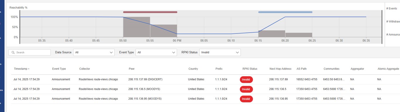

RPKI knew it was wrong. Most Networks Didn’t Act on It.
While Cloudflare had a valid ROA for 1.1.1.0/24, the hijacked route originated by AS4755 was clearly marked as RPKI Invalid.
The chart shows a batch of these invalid announcements, captured by Catchpoint’s platform (through RouteViews collectors) from peers in the United States. Despite being invalid according to the ROAs, the announcements were accepted and propagated by networks including AS6453.
During this period, many nodes withdrew the valid route via Cloudflare’s ASN (AS13335). Some lost reachability entirely, while others adopted the hijacked route pointing toward AS4755. Several ISPs like Lumen and AT&T had no routes at all for 1.1.1.0/24, suggesting they honored RPKI filtering and dropped the invalid announcements from Tata. However, it’s unclear why there were no other paths for 1.1.1.0/24 during that window. Under normal circumstances, Cloudflare’s own announcements would reach these networks.
Cloudflare was careful enough to create a proper ROA stating that the prefix hosting their DNS service can be originated only by Cloudflare’s AS number (AS13335), as can be seen here. Tata itself is known to apply filtering based on RPKI, as Cloudflare states on the Is BGP safe yet? website. An open question remains: why did Tata’s RPKI filtering not catch this announcement? One possibility is that filtering was not applied to routes originated by AS numbers within their own group, but Cloudflare’s post-mortem notes only that they are “following up with Tata Communications.”

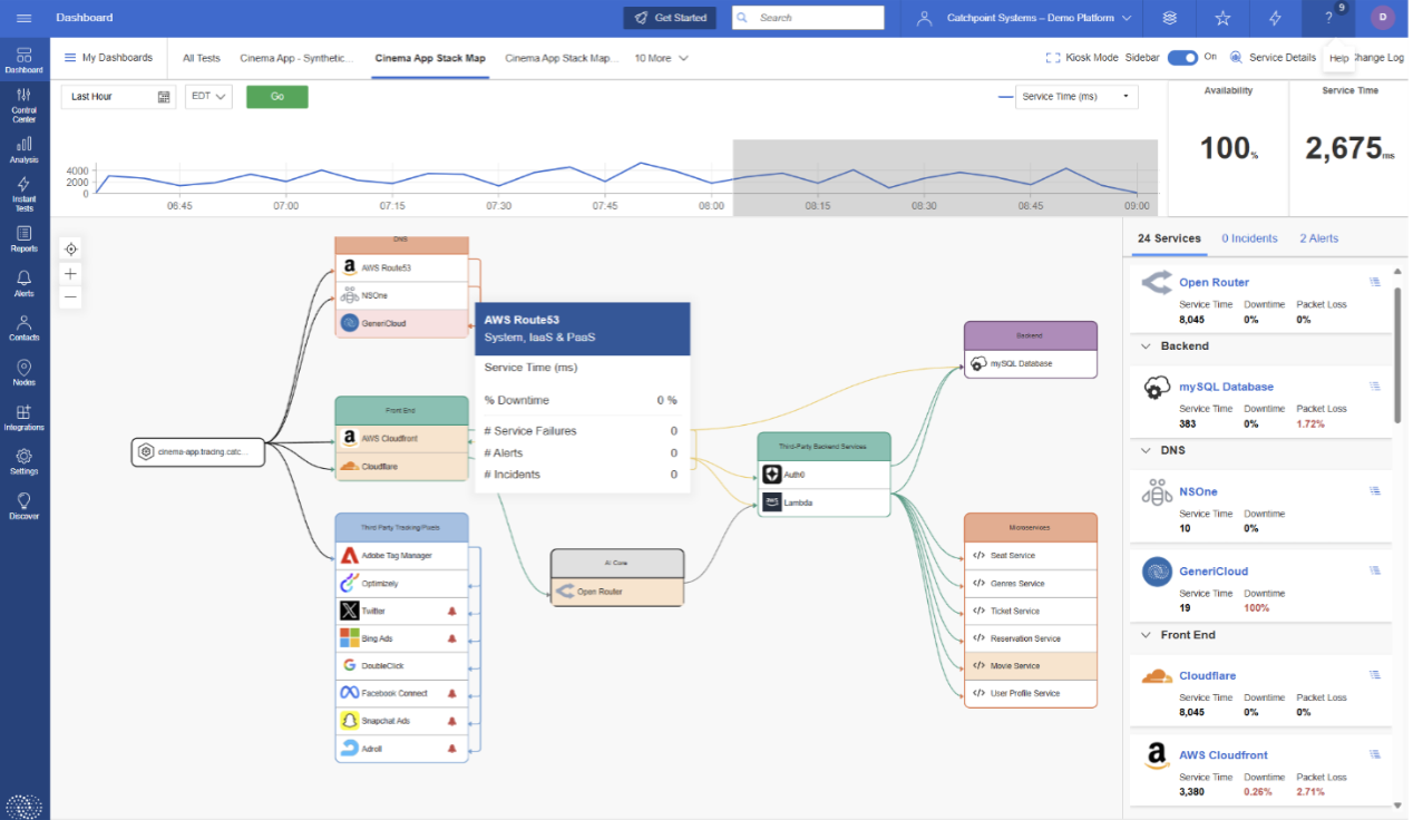

Monitor the Full Internet Stack, Not Just Your Own Systems
Mission-critical services depend on external systems like DNS, BGP, and transit networks. DNS is a single point of failure: if it breaks, nothing works, regardless of how healthy your backend is. Public resolvers like 1.1.1.1 are foundational to connectivity, and when they become unreachable, even healthy services appear broken. A thorough monitoring strategy covers the entire Internet Stack, including protocols like BGP and DNS. This is where LM Internet Performance Monitoring becomes essential, giving teams visibility into the layers of the Internet that sit outside their direct control but directly affect end-user experience. After all, your customers won’t know it’s Tata or Cloudflare’s fault. They’ll blame you.
A visual representation of the Internet Stack
