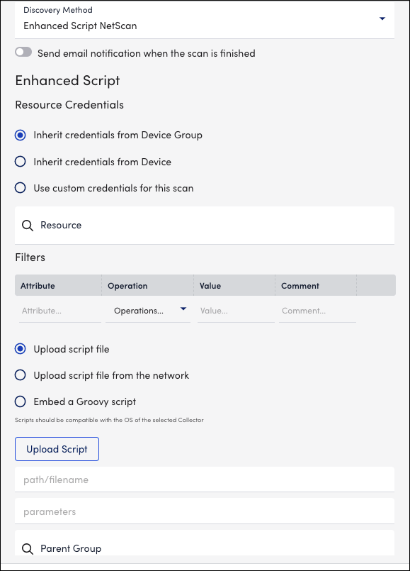

  5. Select Enhanced Script Netscan from the Method drop-down list.
  6. From Device Credentials, select one of the following options:
    • Inherit credentials from Device Group
    • Use custom credentials for this scan – Select Add [+] to provide a property and property value. You can select a property from the provided list or type a custom key name.
Note: These properties can be accessed for use in the script using netscanProps.get(“property.key”). To add any of these properties to the resources, include them in the JSON structure for the device under the hostProps field. For more information, see Script Formatting.
  1. In the Filters section, exclude a resource or resources from the scan. Filtering is based on the device attributes and values that are assigned in the Netscan script.
  2. To supply a script, select one of the following methods:
    • Upload script file – Select Upload Script to upload a script from your local machine.
    • Upload script file from the network – Enter a path/filename to upload a script from a network location.
    • Embed a Groovy script – Paste the Groovy script into the field provided. For more information, see Script Formatting.
    • Note: Consider leveraging Groovy scripts for more complex automation and customization of NetScan.
  3. In the Parent Group field, enter a Default Group. If a group is not specified in the script output, the resource will be added to the Default Group. If a group is specified in the script output, the Default Group is ignored.
  4. You can Exclude Duplicate IP Addresses from the NetScan by selecting one of the following options:
    • Matching any monitored resources/devices — Excludes any discovered resource with the same IP address as a resource that is already being monitored.
    • Matching resources/devices already discovered by this NetScan— Excludes any discovered resource that has already been moved into monitoring by this NetScan.
    • Matching resources/devices in these resource groups— Excludes any discovered resource with the same IP address as a resource belonging to a specified resource group. When this option is selected, an additional field appears so that you can specify one or more resource groups.
    • Matching resources/devices currently assigned to these Collectors— Excludes any discovered resource with the same IP addresses as a resource that is assigned to a specified collector. When this option is selected, an additional field appears so that you can specify one or more collectors.
  5. Enable the Run this NetScanon a schedule checkbox to run the Enhanced Script Netscan on a schedule.
    • Frequency— Hourly, daily, weekly, or monthly.
    • Start time— Enter the start time in the field provided.
    • Time Zone— Select a time zone from the Event time zone pop-up window.
  6. Do one of the following to save the scan:
    • Select Save and Run to save your changes and run the Netscan.
    • Select Save to save the Netscan without running it.
