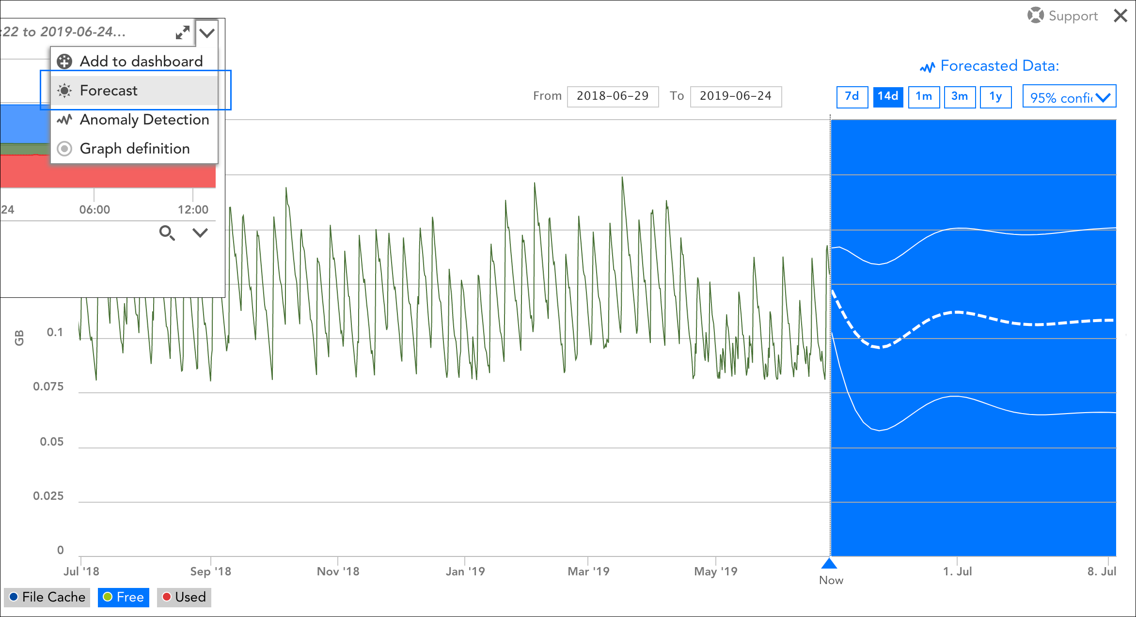

  1. In LogicMonitor, navigate to Resource Tree> select a required resource> Graphs tab.
    Alternatively, you can access the Data Forecast graph from Alerts, Dashboards, or Services.
  2. Select more iconand then View Forecast on the top-right corner of the graph.
    The data forecast page displays the previously collected data and the forecasted data.
    Data forecast page
  3. From the Datapoint dropdown menu, select the required datapoint for which you want to view the data forecast.

  1. From the Forecasted data dropdown menu, select the duration of the forecast.
  2. From the Algorithm menu, select one of the following:
    1. Line of best fit forecast (default)—This method draws a single straight line that best fits forecasted data. This is generally a more useful option if your datapoints are highly variable.
    2. 95% confidence forecast—This method projects lines that represent forecast values (the middle, thick dashed line), as well as upper and lower confidence bounds. These confidence bounds indicate that LogicMonitor is 95% confident that future datapoint values will fall within this range.
  3. From the Time range dropdown menu, select a time range for the collected data (training data) that will be used as the basis for the forecast.
