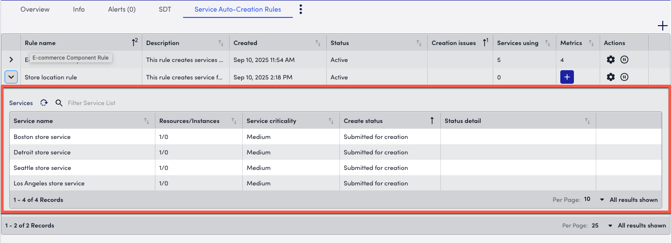

You can select an individual service from the service auto-creation rules table to view the details of the services created by a rule.
Viewing Services Created by a Rule
The details of services created by a rule table display the following details:
Column NameDescription
Service nameDisplays the name of the service created from the rule.
Resources/InstancesDisplays the resources and instances included in the service.
Service criticalityDisplays the criticality level of the service defined during rule creation.
Create StatusDisplays the creation status as follows:
Creation-related
• Yet to be Created
– The service is scheduled for creation in the next rule execution.
• Submitted for Creation – The Service  is queued for creation.
• Creation in Progress – Service is currently being created.
• Created – Service was successfully created.
• Creation Failed – The Service creation failed.
• Service Renamed – The service was successfully created, but the name conflicted with an existing service so it is renamed.
Deletion-related
• Submitted for Deletion
– Service is queued for deletion.
• Deletion in Progress– Service deletion is ongoing.
• Deletion Failed– Failed to delete the service.
• Deleted– Service successfully deleted.
• Yet to be Deleted– Service is scheduled for deletion in next execution.
Status DetailDisplays provides additional information about why a service is in its current state or what happened during execution.
Note: Use the search field to filter the Services list.
