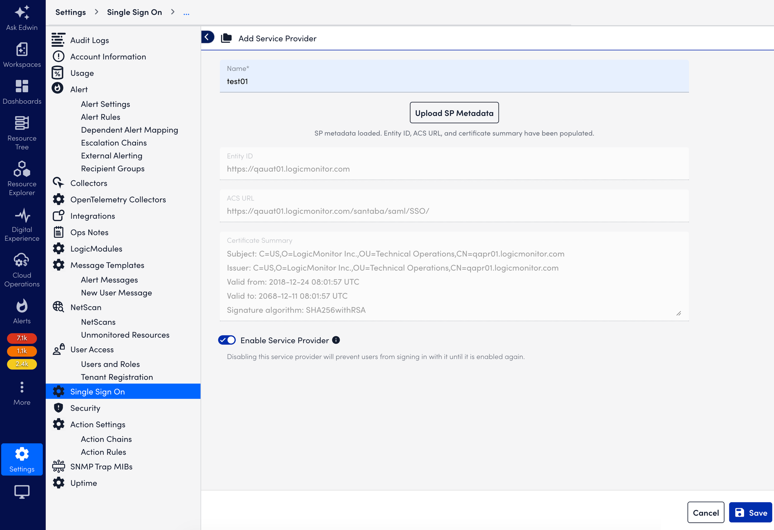

  1. LogicMonitor, navigate to Settings > Single Sign On.
  2. Select the Service Providers tab.
  3. Select Add icon to Add Service Provider.
  4. In the Name field, enter a name for the configuration.
  5. Select Upload SP Metadata, and select the Service Provider metadata file.
    LogicMonitor populates the following information from the uploaded metadata:
    • Entity ID
    • ACS URL
    • Certificate Summary
      For more information about downloading the Service Provider Metadata, see Enabling Single Sign-On.
  6. Toggle Enable Service Provider switch.
  7. Select blue save icon Save.
    The service provider configuration is saved.
