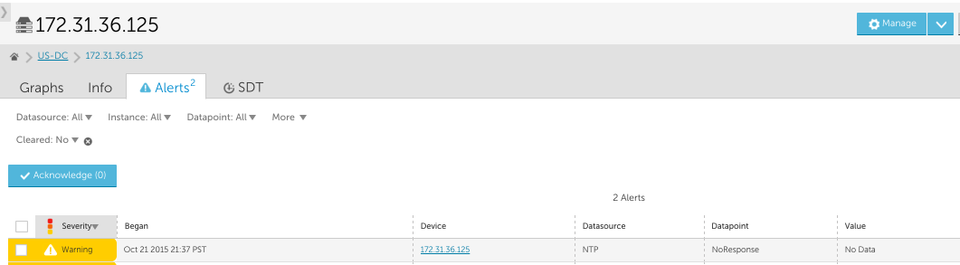

When you have NTP installed, the instances generated by the LogicMonitor NTP datasource can display any offset between device clocks. If NTP is not properly configured, you may instead get an alert like the one below:
The NTP datasources use the ntpq binary command installed on the Collector host. To troubleshoot NTP, you can use the command ntpq -nc peers Host, where Host is the name or IP address of each device you are keeping in sync. Use the following legend to determine its NTP status:
