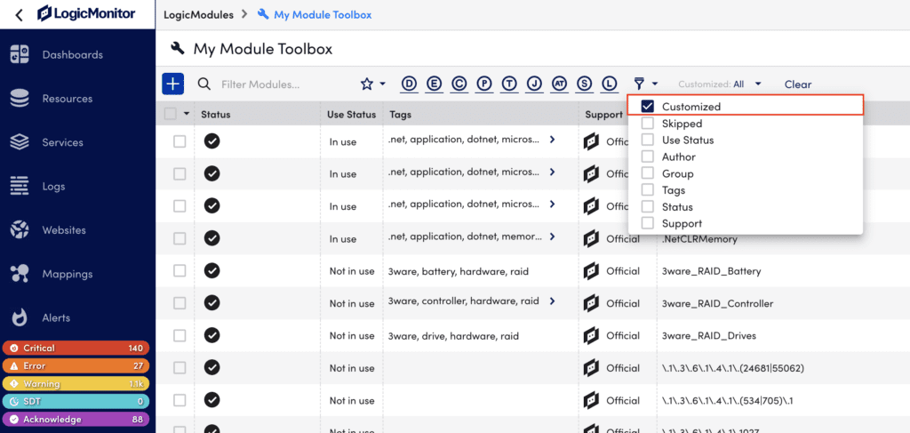

  3. To identify customized modules, do the following:
    1. From the Add Filter menu, select Customized.
      Customized option in add filter page

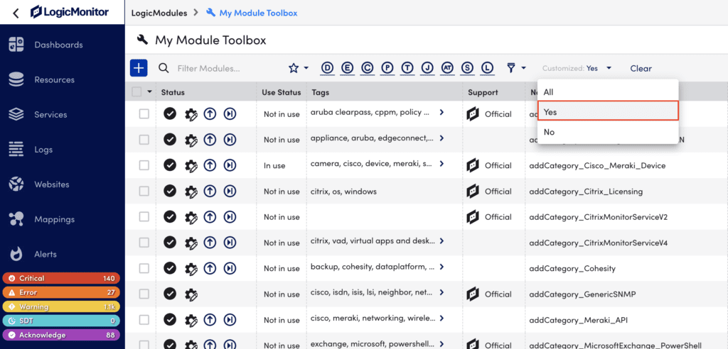

    2. From Customized, select Yes.
      All customized modules will populate.
      Support filter for My Module toolbox page

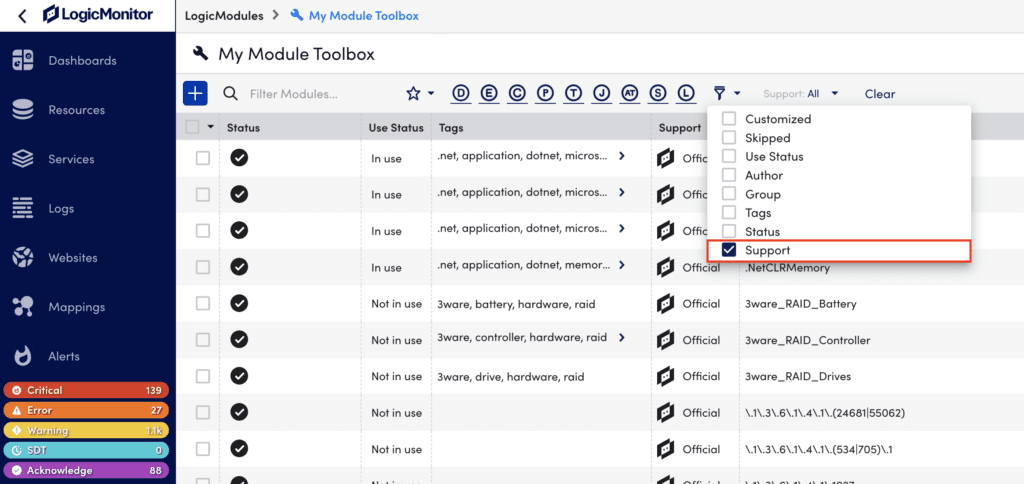

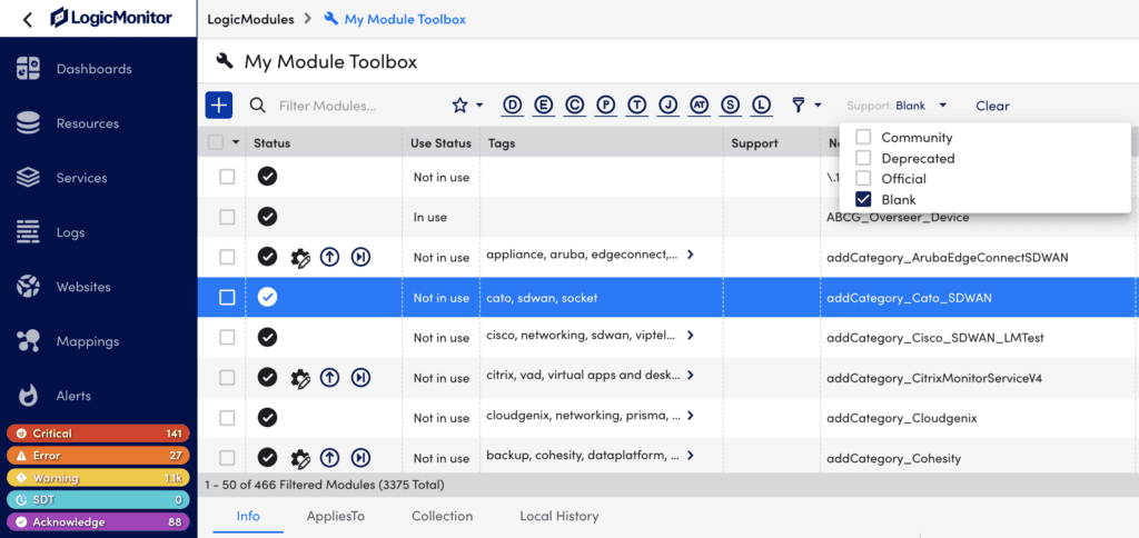

  4. To identify custom modules, do the following:
    1. From the Add Filter menu, select Support.
      Support option filter for My Module toolbox page
    2. From the Support menu, select Blank.
      All custom modules will populate.
      blank option for My Module toolbox page

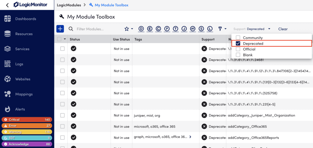

  6. To identify Deprecated modules, do the following:
    1. Select Support.
    2. From the Support menu, select Deprecated.
      All deprecated modules will populate.
      deprecated option for My Module toolbox page

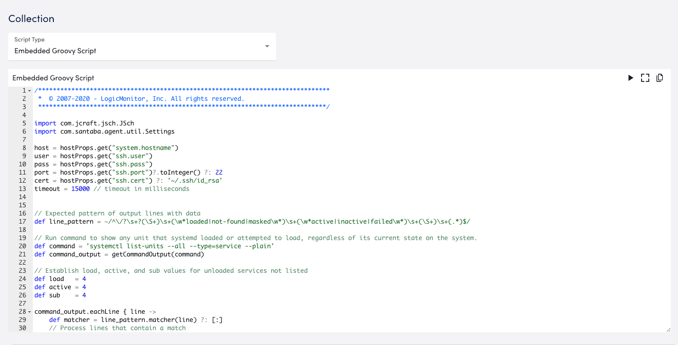

  3. Do the following to test the module with Groovy 2:
    1. In the module editor, select the Collection tab, and add the following comment to the Embedded Groovy Script as the first line:
//!/lib-groovy/v2
println "version=" + GroovySystem.version
  1. Select Test Script run Test script icon.
    test script page

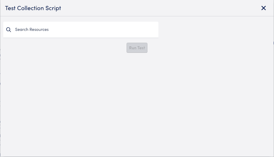

  2. In the Search Resources field, of the Test Collection Script dialog, enter or search for a resource to test the script.
    test collection script modal
  3. Select Run Test.
    The test results display in he Test Collection Script dialog.

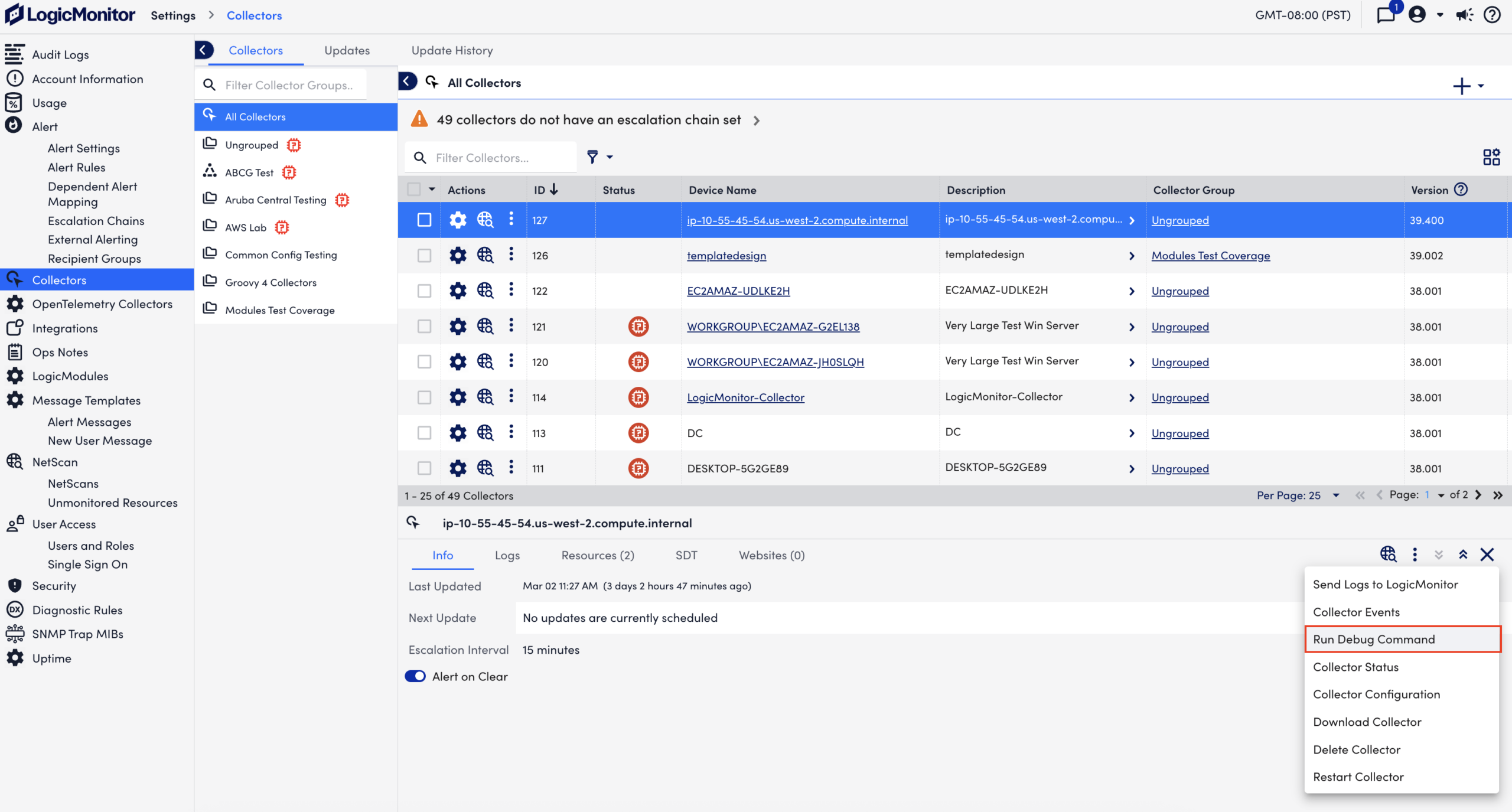

  1. In LogicMonitor, navigate to Settings > Collectors and select the collector monitoring resource you are using for testing.
  2. From the Collector details panel, select More > Run Debug Command.
    A separate debug window opens.

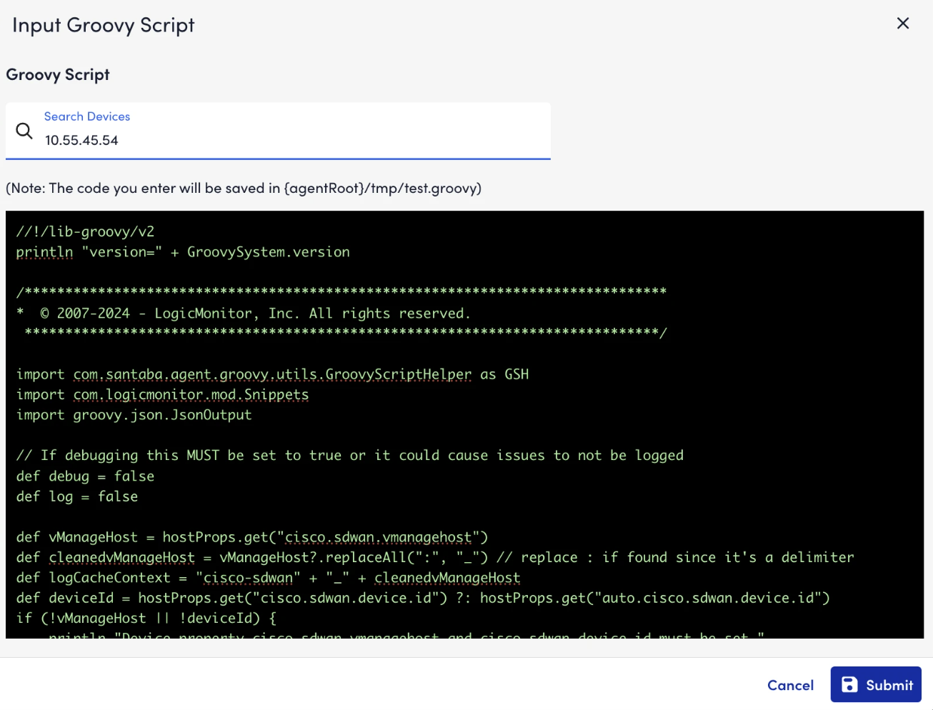

  3. To test the module with Groovy 2, do the following:
    1. In the collector debug window, run the following command: !groovy
      A dialogue box opens.
    2. In the Input Groovy Script dialogue box, paste in the module’s code, then add the following lines to the beginning of the script:
      //!/lib-groovy/v2
      println "version=" + GroovySystem.versionCopy
    3. In the Search Devices field, select a resource from the dropdown menu or manually type the resource into the field to select it.
    4. Select Submit.
      The test results display in the collector debug window.
