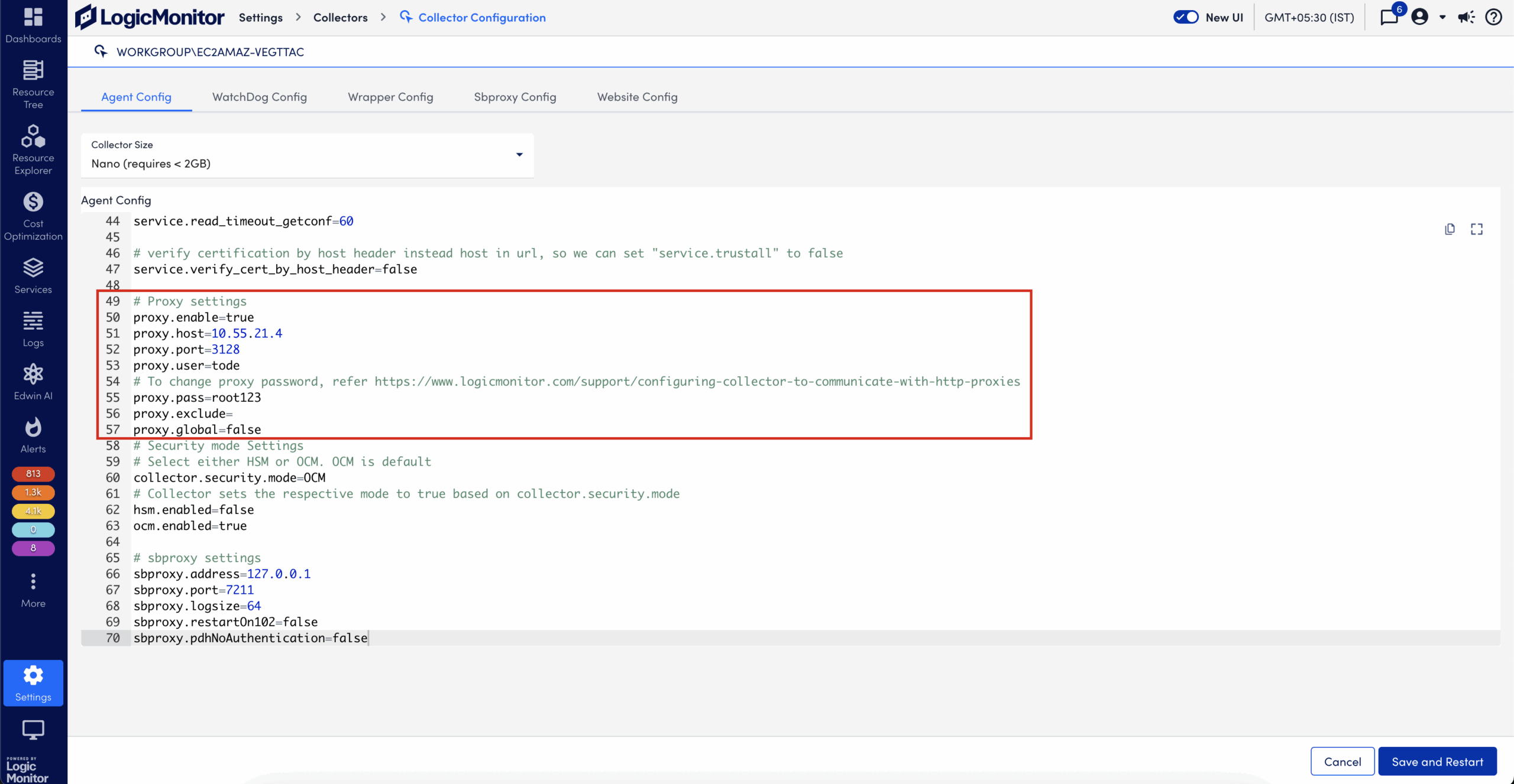

Changing Proxy Password
If a proxy server has password-based authentication, its credentials are stored in the proxy.user and proxy.pass fields. The proxy password is encrypted.
  1. In LogicMonitor, navigate to Settings > Collectors.
  2. In the Collectors tab, select a Collector to configure.
  3. Select More icon More and then select Collector Configuration.
    Collector configuration option
    On the Collector Configuration page, the agent.conf settings are displayed.
  4. Scroll to locate the proxy settings.
  5. Enter a new password in plain text in the proxy.pass field.
    Proxy setting with plain text password
  6. Select Save and Restart.
