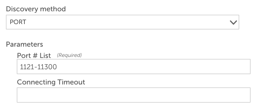

Example – Memcached detection
If you run multiple Memcached instances on devices, or run Memcached on different ports on a variety of devices, you can use the port method to detect and monitor them automatically. You want to monitor the Memcached application on any device that responds on any port from 11211 through 11300. You could modify the standard Memcached datasource to detect and monitor all such instances by using port method of Active Discovery:
If Memcached is running on a host on ports 11211, 11230 and 11231, the above Active Discovery configuration will return 3 instances, corresponding to each of the ports that respond.
