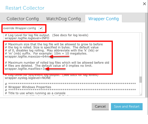

Modifying Log File Retention Property
Collector log files are rotated based on size, and not date. By default, there are 3 log files of 64M each. If you’d like to change these numbers, you can do so in the wrapper.conf file (in the conf directory) where the collector is installed. You can edit the wrapper.conf file in the conf directory on the collector machine itself, or you can edit the file directly from your LogicMonitor account UI.
  1. In LogicMonitor, navigate to Settings > Collectors.
  2. Under the Collectors tab, select the collector whose log file retention property you want to modify.
  3. Select the More option and then select Collector Configuration.
  4. Select the Wrapper Config tab and locate the Wrapper logging properties and
  5. Modify the values in the wrapper.logfile.maxsize and wrapper.logfile.maxfiles properties.
    wrapper config page
  6. Select Save and Restart to apply the changes.
