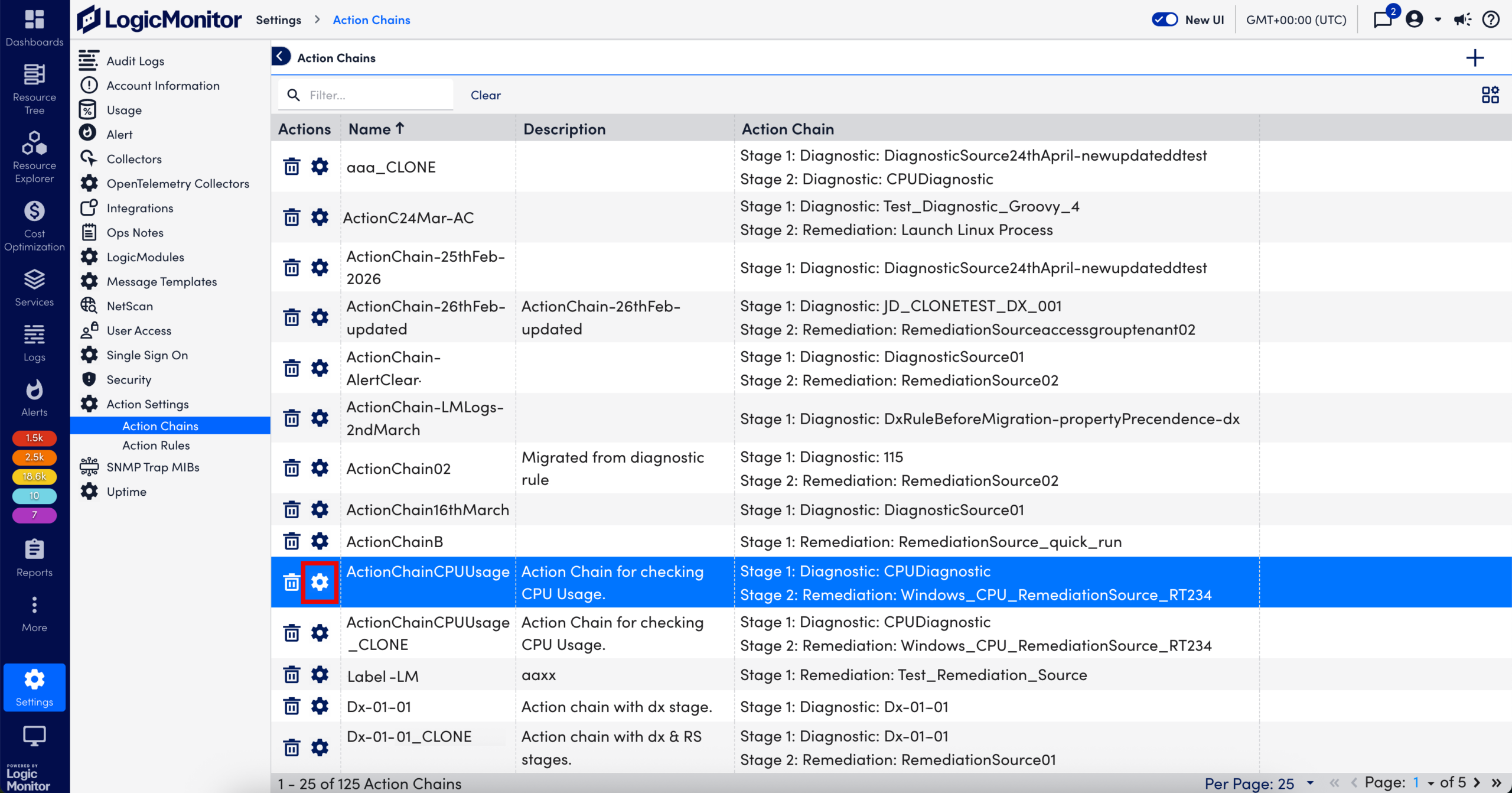

Editing Action Chains
  1. In LogicMonitor, navigate to Settings > Action Settings > Action Chains.
    The Action Chains page displays.
  2. In the Actions column, select Manage Action Chains icon Manage for the Action chain that you want to edit.
    Action Chains page
    The Manage Action Chains page displays.

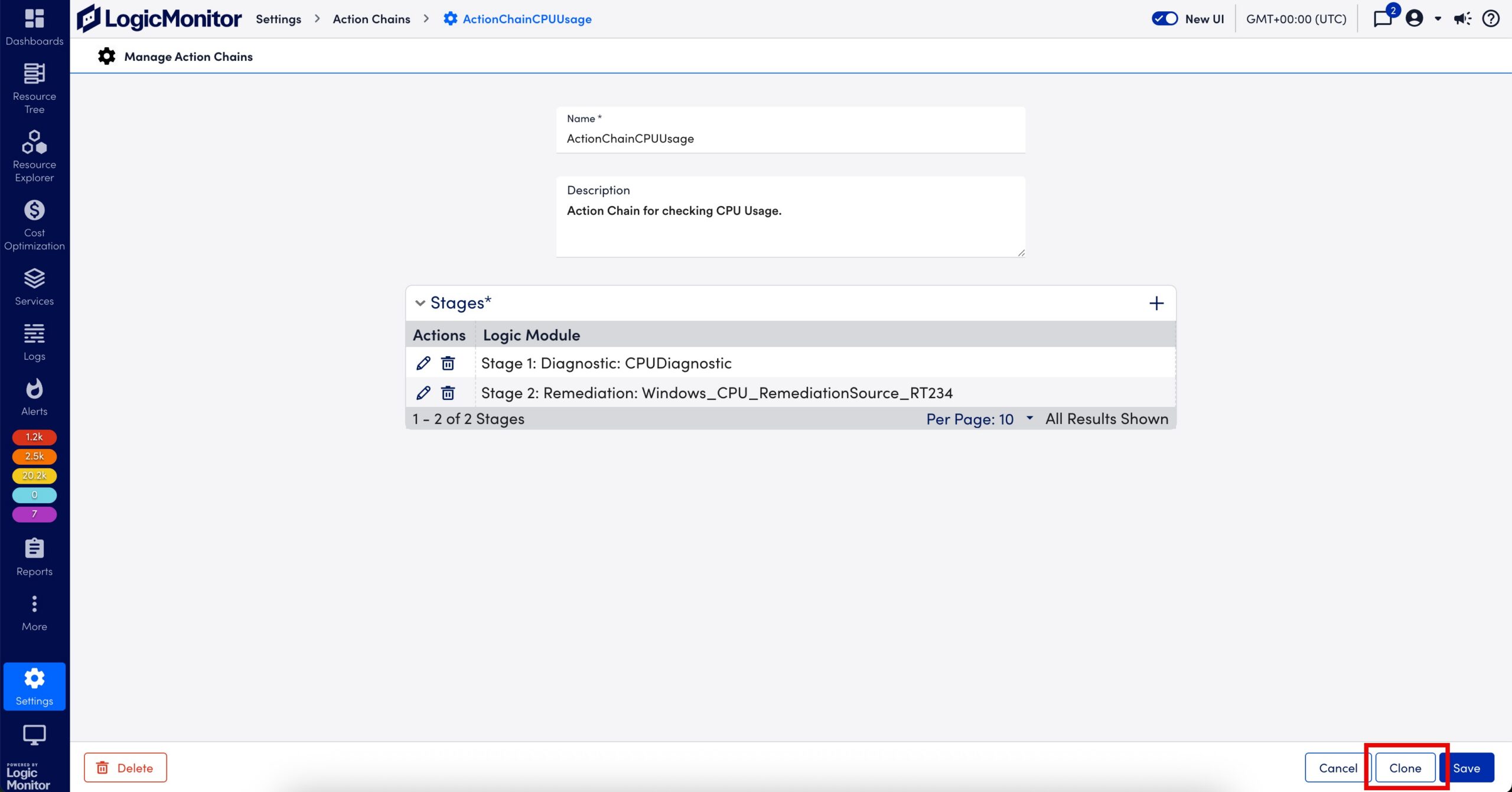

Cloning Action Chains
  1. In LogicMonitor, navigate to Settings > Action SettingsAction Chains.
  2. In the Actions column, select Manage Action Chains icon Manage for the Action chain that you want to clone.
    Manage Action Chains page with Clone option

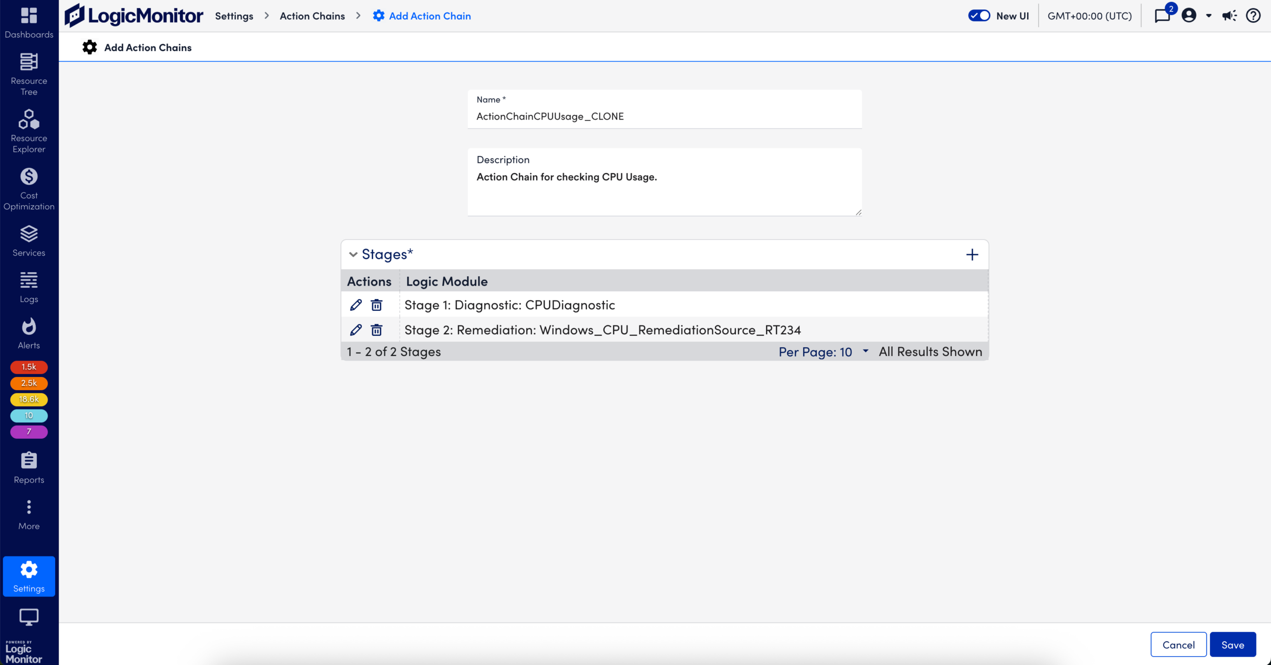

  3. Select Clone.
    LogicMonitor creates a copy of the Action chain with _CLONE appended to the original Action chain name.
    Clone Action Chain
  4. (Optional) Update the cloned Action chain.
  5. Select Save.
LogicMonitor adds the cloned Action chain to the Action Chains page.

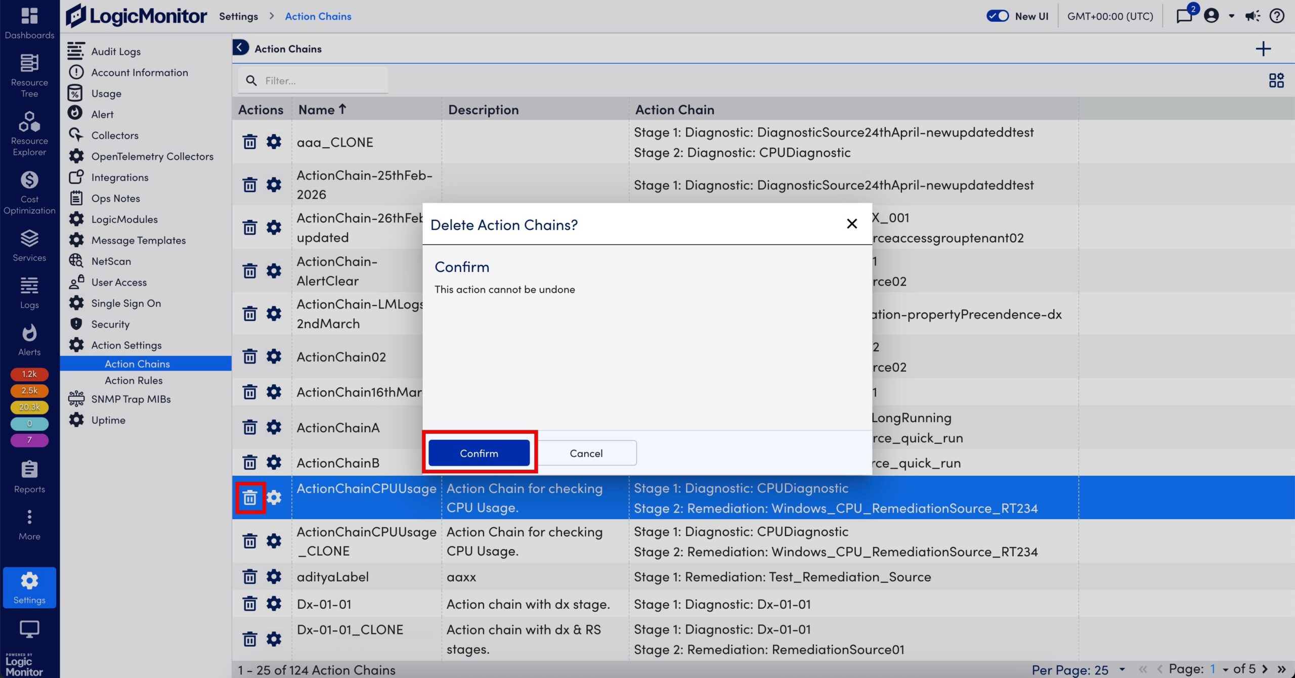

Deleting Action Chains
  2. In the Actions column, select Delete Action Chains icon Delete for the Action chain that you want to delete.
    A confirmation message displays.
    Delete Action Chain Confirmation Dialogbox
  3. Select Confirm.
LogicMonitor deletes the Action chain and displays a success message.
Note: Alternatively, on the Manage Action Chains page, select Delete, and then confirm the deletion when prompted.
