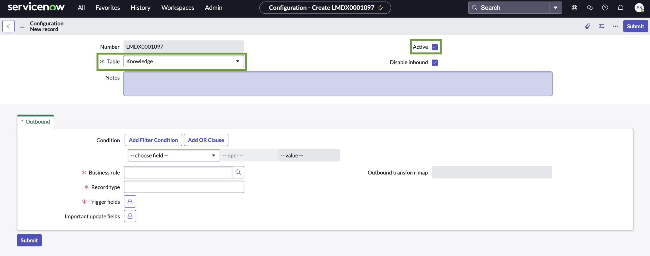

Enabling LDMX Knowledge Article Ingestion for the Knowledge Base Agent
  1. Navigate to the LogicMonitor Data Exchange Configuration page.
  2. Create a new configuration record or update the existing Knowledge configuration.
    Create new configuration record
    The following configuration values are required:
FieldValue
TableKnowledge
ActiveTrue
Disable InboundTrue
For more information, see Configure record creation from the new tab menu in Service Operations Workspace from ServiceNow.

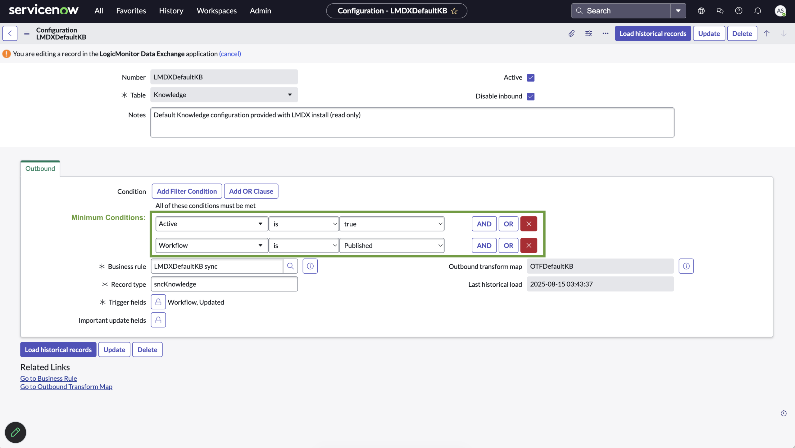

  1. Configure outbound filters to control which Knowledge Articles are sent to LogicMonitor.
    • In the Outbound section of the configuration record, Click Add Filter Condition and add the required minimum conditions: Active equal to True and Workflow equal to Published.
    • You can add additional conditions to scope the dataset based on fields in the kb_knowledge table. Only records that satisfy all configured conditions will be included in the outbound payload.
      For more information on types of LMDX filters, see Configuration Records.
      For more information on filters and how to configure them, see Filters from ServiceNow.
