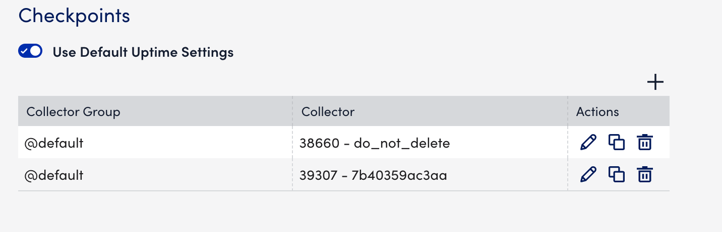

- Select the Checkpoints tab step and specify the Collectors that will send the checks.
The Use Default Uptime Settings toggle is selected by default.
Note: Your user account must have Collector view permissions to view and select Collectors from this area of the dialog. For more information, see LogicMonitor Roles
