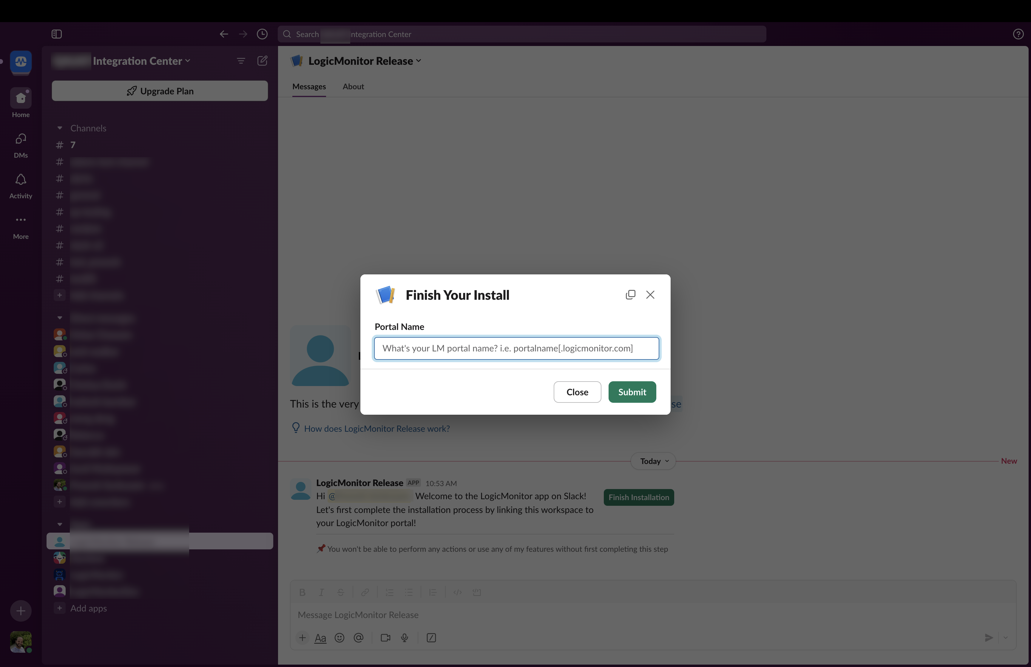

  4. At the Finish Your Install dialog, enter the name of your LogicMonitor portal into the Portal Name field. Your portal name can be found in the first portion of your LogicMonitor URL (for example, https://portalname.logicmonitor.com).
    Installation and Configuration from Slack - Finish Install
  5. Select Submit. The following message is displayed.
