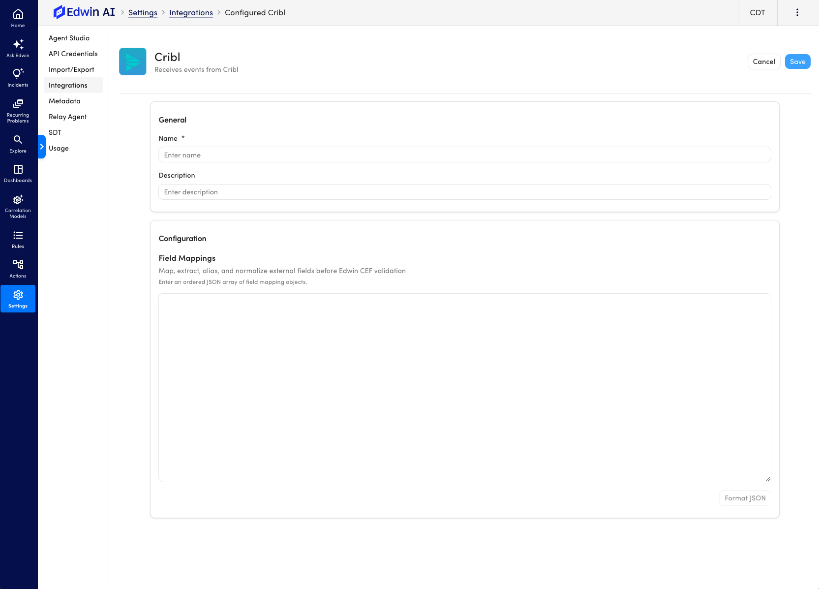

- In Edwin AI, navigate to Settings > Integrations.
- Open the event integration you want to configure.
- Locate the fieldMappings setting.
- Enter the mapping definition in JSON format.
For example, see the following mapping definition:
[{"sourceField":"entity_tags","sourcePath":"cef.sourceRecord","targetPath":"enrichments","type":"JSON_ARRAY","keyValueSeparator":":"},{"field":"eventSeverity","sourceField":"event.status","sourcePath":"cef.sourceRecord","type":"VALUE","mappings":{"CLOSED":0}}]- Save the integration.
- Send a test event and verify the resulting fields.
