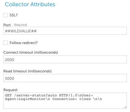

  • SSL: whether to use SSL for the request.
  • port: the TCP port to use for the HTTP or HTTPS traffic.
  • connect Timeout: time the collector will wait for a connection to be established
  • readTimeout: time the collector will wait for data to be returned in response to a request
  • request: the content to send in the HTTP or HTTPS request.  This must be a valid HTTP 1.0 or HTTP 1.1 request.
Use ‘\n’ to send a newline.
Do not include content-length.  This is automatically configured.

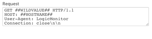

If sending an HTTP1.1 request, you must include the HOST header.  You can use a token for this header- i.e. ##HOSTNAME## to substitute the system the datasource is currently collecting against. e.g.:
Parameters
 If you have a multi-instance datasource with Active Discovery enabled, you may use the ##WILDVALUE## in the Request, instead of as the Port, e.g.:
