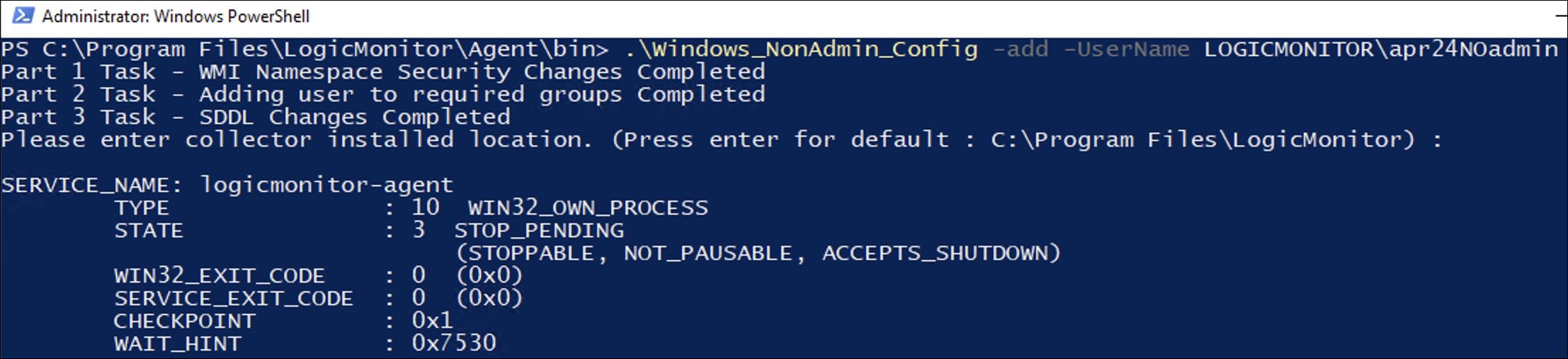

To migrate Windows collector, follow these steps:
  1. Log in to the machine where the collector is already installed with admin credentials.
  2. Open a new Windows PowerShell with admin privileges and go to the Agent\bin folder in the directory where the Windows collector is installed. The default path is C:\Program Files\LogicMonitor\Agent\bin\.
  3. Enter and run the script .\Windows_NonAdmin_Config.ps1 followed by the parameters. The user must be a non-admin user. For example,  .\Windows_NonAdmin_Config -add -UserName LogicMonitor
After you run the script, the Windows collector migrates from the admin to the non-admin user. 10 minutes after the migration is complete, the Collector Status Page on the LogicMonitor portal reflects the role and input user.
