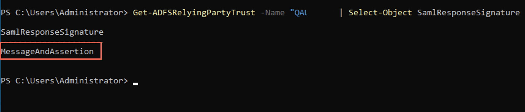

  1. Verify the setting using the following command:
Get-ADFSRelyingPartyTrust -Name "<Display Name>" | Select-Object SamlResponseSignature
The console displays the SAML response signature depending on which configuration successfully worked with your setup.
saml response signature screen
