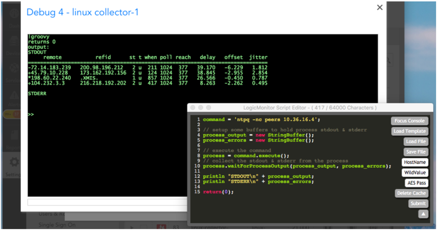

Developing Scripts with the Collector Debug Facility
Before installing your monitoring script into the appropriate LogicModule, you’ll first want to test it to make sure it’s behaving as designed. For an external script, this is straightforward, as you’ll typically develop and test directly on a Collector host by directly calling the appropriate interpreter for your script language.
For embedded Groovy or PowerShell scripts, you can develop and test your scripts directly within LogicMonitor using the Collector Debug Facility. Although you can comprehensively debug with this built-in tool, we strongly recommend augmenting it with the LogicMonitor Script Debug Helper extension for the Google Chrome browser.
Regardless of whether you’re using the Collector Debug Facility or LogicMonitor Script Debug Helper, you’re able to author and debug your Groovy and PowerShell scripts on-the-fly using the !groovy and !posh debug commands.
Either of these commands will launch a text area in which you can write script code, iteratively test your code by submitting it to the Collector’s Groovy/PowerShell script interpreter, and view its output.
Once your code does what you want it to do (e.g. generate DataSource active discovery records or key/value pairs; EventSource JSON; ConfigSource configs; or some other meaningful output), you can copy it into the appropriate LogicModule.
