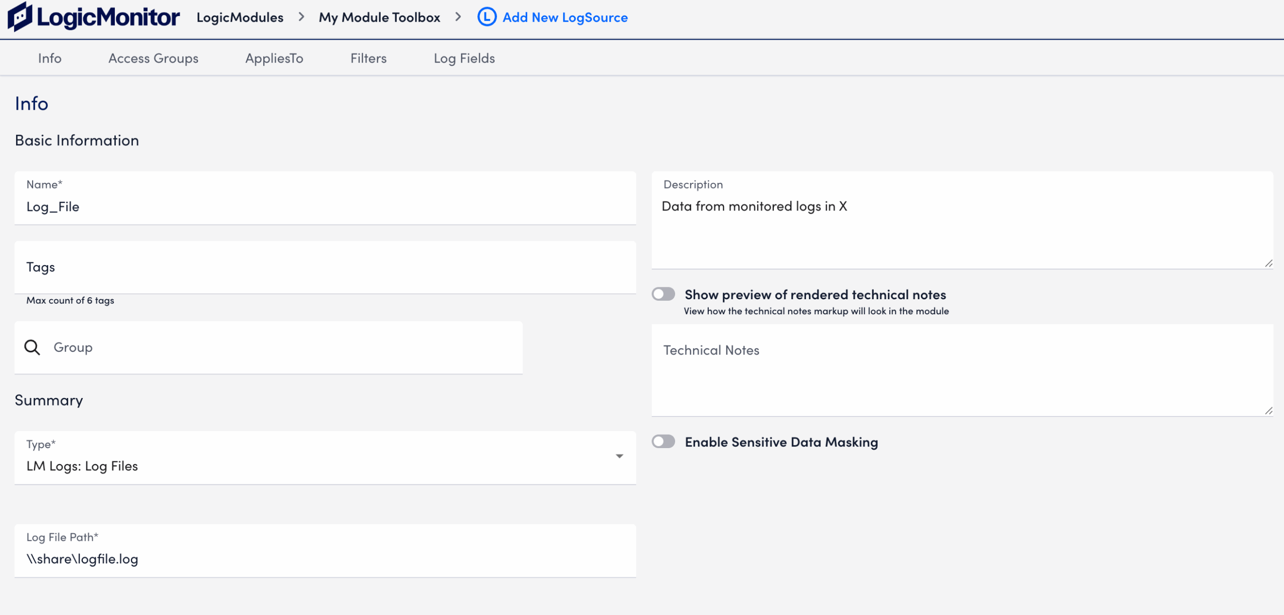

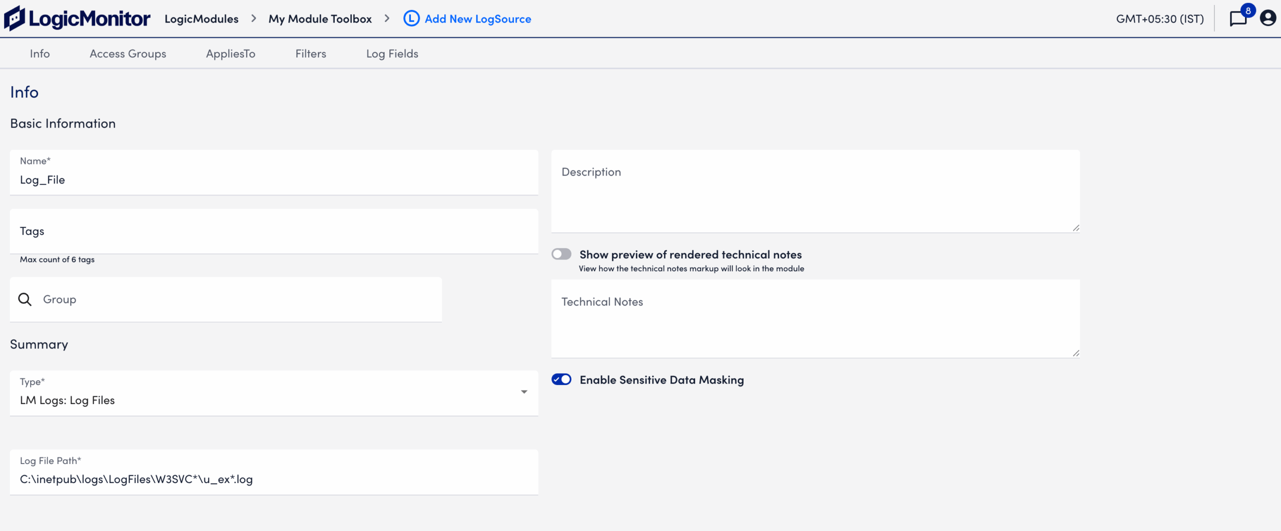

  4. In the Summary for Info section, do the following:
    1. Select “Logs: Log Files“ in the Type dropdown menu.
    2. Provide the path name for the log file in the Log File Path field.
      You can enter one of the following:
      • A single log file path.
        For example:\\share\logfile.log
      • A log file path that uses wildcards to collect multiple log files or rollover log files across directories.
        For example:C:\inetpub\logs\LogFiles\W3SVC*\u_ex*.log
        Add New Logsource Info section
