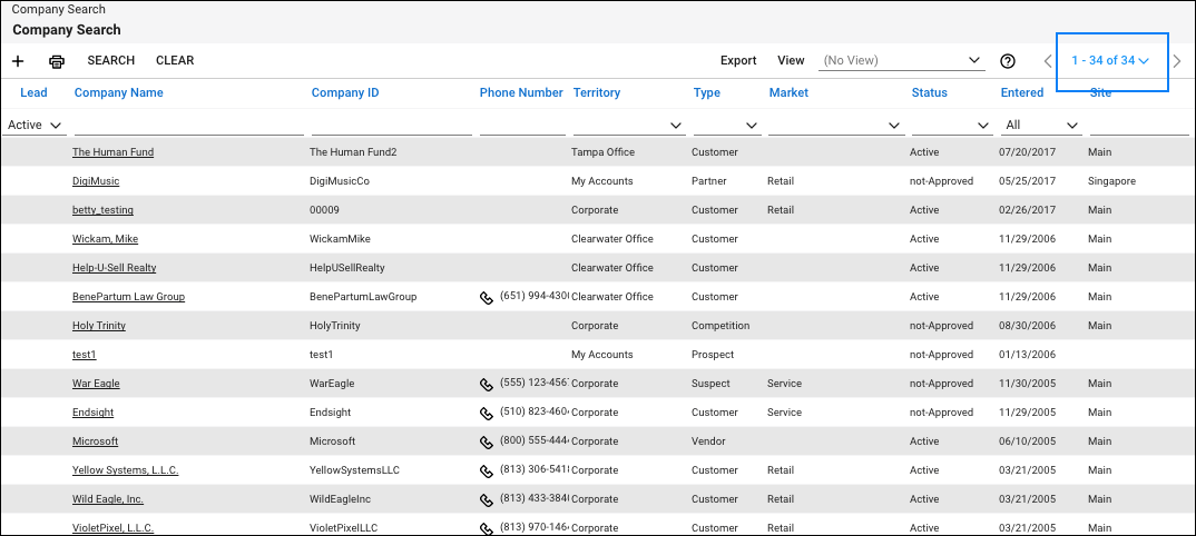

The underlying Company_RecID values associated with companies are often hidden in the ConnectWise interface. There are a couple of methods you can use to expose the Company_RecID, including running a report that includes this value or making this value visible from the company list view. The following set of steps illustrates the latter method:
  1. In ConnectWise, navigate to Companies.
  2. In the top right corner of the company listing, click the down arrow to open the List View Configuration dialog.

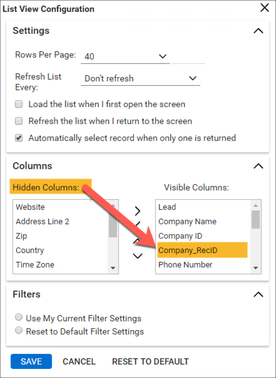

    ConnectWise company dialog
  3. From this dialog, move the Company_RecID from the Hidden Columns box into the Visible Columns box.
    List view configuration dialog box
  4. Select Save and, upon returning to the company listing, you’ll now see the Company_RecID displayed for each company.

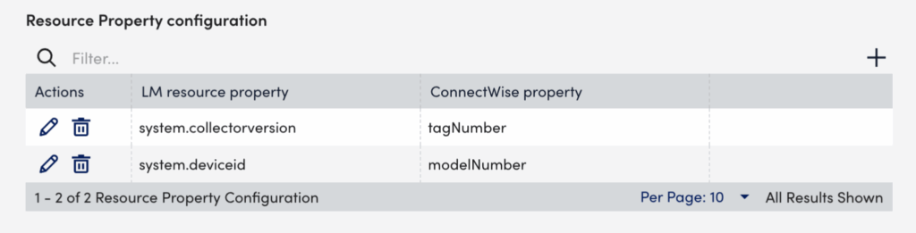

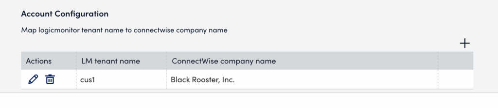

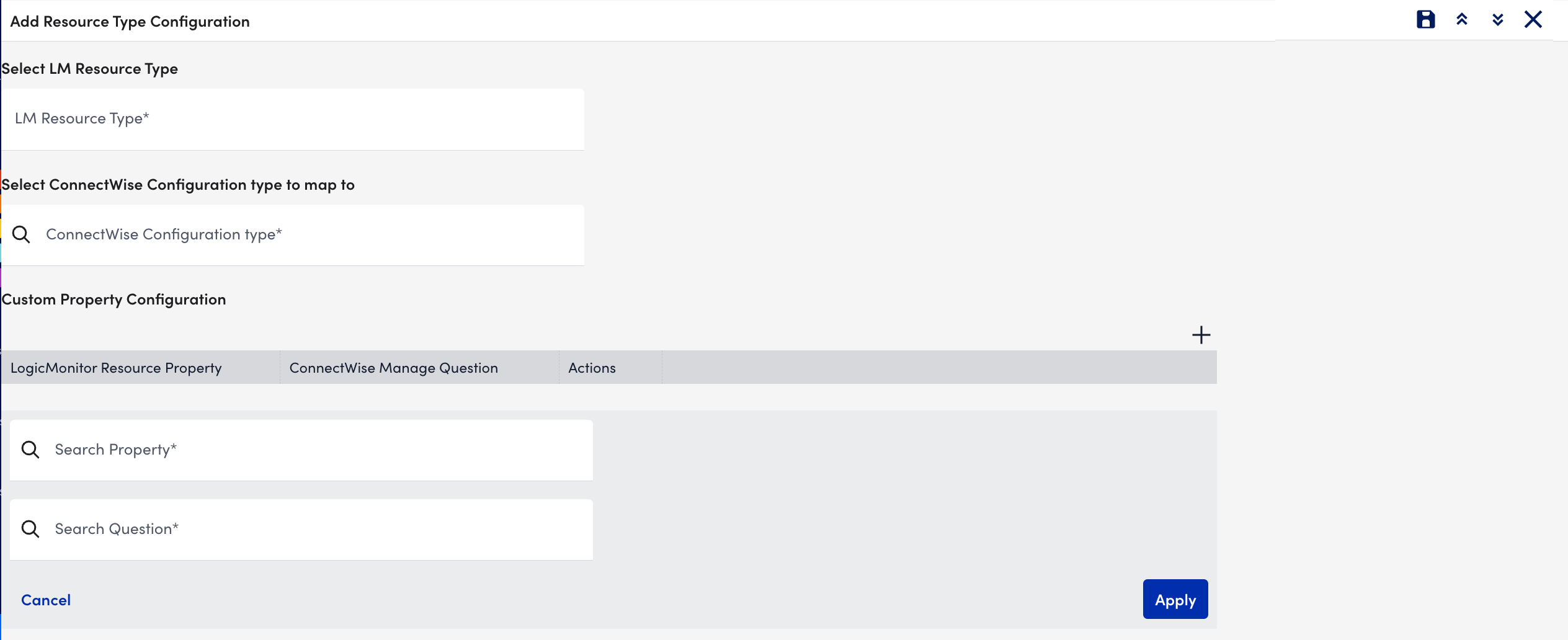

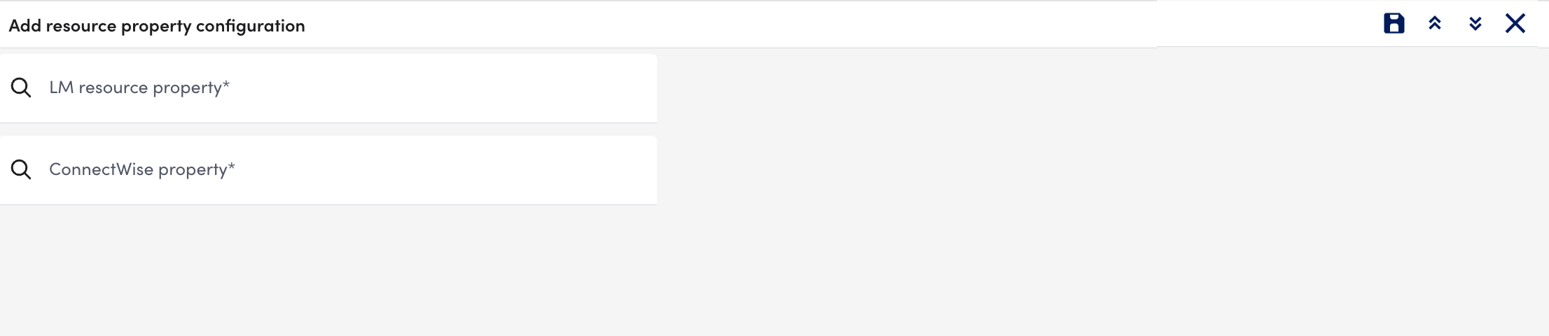

ConnectWise Sync
Use the Configuration Sync feature to create and manage ConnectWise configurations based on LogicMonitor resources.
Note:
  • You can set up the Configuration Sync form for multiple ConnectWise integrations. However, only one ConnectWise integration can have the configuration sync enabled at a time.
  • To save a new ConnectWise integration, you must populate the fields related to the Alerting integration. If you do not plan to configure Alerting, enter acceptable placeholder values and ensure that the integration is not part of any Escalation Chain.
  • Configuration Sync activity is recorded in the Audit Logs on the Settings page. Full sync audit logs are recorded every time. For delta sync, audit logs are recorded only if there are devices to be updated or added.

Use Resource Property Configuration to map the resource properties of devices in LogicMonitor (LM) to corresponding properties in ConnectWise. Resource property mappings correspond to the Configuration Details fields in a ConnectWise configuration.
Note: LogicMonitor resource properties can only be mapped to ConnectWise configuration fields that accept text input. Fields with dropdowns, radio buttons, or other selection types are not supported.
By default, the following properties are automatically mapped:
  • System.displayname → Configuration name
  • System.deviceId → Device identifier
  1. To map a resource property, from the Resource property configuration section, select the Add icon. The Add resource property configuration panel is displayed.
    add resource property configuration panel
  2. In the panel, select the following properties:
    • LM resource property: The key properties tracked by LM for the device type (For example, CPU, Memory, OS Version).
    • ConnectWise property: These properties are the Connectwise Manage Questions that appear in the dropdown menu, allowing you to select the correct options for each device (For example, OS, Device Type, Manufacturer).

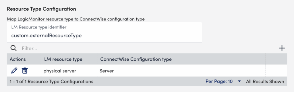

Resource Type Configuration
Use the Resource type configuration to identify the LM device type that is mapped to a specific ConnectWise Configuration Type.
  1. From the Resource Type Configuration section, enter a property for LM Resource type identifier.
  2. To map resource type, select the Add icon. The Add Resource Type configuration panel is displayed.
    Add resource type configuration panel
  3. From Select LM Resource Type, select the LM resource type.
    The type of LM device. This is derived from the LM resource type identifier (for example, system.collectorplatform, system.virtualization).
Note: Resource Type Configuration supports resources under LM Uptime. You can include LM Uptime resources when mapping LogicMonitor resource types to ConnectWise configuration types.
  1. From Select ConnectWise Configuration type to map to, select the ConnectWise configuration type.
    This corresponds to the type of configuration created in ConnectWise, such as Server, Network Device, or Virtual Machine.
  2. Select the Save icon.
Example Configuration:
  • LM Resource Type Identifier: system.collectorplatform
    • Example Values: linux, windows, network
  • Connectwise Configuration Type: Server, Network Device, Virtual Machine, Database
For example:
  • LM devices with system.collectorplatform: linux will be mapped to Server in Connectwise.

Use Custom Property Configuration to add more custom records to the configuration that map additional LM properties to Connectwise Manage Questions. Custom property configurations, defined under Resource Type Mapping in LogicMonitor, correspond to Custom Configuration Questions in the ConnectWise configuration.
To add a custom property mapping do the following:
  1. In the Resource Type Configuration section, select the Add icon. The Add Resource Type Configuration panel is displayed.
  2. From Custom Property Configuration, select the Add icon.
  3. From Search Property, select the custom LM custom property.
  4. From Search Question, select the ConnectWise manage question.
Note: The questions stored in ConnectWise are displayed in the Search Question field.
  1. Select Apply, and then select Save.
Example of custom property configuration:
Custom LM PropertyConnectWise Manage Question
OS VersionSelect Operating System
CPU ArchitectureSelect CPU Architecture
Firmware VersionSelect Firmware Version

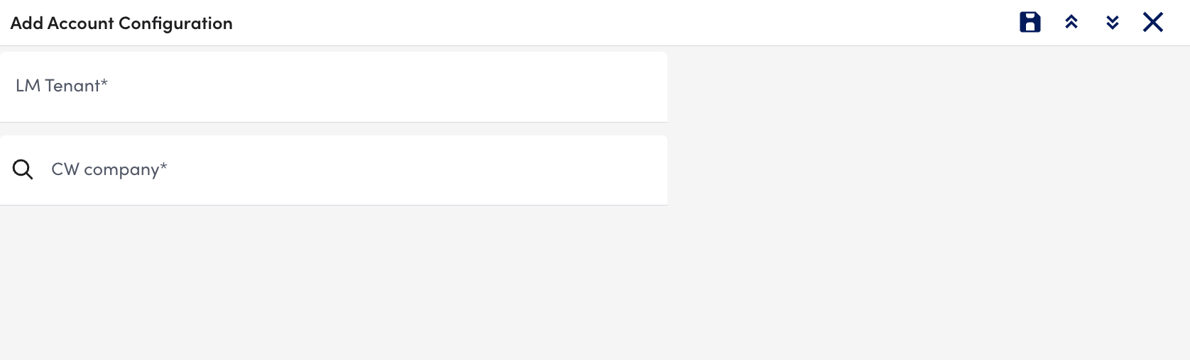

Account Configuration
Use Account Configuration to map LogicMonitor tenants to companies in ConnectWise. This ensures that devices and configurations are correctly assigned to the right company in ConnectWise. For more information on tenant identifier, see Grouping Alerts by Tenant.
  1. To add account configuration, from the Account Configuration section, select the Add icon. The Add Account configuration panel is displayed.
  2. In the LM Tenant field, enter the name of the LogicMonitor tenant.
Note: Enter the tenant name used as the value for the tenant.identifier property in LogicMonitor. If the name is entered incorrectly, account mapping will fail.
  1. From CW company, select the corresponding company name in ConnectWise to map with the tenant in LM. The company names that are stored in ConnectWise are displayed in the CW company field.
Example of tenant and company mapping:
LM Tenant NameConnectWise Company Name
Tenant ACompany A
Tenant BCompany B
Tenant CCompany C
This mapping enables devices created in LM under Tenant A to be associated with Company A in ConnectWise.
