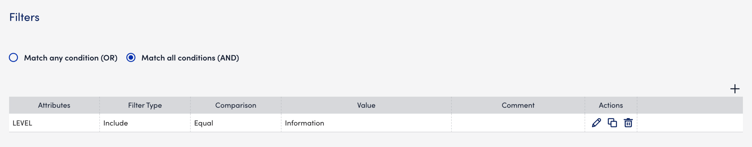

Configuring Filters for LogSource
You can add filters to include or exclude events when configuring a log source. If you add filters, events must meet the filter criteria to be detected and alerted on. Available filtering options depend on the selected LogSource type. You can select an AND or OR operator to apply the filter logic.
Include filters enable you to specify which events are processed. Only events that match the defined criteria are included. Exclude filters enable you to omit specific events from processing, even if they match other criteria.
Note: If no filter is provided, all log events are included by default.

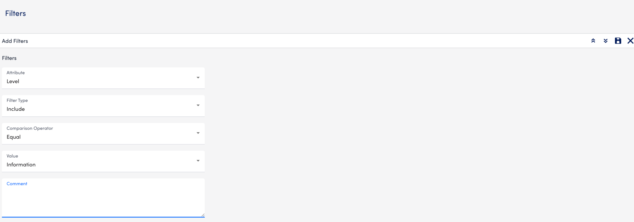

To add Filters, do the following:
  1. Select an AND or OR operator.
  2. Select Add Filters. This opens a modal to add filter details.
  3. Select an option from the Attribute dropdown menu to define the item to filter on. The available options depend on the type of LogSource. For example, select “Level” for a Windows Event Logging type of LogSource.
  4. From the Filter Type dropdown menu, select either Include or Exclude.
  5. Select a comparison operator to define how the attribute value is evaluated in the Comparison Operator. For example, “Equal” matches an exact value, and “RegexMatch” evaluates patterns, depending on the attribute type.
  6. In the Value field, enter a value based on the selected attribute and comparison operator. For example, enter “Warning”.
  7. (Optional) In the Comment field, enter a description.
  8. Select save Save.
    The filter is added and applied based on the defined configuration and selected operator.
    Add Filters Modal
    Add Filters Window
When defining the severity level to be included for incoming log messages, you can include multiple levels specified with a pipe separator. You can also use level numbers such as 1 for error, 2 for warning, and 3 for information.
As you are defining filters, you can select Test AppliesTo to perform test runs to ensure events are filtered and captured as you intended. You can also use the testing capability before any filters are defined in order to return all messages from a device, and use this information to refine parameter values.
