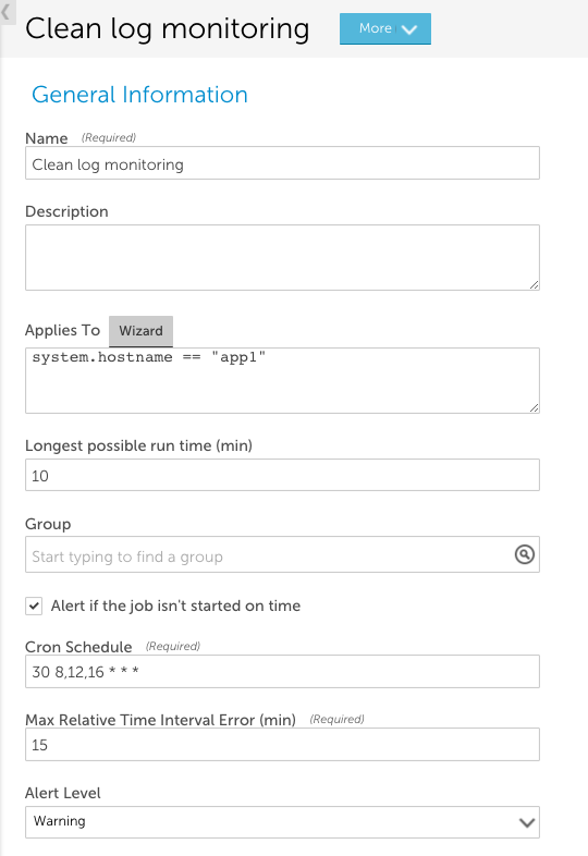

Step 1: Create the JobMonitor definition
The first step of monitoring a Linux cron task is to create a batch job definition via LogicMonitor.
- Log on to your LogicMonitor account.
- Go to Settings | LogicModules | JobMonitors
- Click Add -> JobMonitor
- Edit the JobMonitor definition (see the figure below)
- Click Submit to save the JobMonitor definition
The JobMonitor definition displayed above is associated with device app1, will trigger an alert if the JobMonitor isn’t finished in 10 minutes and will trigger a warning alert if the job starts more than 15 minutes after its scheduled run times of 8:30, 12:30 and 16:30. You should see the JobMonitor associated with the device app1 from the Devices page of your account.
