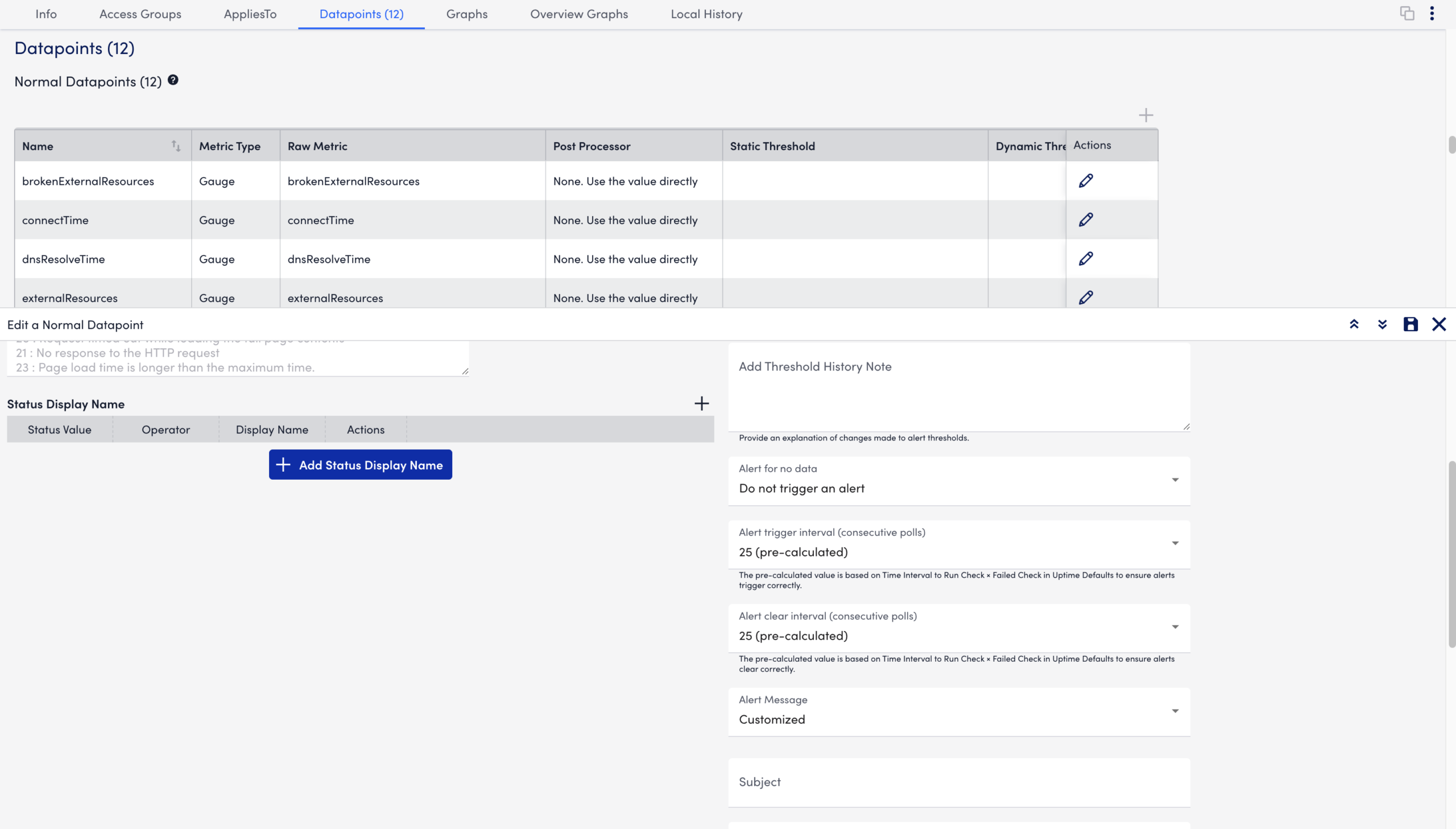

    Do not modify the following DataSource fields. LM Uptime automatically derives these values from Uptime Defaults and LM Uptime alert tuning logic. Manual changes can result in incorrect alert behavior:
  • Collection Schedule
  • Alert Trigger Interval
  • Alert Clear Interval
  • Alert Thresholds

To keep these calculations accurate, LM Uptime DataSources use a 1 minute Collection Schedule. Changing the Collection Schedule or manually overriding the Alert Trigger Interval, Alert Clear Interval, or Alert Thresholds can desynchronize backend alert calculations from configured Uptime Defaults.
