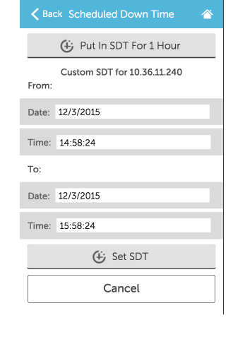

Put in Scheduled Down Time (SDT)
You can select ‘Put in SDT’ to SDT the datasource instance. Choose either the 1 Hour pre-defined SDT or create your own custom SDT duration

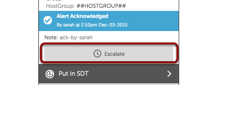

Escalate
Escalate the alert notification to the next person in the escalation chain by clicking ‘Escalate’. Note that there isn’t any confirmation step, the alert will be escalated immediately:
Escalate
