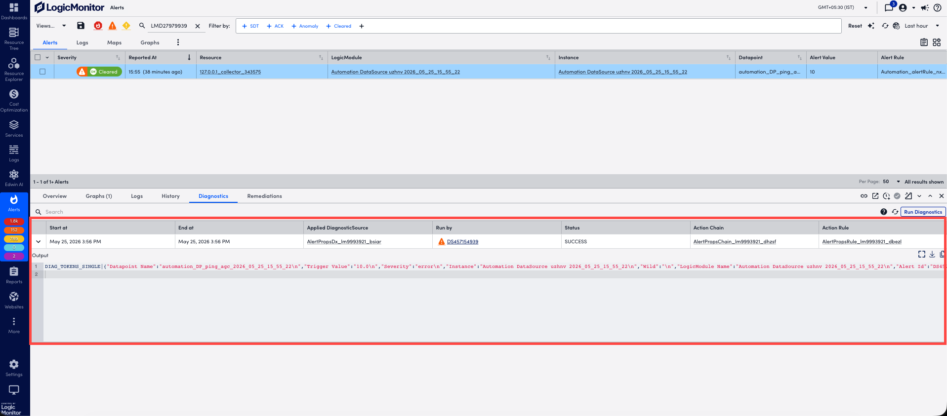

Viewing Automated Run Result of DiagnosticSource on Alerts
  1. In LogicMonitor, navigate to Alerts.
  2. In the Search field, enter a value for alert where the resource has DiagnosticSource applied.
  3. Select the alert and then select the Diagnostics tab.
    A list of the latest executions of each DiagnosticSource run for the past 30 days displays.
  4. Select a record.
    DiagnosticSource run output
    You can view the following details:
    • Date and time when the DiagnosticSource run started and ended
    • Name of the applied DiagnosticSource
    • Alert ID that triggered automated run of DiagnosticSource
    • Recent run status
    • Name of the Action rule and Action chain
    • Output details
    • Option to view output in fullscreen mode, download, and copy the output
  5. You can select Refresh icon Refresh to view the latest run output.

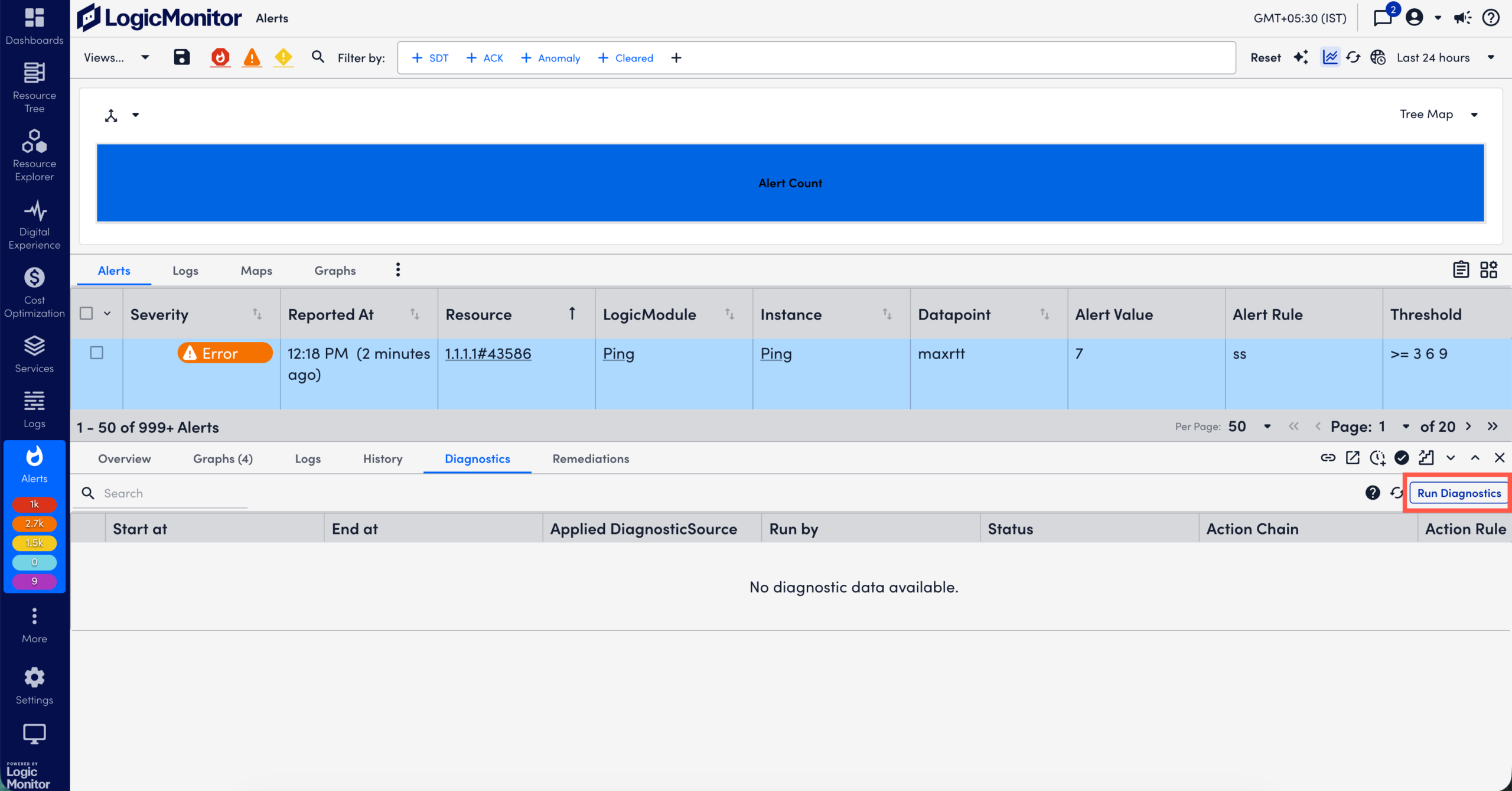

Manually Running DiagnosticSource on Alerts
  4. Select Run Diagnostics.

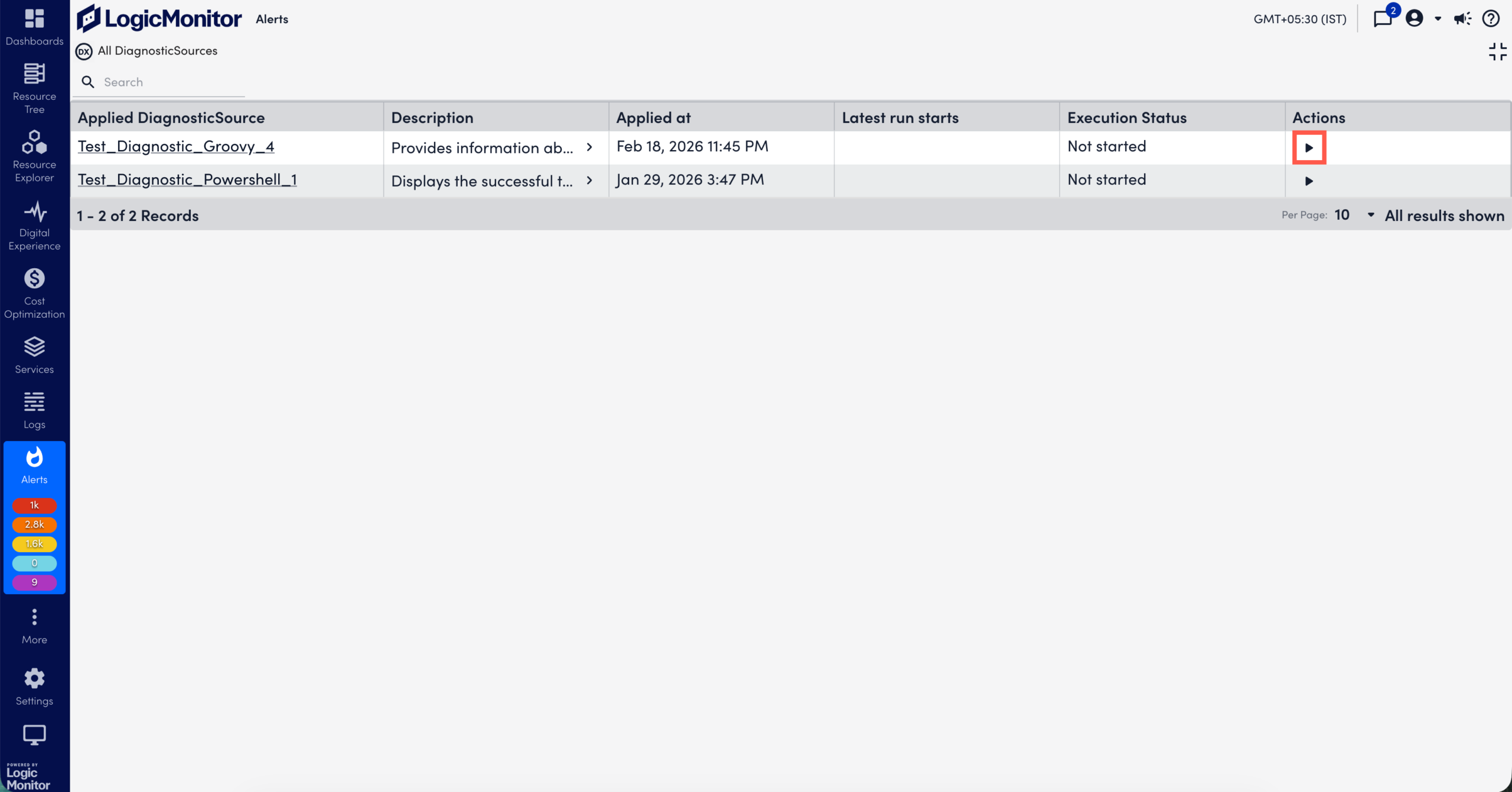

    On a new page, a table with a list of all the DiagnosticSources applied to the resource displays.
  5. In the Actions column, select Run RemediationSource icon Run for the DiagnosticSource that you want to run.
    All DiagnosticSources for impacted resource

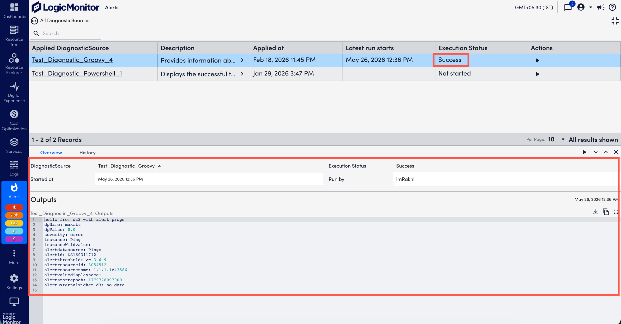

    The system runs the DiagnosticSource and updates the execution status as In Progress.
    When the process is complete, you can view the latest output in the Overview tab.
    DiagnosticSource run output in Overview tab
    By default, the Overview tab displays the following details:
    • Name of the DiagnosticSource
    • Recent execution status
    • Date and time when the DiagnosticSource execution started and ended
    • Username of the user who triggered the running of DiagnosticSource
    • Output details

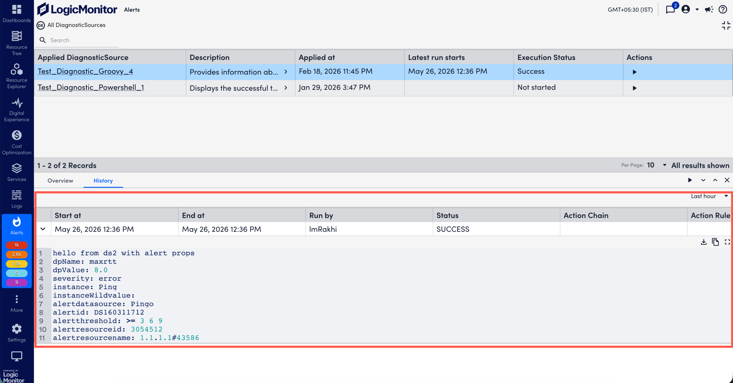

  6. Select the History tab.
  7. (Optional) Select a time range.
  8. Select a record to view the run history for the resource.
    DiagnosticSource run output in History tab
