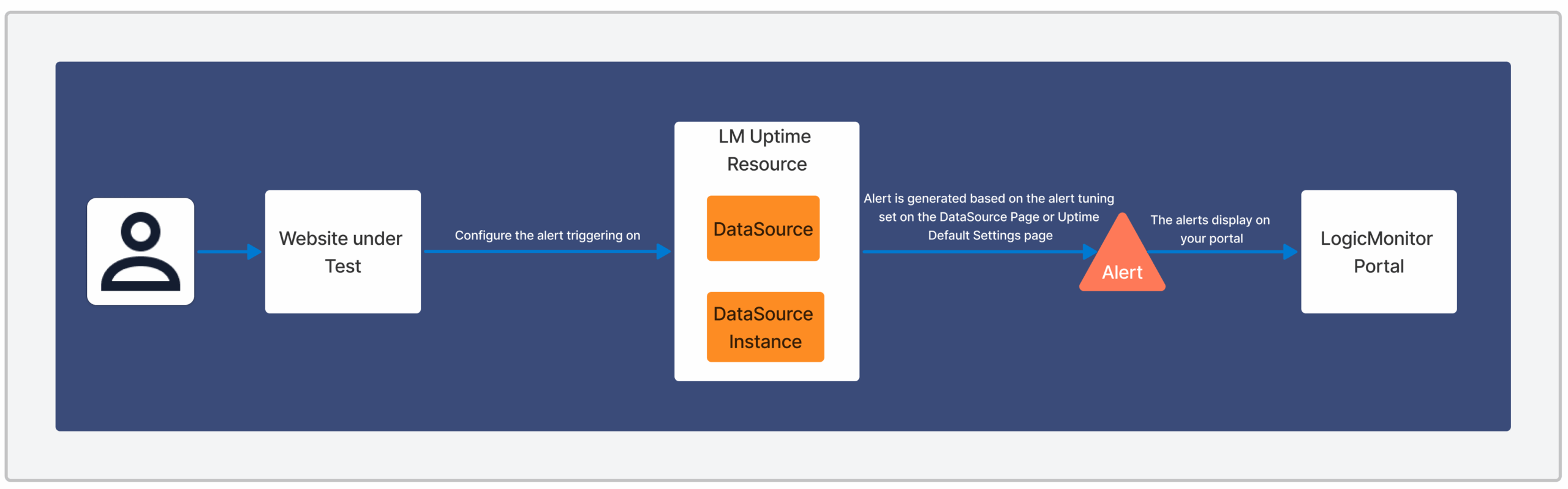

LogicMonitor raises alerts on the LM Uptime resource when a specified number of checks fail at one or more locations. These alert conditions are configured individually for each website during the setup or management of a Web Check or Ping Check. The way alerts are triggered depends on the type of check and whether it originates from an external checkpoint or an internal LM Collector. For more information on the setup, see Web Check Overview using LM Uptime or Ping Check Overview using LM Uptime.

LM Uptime uses a polling-based alert transition model to determine when alerts trigger and clear for Web Check and Ping Check resources. The Failed Check value in Uptime Defaults determines how many consecutive failed polling intervals must occur before an alert triggers or clears.
The following formula describes the effective transition calculation:
Effective Transition = Polling Interval × Failed Check
For example, a 5-minute polling interval and a Failed Check value of 4 create an effective transition value of 20 minutes. In this example, the alert triggers only after four consecutive failed polling intervals. The same polling-based transition logic also controls alert clear behavior.
To keep these calculations accurate, LM Uptime DataSources use a 1 minute Collection Schedule. Changing the Collection Schedule or manually overriding the Alert Trigger Interval, Alert Clear Interval, or Alert Thresholds can desynchronize backend alert calculations from configured Uptime Defaults.
