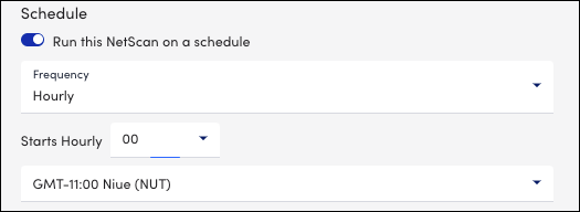

  6. On the Manage NetScans page, enable Run this NetScan on a schedule.
  7. In the Schedule section, enter the following details:
    • Frequency – Select the required frequency from the drop-down list.
    • Starts Hourly – Select the required time for running the scans from the drop-down list.
    • Timezone – Select the required timezone.
      Schedule option for NetScans page
  8. Select Save and Run.

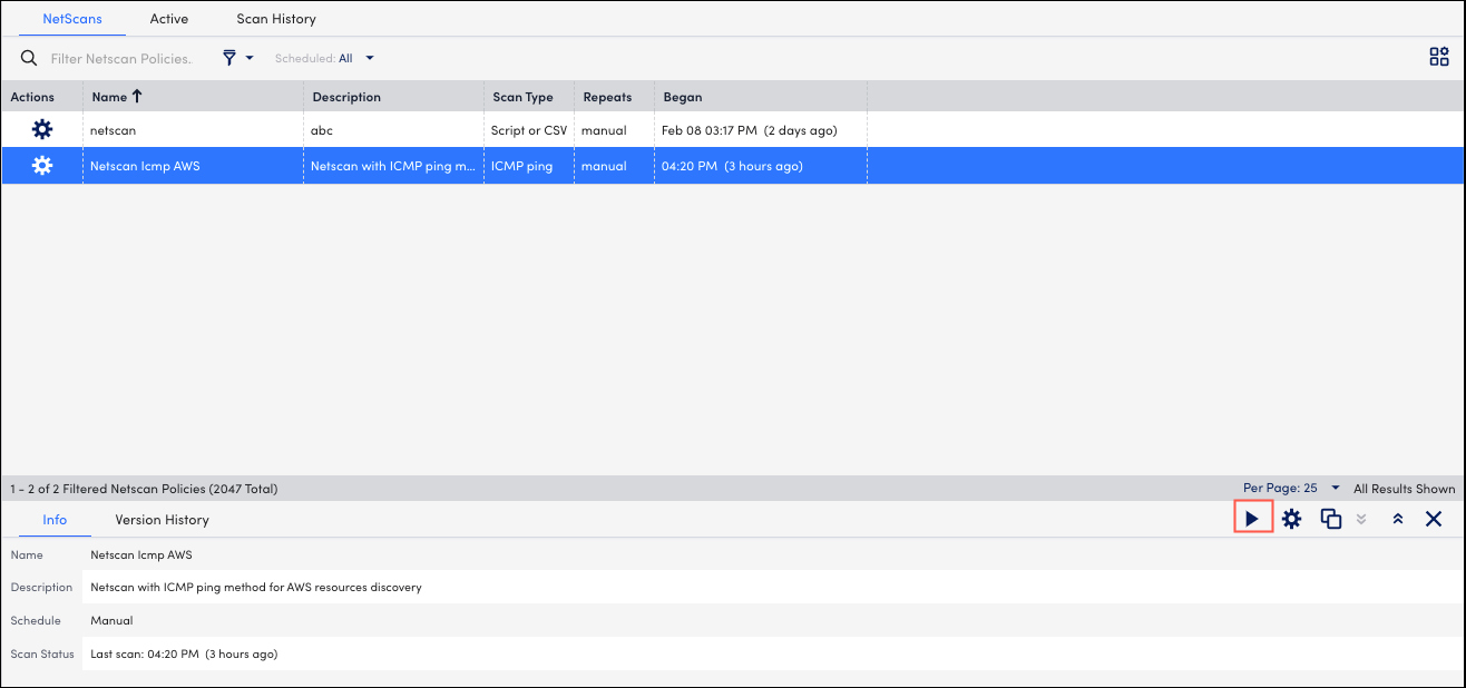

  1. In LogicMonitor, navigate to Settings > NetScans > All NetScans.
  2. Select the required NetScan.
  3. On the NetScans page, select the NetScans tab.
  4. On the NetScan tab, select the required NetScan.
    A panel is displayed with Info and Version History tabs.
  5. In the right corner, select Start/Stop NetScans.
    The Scan Status bar displays the progress of the scan.

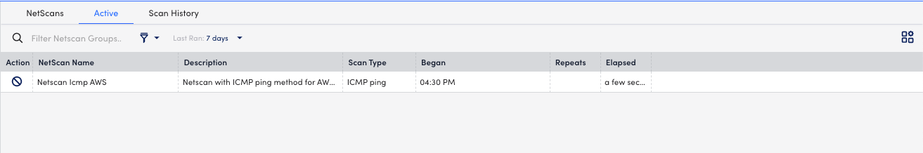

  1. To see if the manual Netscan is active, select the Active tab.
    NetScans active bar
